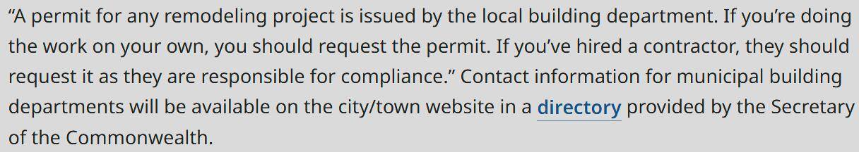

Yes, homeowners can pull permits for building work, but for any electrical, plumbing, gas work, only licensed people can apply for an obtain permits for this work.
Can you show me in the law where it says this? Because I am seeing otherwise.
See, this is the thing about MA laws and regs. They are intentionally vague. The law states that permits can only be pulled by licensed persons, but it does not specifically say that homeowners cannot do their own work if a permit is obtained. Additionally, prior approval must be obtained by the wiring inspector for the homeowner to do the work themselves. Additionally, the liability for the work will fall on the person with the license who pulled the permit, so though “technically” a homeowner can do the work if they somehow convince an electrician to let them do the work themselves under the permit that the electrician applies for, good luck finding an electrician that will put their locense on the line for work they dont do.
