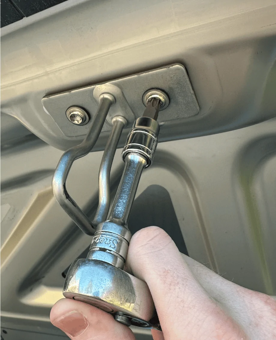

Got about 600 miles on my AWD CT. Noticed the other day that my latch was very loose. The bolts had backed out and I had about 1/8th-3/16ths of play between the bracket and hood.
Easy fix with a T45 torx... just wanted to throw it out there for yall to check next time you're in your frunk.
If I see them back out again, I'll consider some blue locktite

In case someone needs to know, 15 Nm / 11.1 lbs ft torque for those torx bolts as per Service Manual - link.
