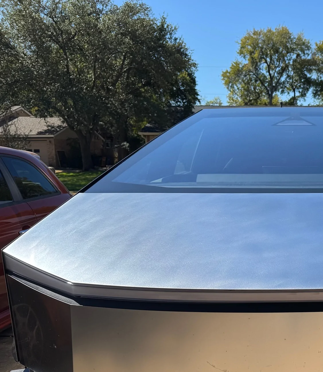

It’s challenging to photograph a reflective surface, but this shows the stripes:
Tesla Cybertruck Cleaning routines you recommend? IMG_1564
It looked perfect with the sun behind me, so it seems to be an inconsistent orientation of the scratch pattern. I resolved it with repeated passes at the higher (~800) grit and in different directions.
are you using wet sand paper?
you can get it with over 2000 grit
or hit it with a buffer with some rouge.
I guess at some point it may look like a mirror cool for a car show bad for other drivers
It looks pretty good to me. I see what you were referring to with the lawnmower lines. Mine has areas like that too though and its factory but similar that you can only see it in different lights and angles.

I used abrasive pads (similar to a ScotchBrite pad) as called out in Tesla's Cybertruck Refinishing Guide. I couldn't find a true 5mm random-orbital that was not professional-grade (with a commensurate price) so I winged it with a DA polisher.
I was worried about taking too many passes and polishing it into a mirror lol, but the 800-grit pad maintained a factory-approximate finish. I even tried it with a polishing compound to smooth it out, but all that did was make a mess.
The problem wasn't the level of grit, it was the direction of the scratches; they're supposed to be in all directions with a random pattern so that the surface appears uniform from any direction.
I think I wasn't using enough downward pressure at first. The DA polisher will turn into a grinder if allowed to spin freely. PRO TIP: Never start the buffer before placing it on the work surface, ask me how I know :LOL:
If I were actually going to refinish the entire truck, I'd bite the bullet and buy the pricey random-orbit polisher. Using the wrong tool for a job rarely saves money, and never saves time or effort.
