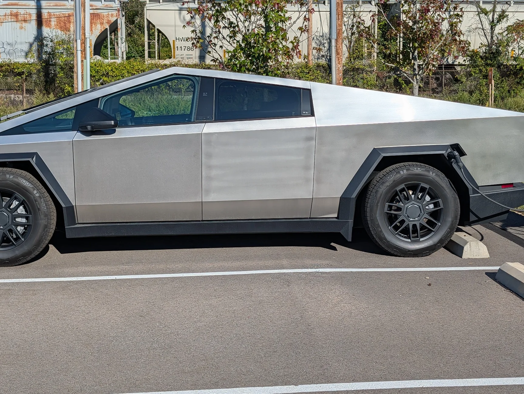

I guess this exact sander for my repair. Driver's side is OEM, passenger side is my work after an unfortunate motorcycle accident (he merged into me as I was passing in the left lane) 😔.
Definitely could do better and probably will in the spring/summer. It's miles better than the butchered driver's side rear door that the truck was delivered to me with 🫣

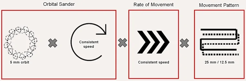

Tesla calls out a specific pattern:
Tesla Cybertruck Cleaning routines you recommend? GUID-1B7F8959-5D5A-4D27-BC07-E4563134E9F6-online-en-US
The 5mm orbit seems to require a specific tool; my buffer merely describes itself as "elliptical".
The "Movement Pattern" in the diagram suggests advancing by 25mm (~1 inch), which I did, but I don't understand the notation "25 mm / 12.5 mm". Dealer's choice? Or "25MM except in California"??!?
The horizontal (ish) surface of the frunk lid made it easy to maintain constant speed and pressure, but I performed dozens and dozens of passes with varied parameters and yet the striping remained. I had to deviate from the process via cross-hatching to eliminate it.
The Tesla procedure definitely assumes some level of proficiency of the operator, as they give only general guidance (e.g., "Continue to sand until the finish is consistent"). I sanded a single panel for three goddamn days lol.

Correct, with an 8/2025 build date fresh off the truck. Not sure if the SC did some touchups, but what I'm showing you is how I received it 🤷‍♂️. Honestly I didn't notice it until a few weeks after delivery. Now that I can refinish the exterior on my own, I don't feel like wasting my time at an SC to have it potentially fixed or potentially made worse.
