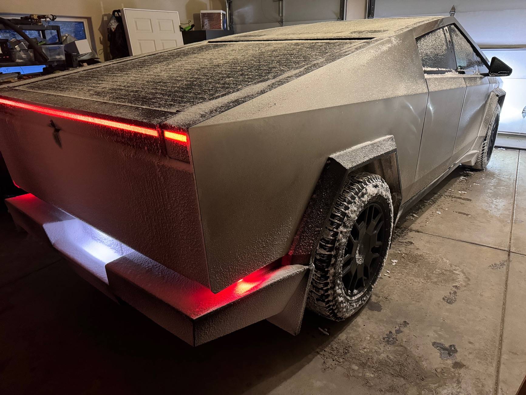

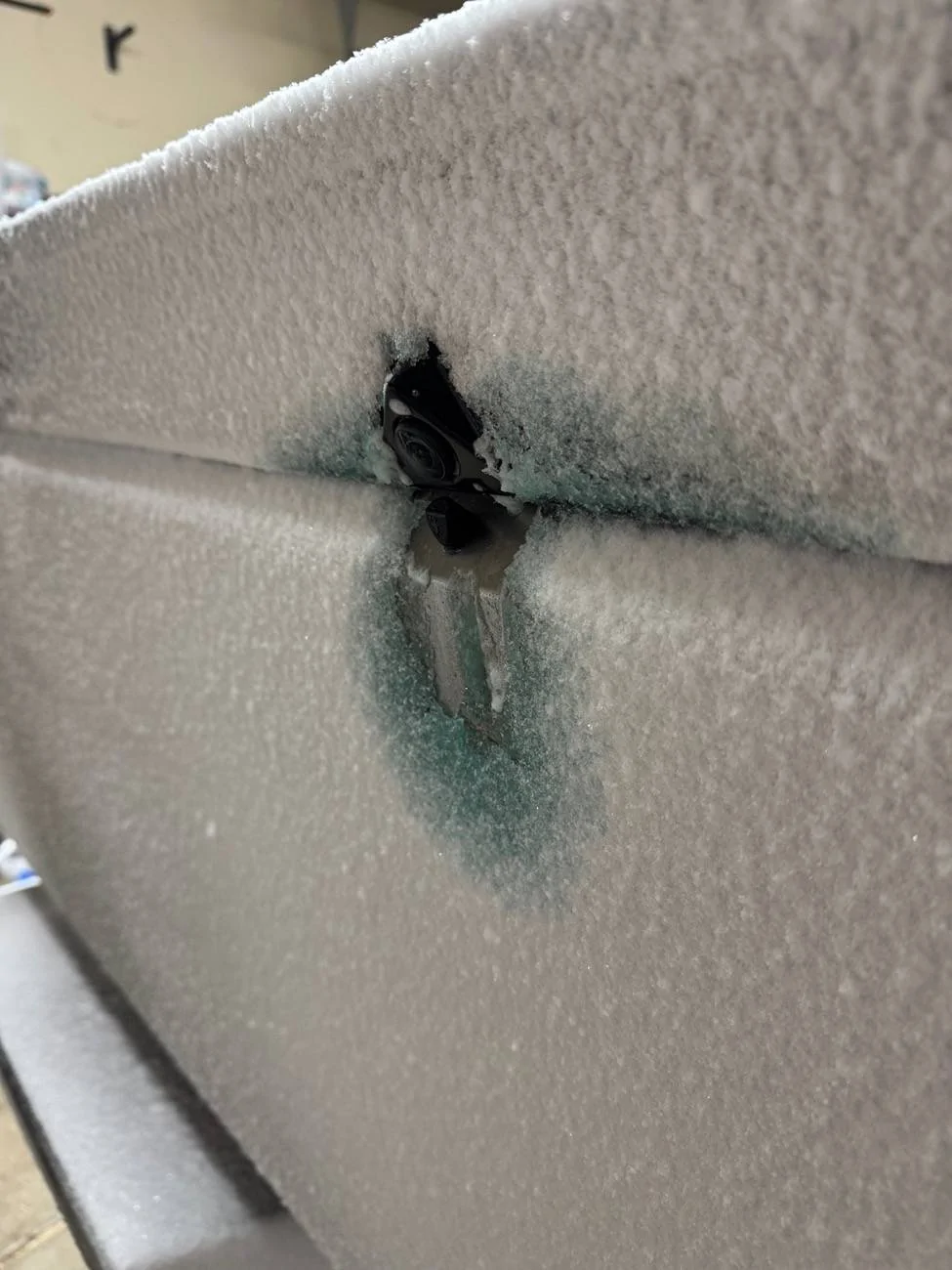

I have the clearvue rear camera sprayer installed and it’s awesome for snow.
It took just over 3 hours to install, it just tees off the front camera sprayer. To activate it you just spray the front camera and you get a mostly clean rear camera too.
I have noticed that if I do a hard acceleration the rear camera sprayer will leak a bit afterwards and there will be some fluid on the tailgate. Not a big deal, just an observation.
Tesla Cybertruck Clearvue rear camera sprayer is awesome for snow IMG_7510
Tesla Cybertruck Clearvue rear camera sprayer is awesome for snow IMG_7508

Could solve that acceleration leak by installing a check ball with a light spring. I would guess the front sprayer has a similar check valve or the fluid would just leak out by capillary action!
