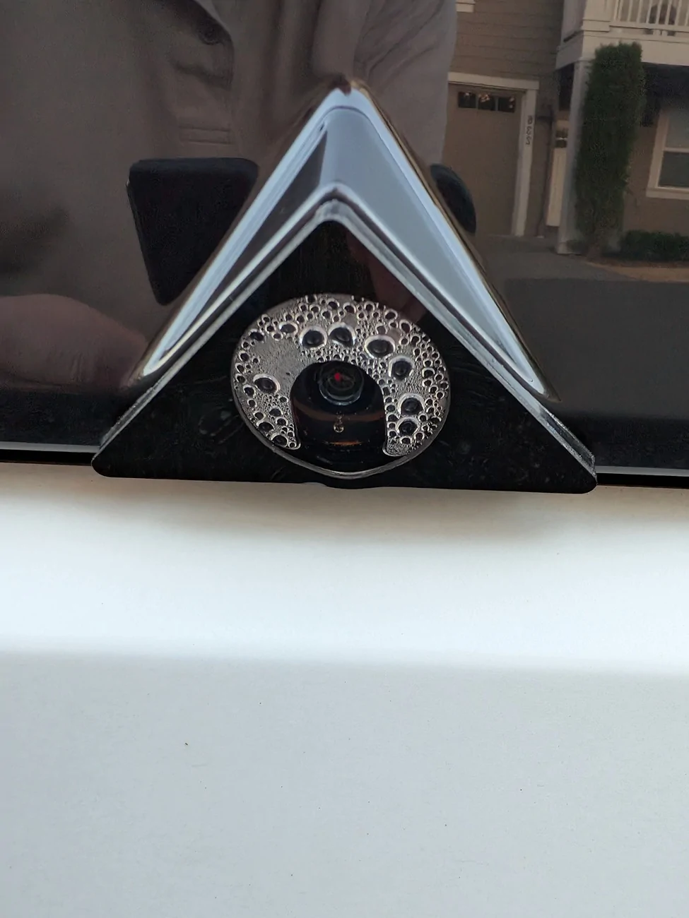

Is anyone else having issues with the V2 version of the rear camera cover by @AO-Pete? It works great but has a weekness at the bottom where it starts to lift and allow moisture in. My last two covers have both done this and had to be removed after the first car wash (even though I am careful). The V1 cover never did this even though it cropped some of the image.

It's a night / day difference in areas where it rains - like Seattle. I love the cover. Just bummed they aren't surviving a careful wash. The cropped image of the V1 didn't bother me because I use the rear view image zoomed to 1.0x.

I’ve had these and faced similar problems with moisture on the inside of the lens. When that happens It blocks or obscures the camera which is what it’s trying to prevent. I’ve chatted with Pete about these and they are trying to come up with a solution. My opinion, the cover has two areas where the adhesive area is very thin and it just can’t hold up. There are no vents to allow air flow for moisture removal. I love the idea but for CT, these need more work.

I had the exact same issue. I ended up having to tear it off and now there is adhesive residue all around the camera. I'll need to buy some adhesive remover to get it off. I also loved the cover, but unfortunately if it can't survive a wash then it's pointless.

I had mine (V1) on during last winter and, while it works, it's amazing. I ordered a V2, but am waiting for rainy season before installing it. V1 lasted for about 3 months, including going through a handful of pressure washes. Maybe I just got lucky, I don't know.
One thing, though - you can't wipe them like you would the camera lens. If you try to clean it with your thumb or T-shirt or whatever, you just ruined it. The hydrophobic coating on them is fragile.

I have had a V2 on my CT for many months now. Been through lots of rainstorms. No issues yet.

I tried a couple of treatments like RainX and AquaPel prior to getting the Abstract Ocean cover. Granted, they were not ceramic coatings but they didn't make any measurable improvement like the cover does. My covers have never developed moisture from rain, only from washing. With the V1, it got blasted with the hose with no problem. When I tried the same with the first V2, it was ruined. After that, with the second V2, I was very careful not to hit it with the hose but it got moisture in it only from a light touch from a soapy wash mitt. Upon inspection, I can see it lifting at the bottom and I think heat/sunlight causes warping leading to water ingress.

The problem is that it fills with water if you put the tailgate down after a car wash or a rainstorm. The gap around the camera must be continuous with something inside that gets water in it from above.
