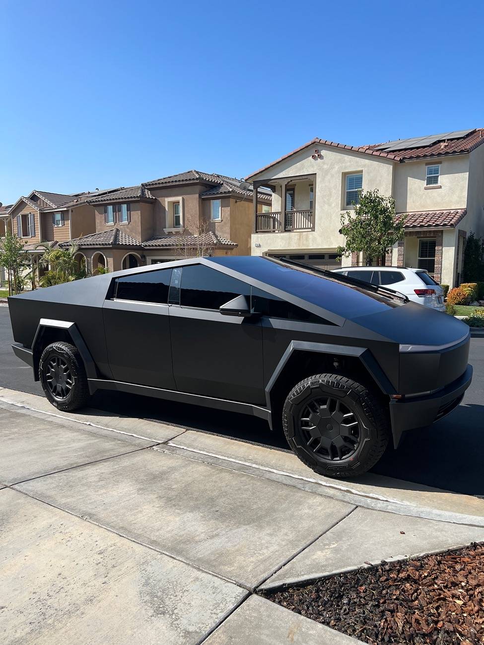

I’ll try to attach a video but for now… does anyone else experience a “clicking” noise when the ac is turned on? I tried to search the forum but haven’t found anything? I think on Reddit someone said the clicking was “within spec” but don’t know if it was a joke or not. Any info is much appreciated! (Cybertruck posted for fun)
Tesla Cybertruck Clicking noise when AC turns on? IMG_7782

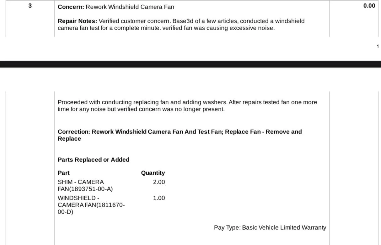

Fyi for those with the fan issue
Tesla Cybertruck Clicking noise when AC turns on? IMG_0886
