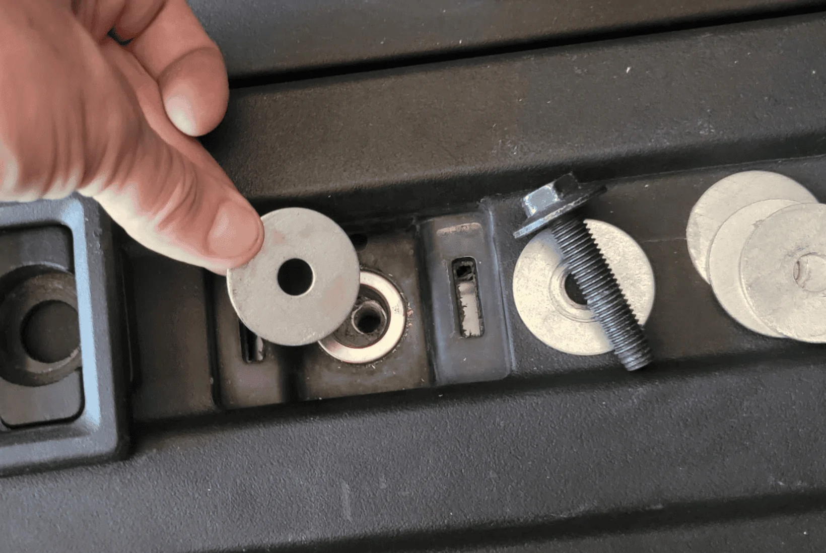

  • The D rings in the bed to attach your straps to have hinges that are incredibly tight to move.
I had this same problem. Was caused by the hinge pressing against the liner. Simple fix was adding a 3/8" i.d. fender washer under the problematic D-rings.
