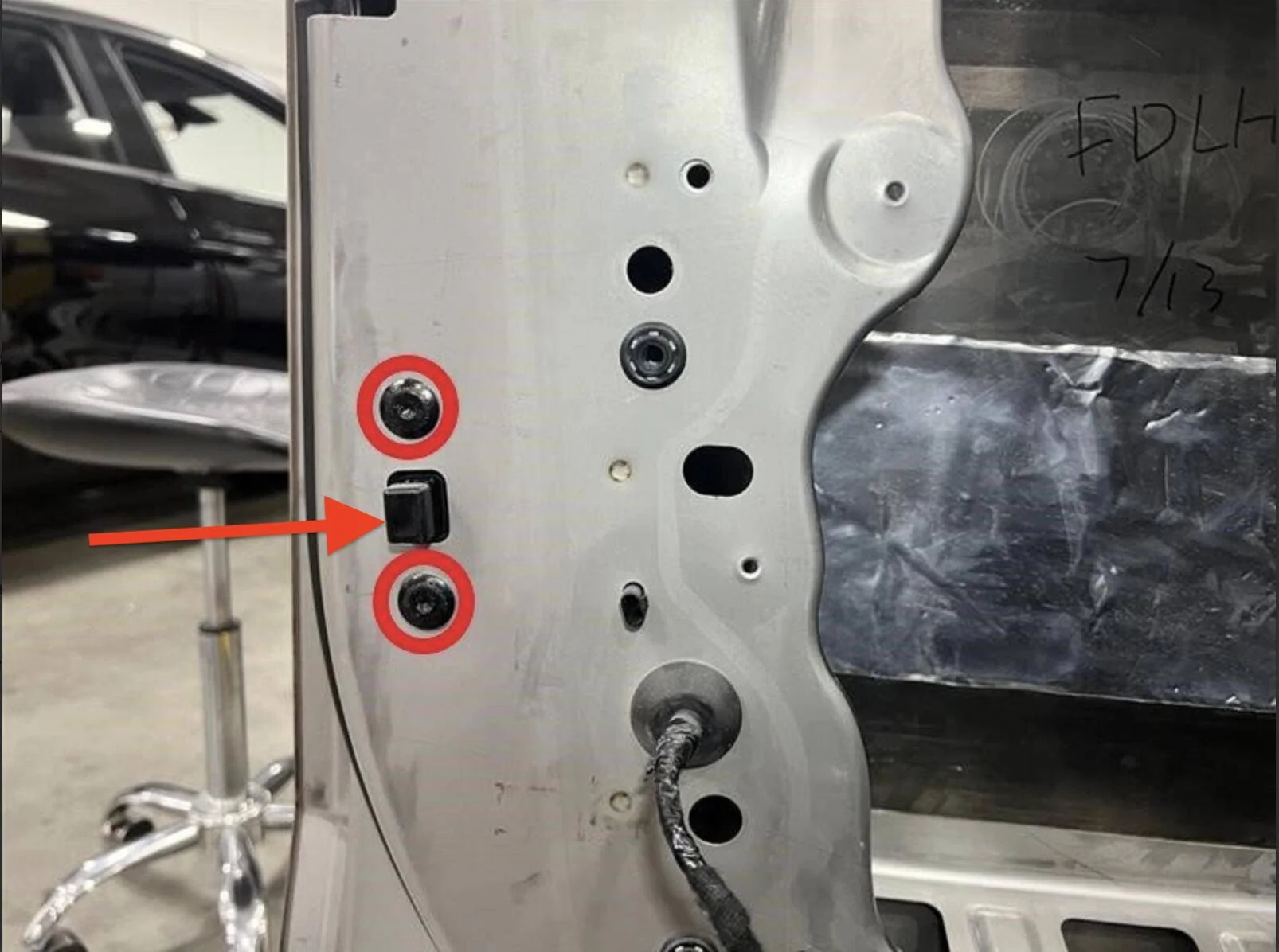

Whenever I accelerate or decelerate in my Cybertruck, I hear a creaking or knocking sound coming from the rear right passenger side. It also happens occasionally when turning or driving over speed bumps or potholes.
I’ve already checked the door latch—it’s not loose. I’ve also experimented with disabling the child lock and window lock, and tried adjusting the window (fully down, halfway, and even a quarter down), but the sound persists.
Any idea what this could be?
I’ve posted a video with this, hope the audio is clean.

I had the same issue. I took it in and it was some loose trim inside the vehicle. Easy fix for the service center.

If you can hear it outside the vehicle it's probably loose bolts in the underbody sheilding. I had the same issue and found multiple loose bolts. Believe there is a service doc related to this as well.
