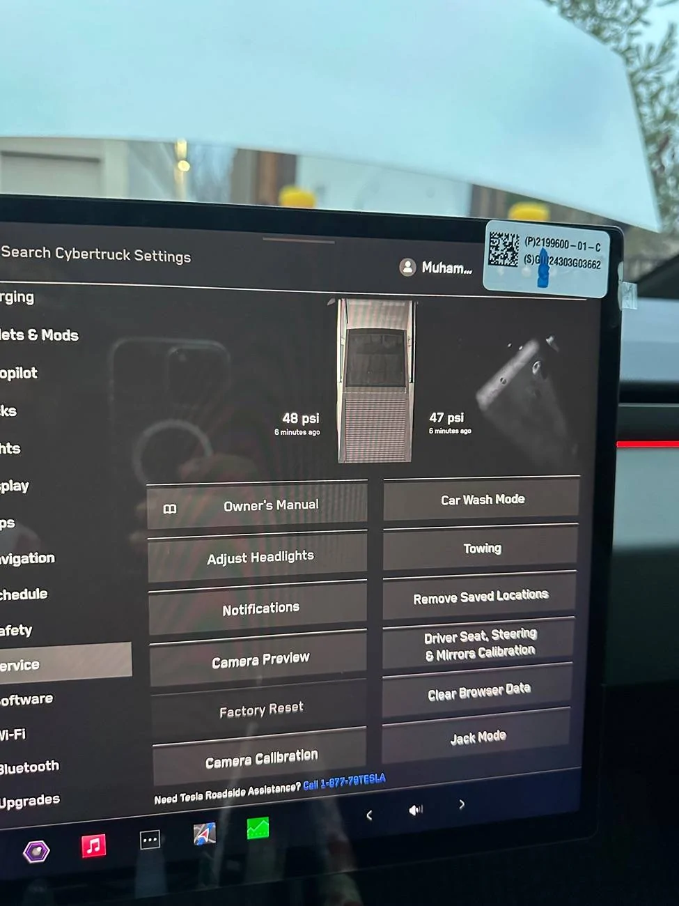

Quick update
Based on some of the feedback and tips. I think I found a fix!
A few other users in this forum suggested to turn off / remove saved locations. Within this option, there is one for ride height.
I’ve turned this off and removed saved ride height. So far this has stopped the air compressor from running.
Basically this prevents the car from pumping in air to the compressor based on the GPS location.
So far we’ve got a success and it’s been silent!
I noticed that on previous routes where I’ve gotta drive over a few speed bumps. The system recognizes this and adjusts the ride height to this. I do this one particular route 2 times in the morning and 2 more in the afternoon for basically (school drop offs and school pickups).
Now after turning off the GPS location ride height feature, it’s been back to normal and silent…
