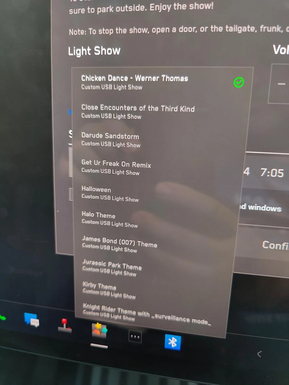

I'm at a carshow today and went to play some of my custom light shows (Really wanted to play my HALO ones!) only to find that they don't show up in the drop down list. We took the usb drive out and plugged it into 2 other Teslas, 1 Cybertruck and 1 model Y and it showed up and played in both. Then we brought another usb stick from the model Y owner that has his custom shows on it and plugged it into my Cybertruck and nothing showed up, just the default built in shows like the Arrival, Carol of the Bells and Old Ange Syne. We've rebooted multiple times and still nothing. I'm on the latest .9 release as was the other Cybertruck owner, the only difference between our truck is that his is AWD and mine is a Beast but I have a hard time believing that should be the issue. The dash cam and security cam features of my truck work just fine and the USB sticks show power to them as they have mini led lights that show activity/power. That makes me believe my USB port in the glovebox is working just fine, but that suddenly, for whatever reason, my Cybertruck no longer wants to show custom lightshows from any USB source I plug in to try. Custom light shows showed up as recently as last week and yes, I did add the .9 update a few days ago, but again the other Cybertruck owner was also on the same software version as I am.
Bug? Gremlins? Thoughts?
