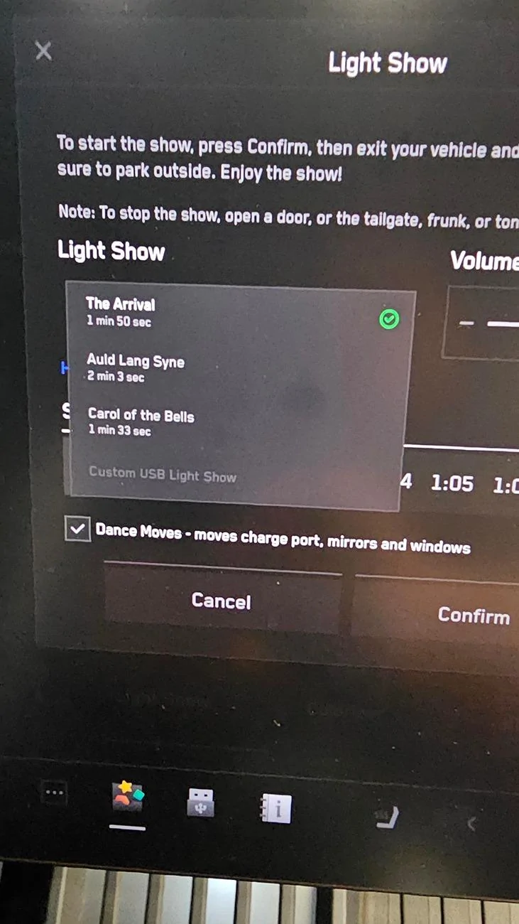

Here is the same USB drive in the Model 3:

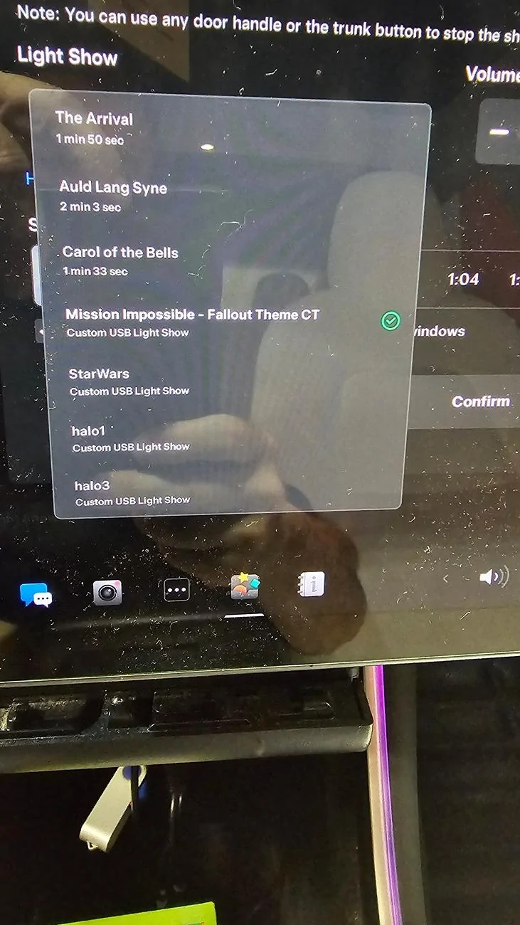

Here is the same USB drive in the Cybertruck:

Exact same USB, different results. The Cybertruck has a menu option for USB music and the Model 3 seems to not have the capability as I could not find that option or icon anywhere.
Something is certainly amiss, but I don't think it is anything I can fix. I logged a call to the 1-800 support number today and of course they have a service visit scheduled for me on September 2nd. ?
BTW you can see the USB icon at the bottom of the second image.
