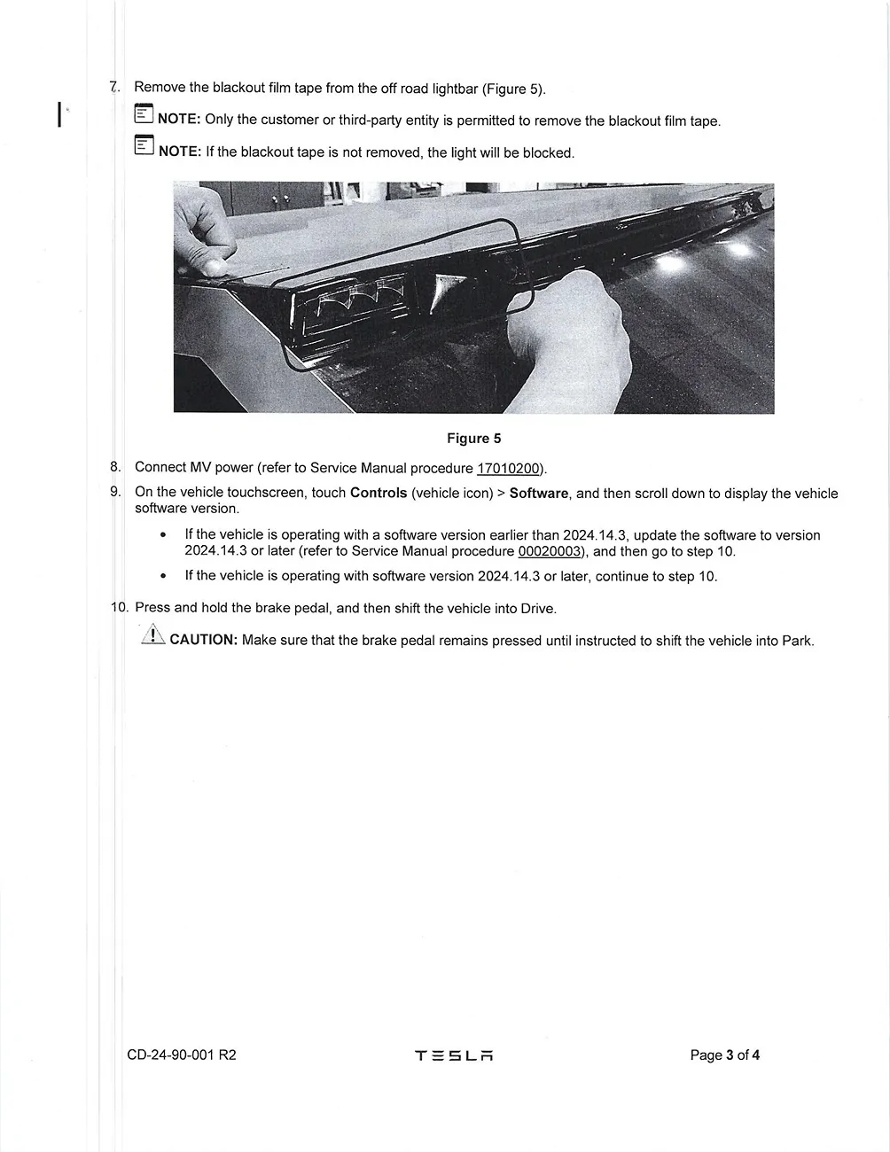

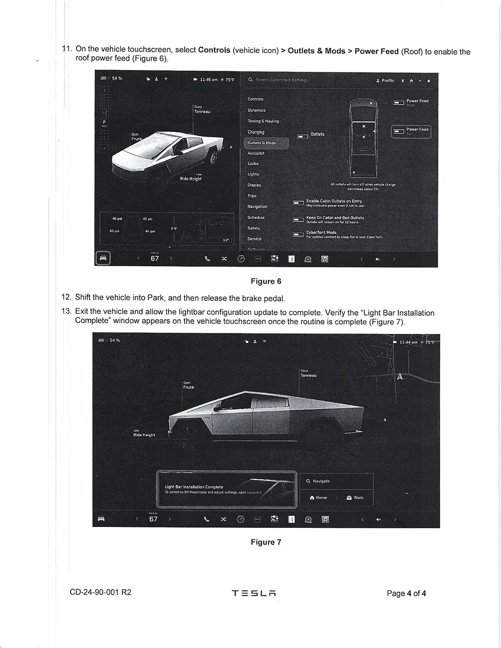

I dropped off CyberBeast for lightbar install on August 20, 2025 at 8:30 am. Wasn't completed until August 22nd at 4:00 pm. Rep made it seem that it was service center specific. I live in Brevard County in FL.
YouTube videos didn't match what I had to do to connect lightbar. In fact I used the YouTube videos to try to connect my lightbar. I was getting frustrated lightbar still wouldn't work. Then I actually pulled out the four page instructions service center gave me and success.
Here are the steps YouTube video's didn't mention:
  1. I did NOT disconnect MV power as discussed in instructions below
  2. ONLY had to connect jumper harness to off road lightbar harness under right side B-pillar (did NOT have to connect any wires on roof as some other CT owners had to)
  3. Get in and make sure all doors shut
  4. Press & hold brake pedal, then shift into Drive (keep pressed until further notice)
  5. On touchscreen, touch Controls > Outlets & Mods > Power Feed (place ON)
  6. Shift into Park, and release brake pedal
  7. Exit vehicle and allow lightbar configuration update to complete (Doesn't mention how long. I waited a few minutes before reentering)
Boom, done!

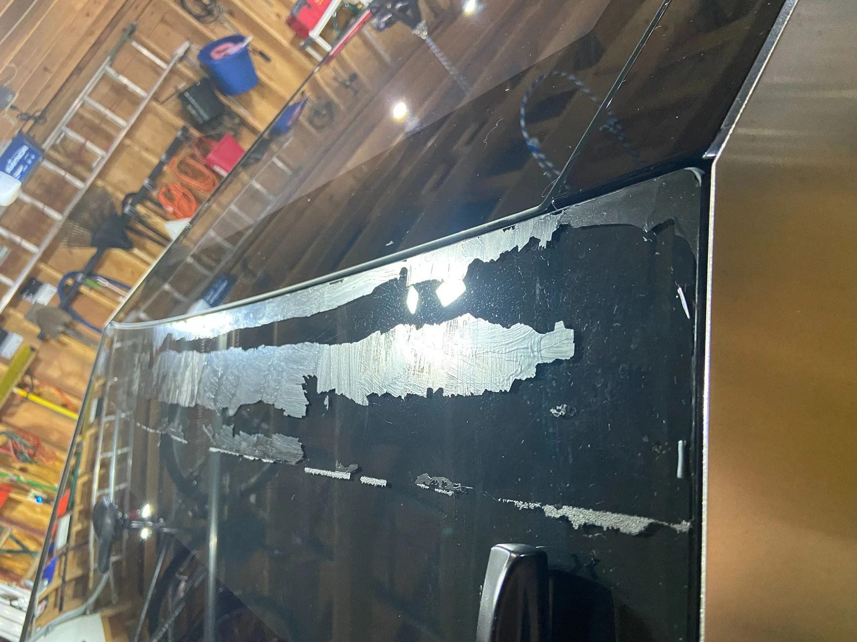

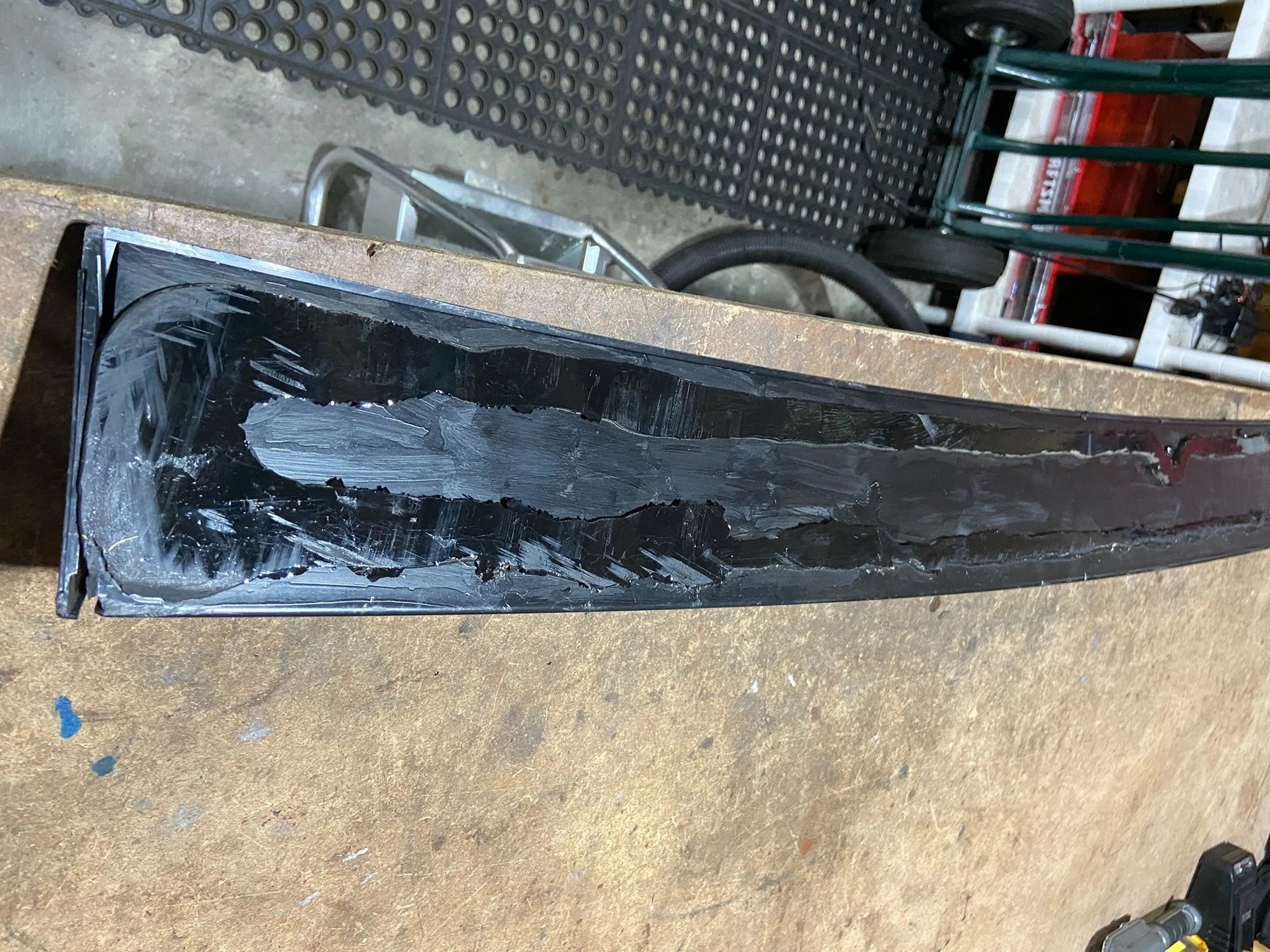

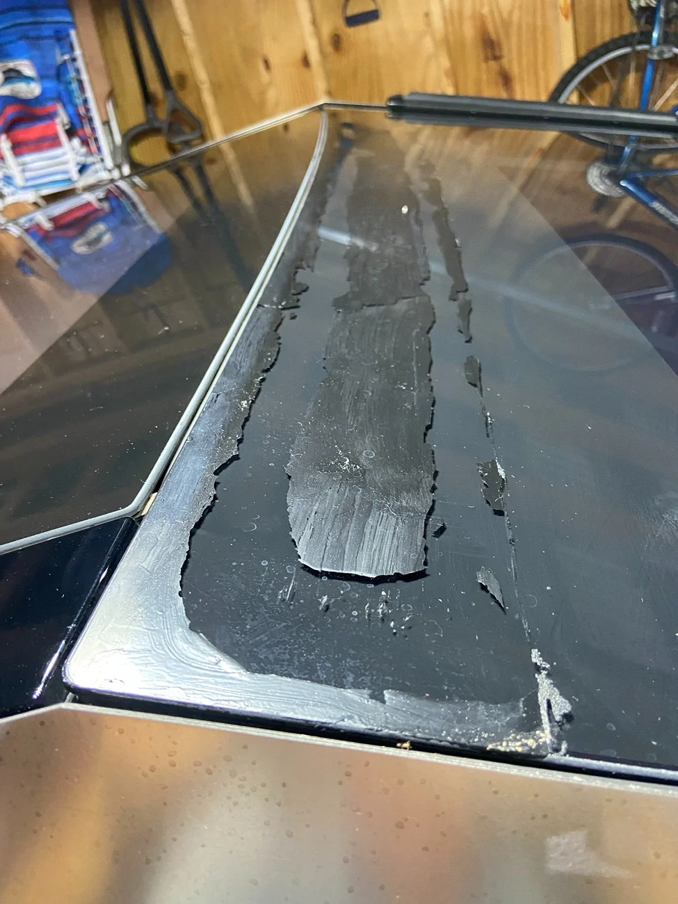

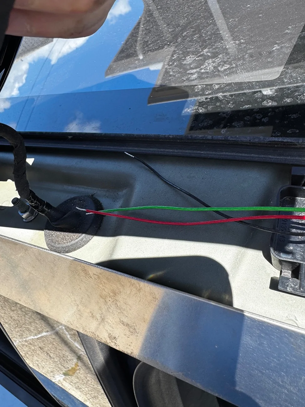

Be careful, mine fell off after a couple of months, while on a highway trip. Mine had a thick (1/2 ") bead that came apart in the bead itself with glue still on the window and light bar base.
The installation looks like a hack job. Very sloppily done by someone who has little skill in this area.
The adhesive I see in the picture could be automotive urethane. I do believe an OEM quality windshield urethane adhesive correctly done could possibly work in this situation. Can’t overemphasize the word correctly. Historically, most OEM windshields have been successfully installed using Betaseal U-400HV or more currently, U-400HMNC. They bond very well to glass and metal surfaces. Both types require a primer on all bonding surfaces. There are some caveats, as not all substrates are compatible with urethane. Some plastics and rubber components do not bond well long term with urethane. Stick for a few months and then boom, the part detaches. Your installation could be the result of a compatibility issue or a poor install. Different expansion coefficients between the substrates can also be a problem. Also, direct exposure to ultraviolet light will break down urethane.
A possible alternative would be a 3M automotive double sided tape. As with the urethane, it needs to be done correctly. For success you would need to use a 3M adhesion promoter on clean and dry surfaces and preferably warm surfaces. If you use tape, I would recommend a dry install. Get it where you want it and then install some alignment markers to make it easier to install it where you want it.
