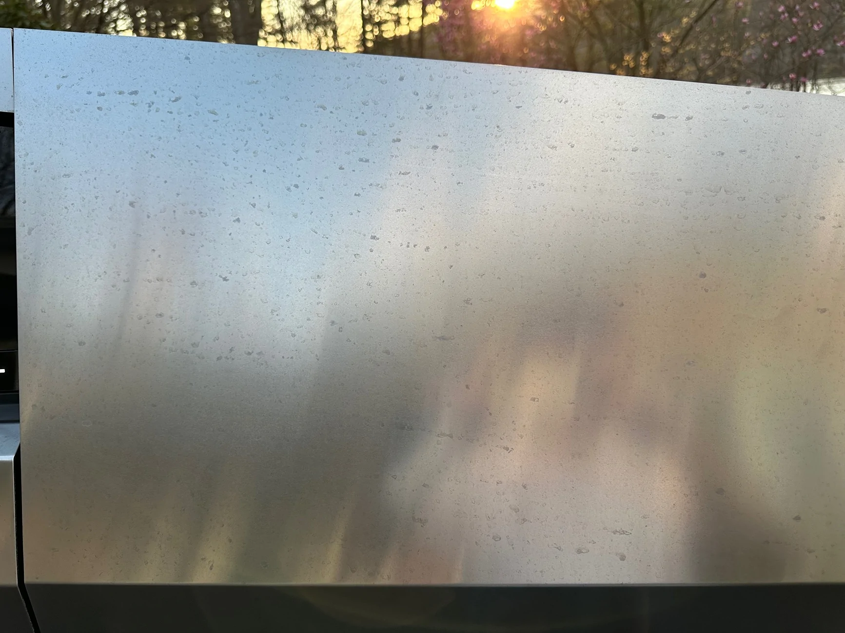

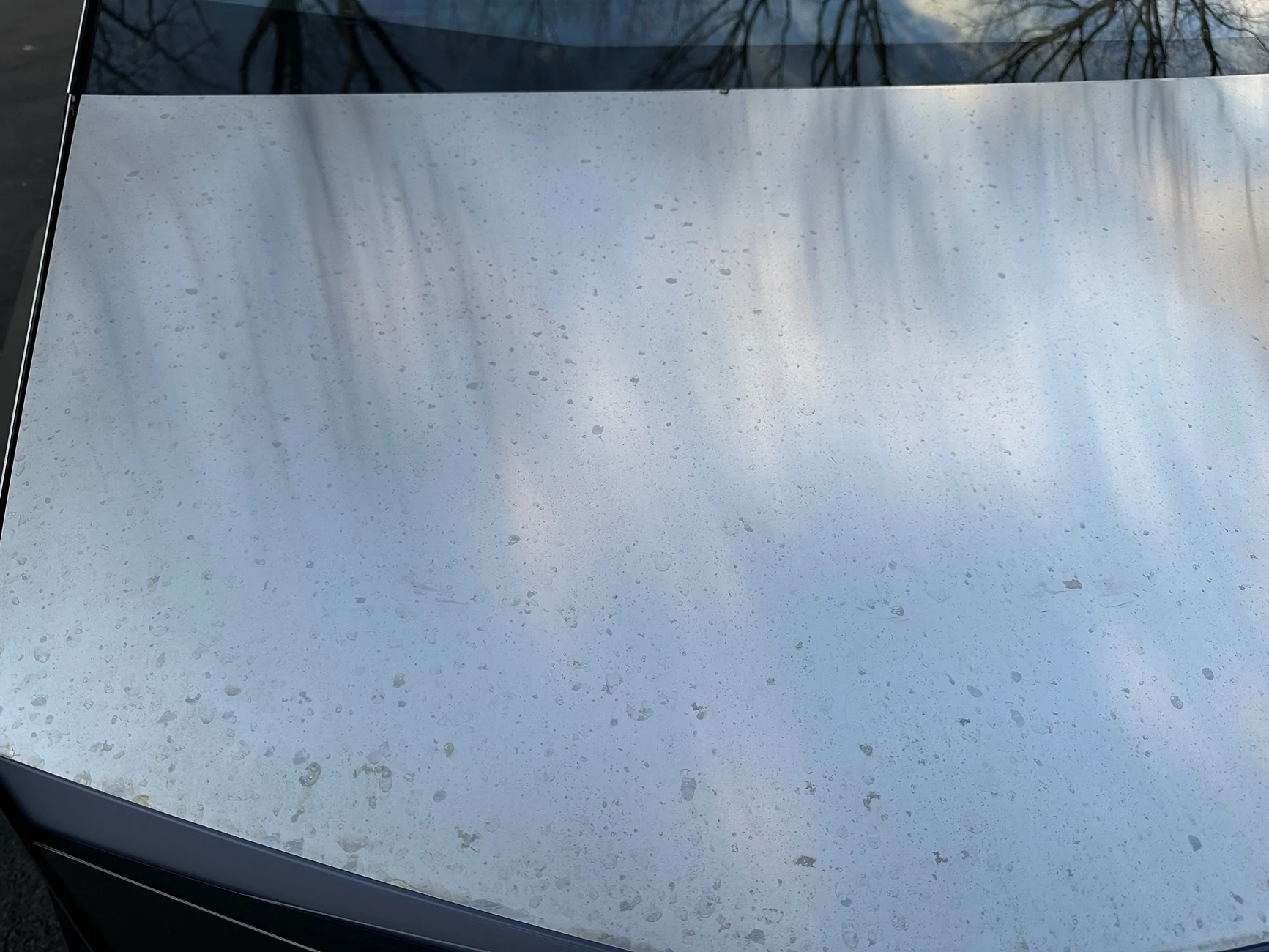

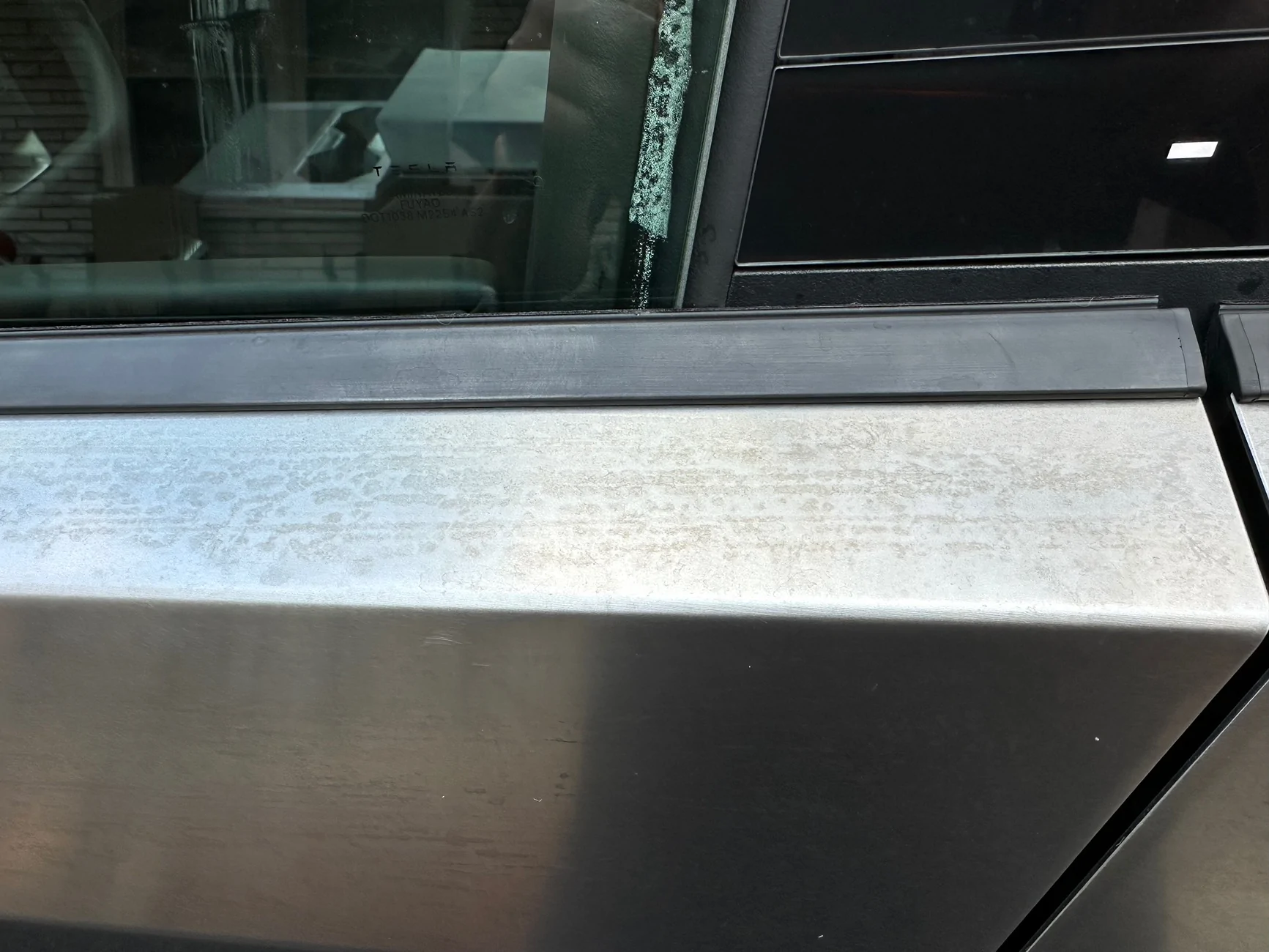

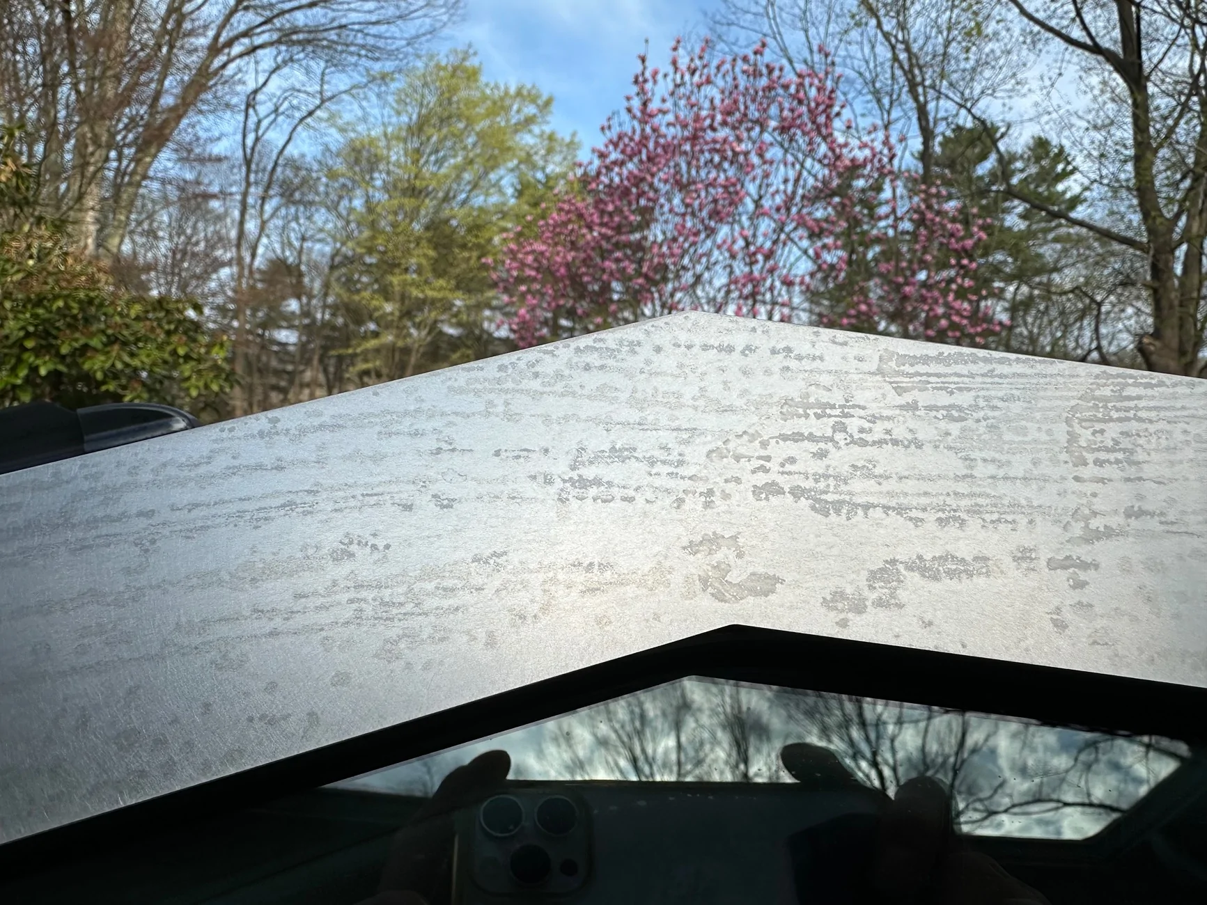

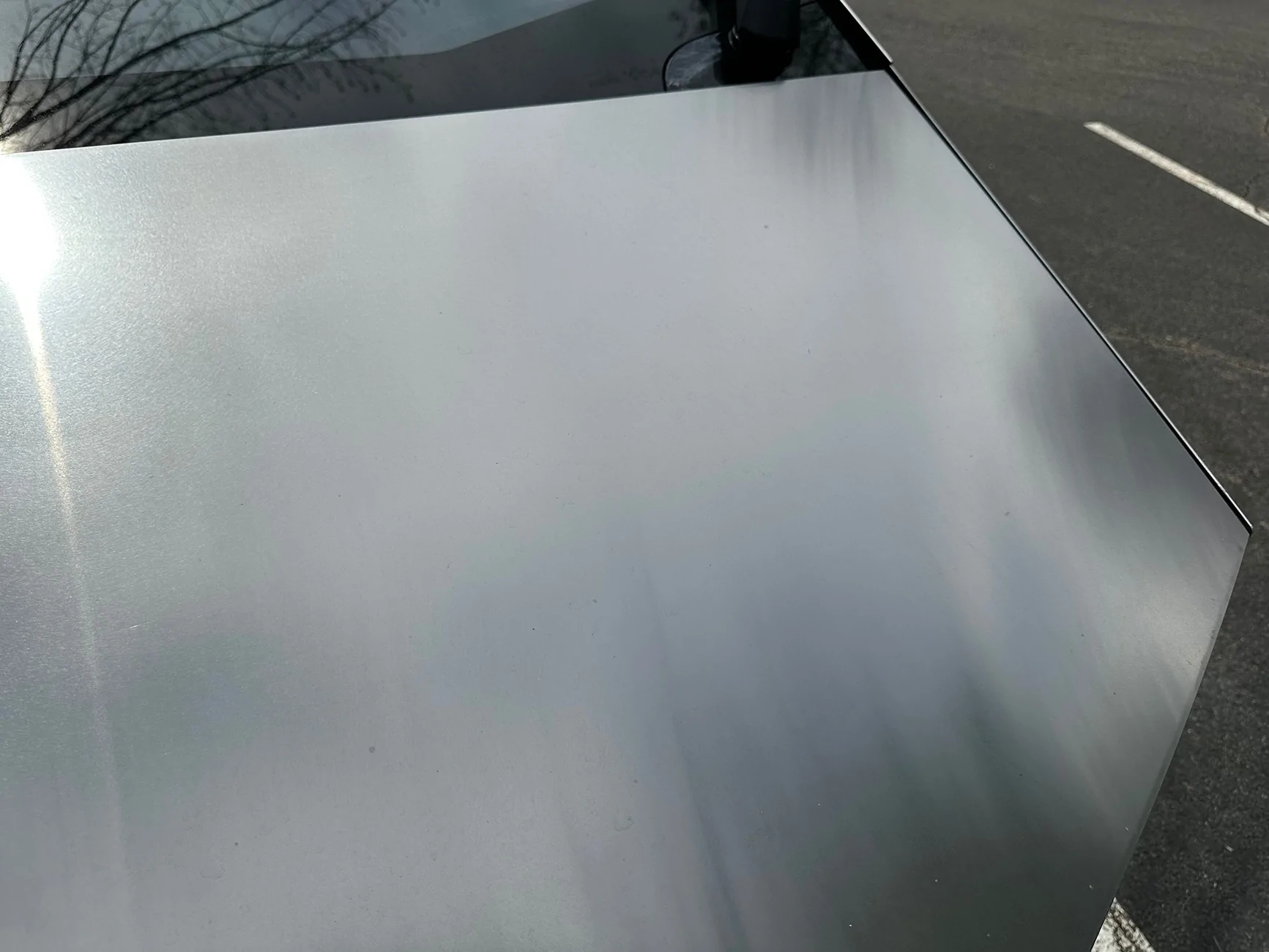

I tried it on Tuesday by following the instructions. Here are pictures before (after power washing)
Tesla Cybertruck CYBERBRITE works Great! But… IMG_1587
Tesla Cybertruck CYBERBRITE works Great! But… IMG_1588
Tesla Cybertruck CYBERBRITE works Great! But… IMG_1589
Tesla Cybertruck CYBERBRITE works Great! But… IMG_1590
Tesla Cybertruck CYBERBRITE works Great! But… IMG_1591

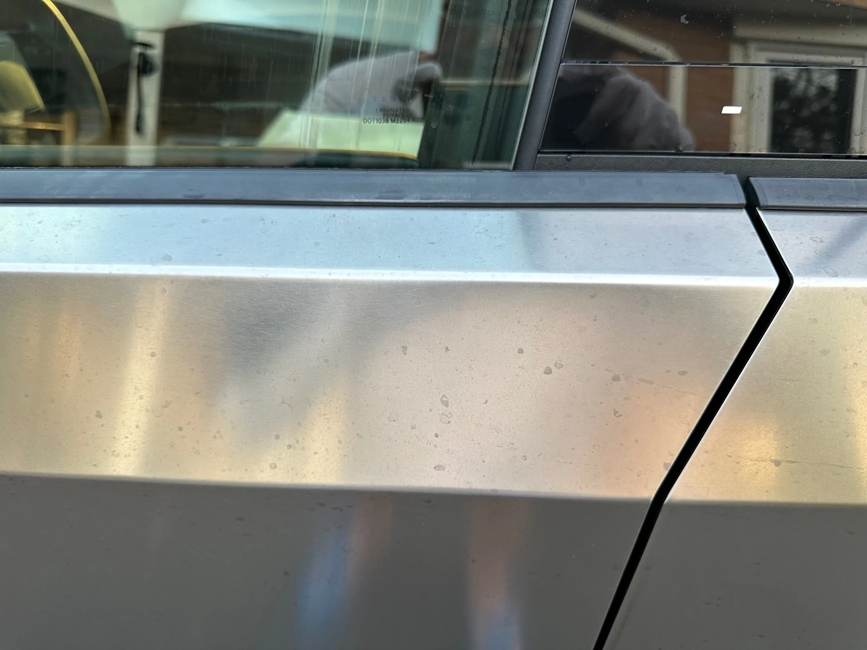

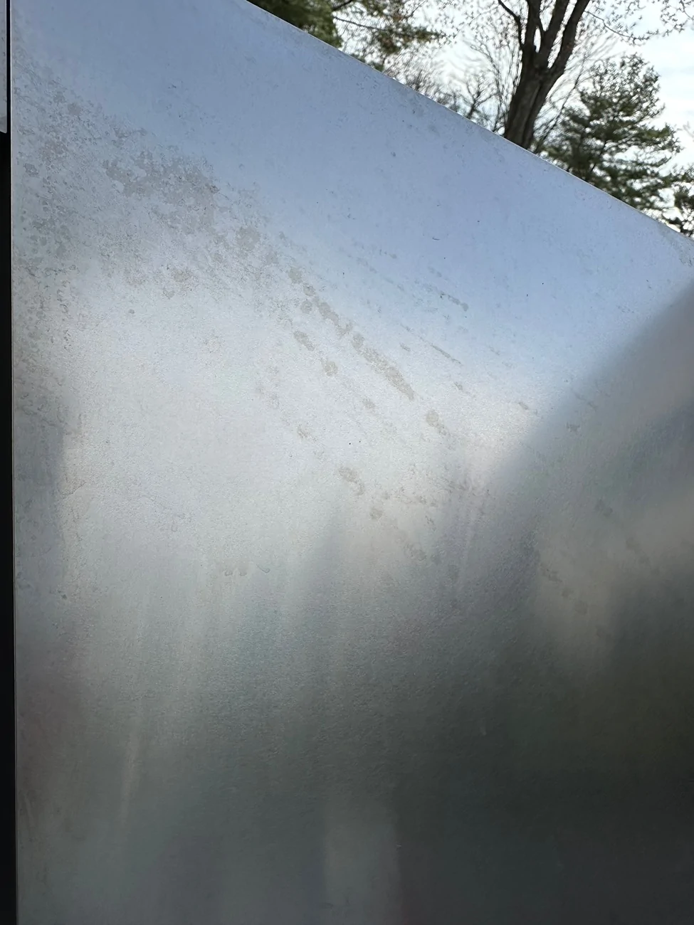

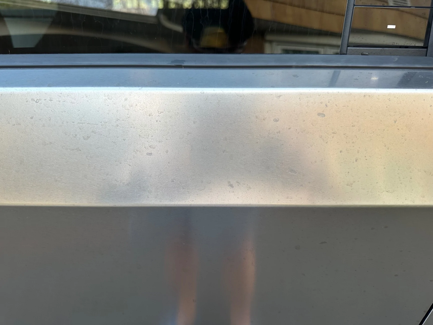

I used 3/4 bottle for two coatings. After rinsing completely with power wash. I still found a lot of touch spots. They have been there for long time since I got the CT nearly two years ago.
Tesla Cybertruck CYBERBRITE works Great! But… IMG_1598
Tesla Cybertruck CYBERBRITE works Great! But… IMG_1599
Tesla Cybertruck CYBERBRITE works Great! But… IMG_1602
Tesla Cybertruck CYBERBRITE works Great! But… IMG_1604

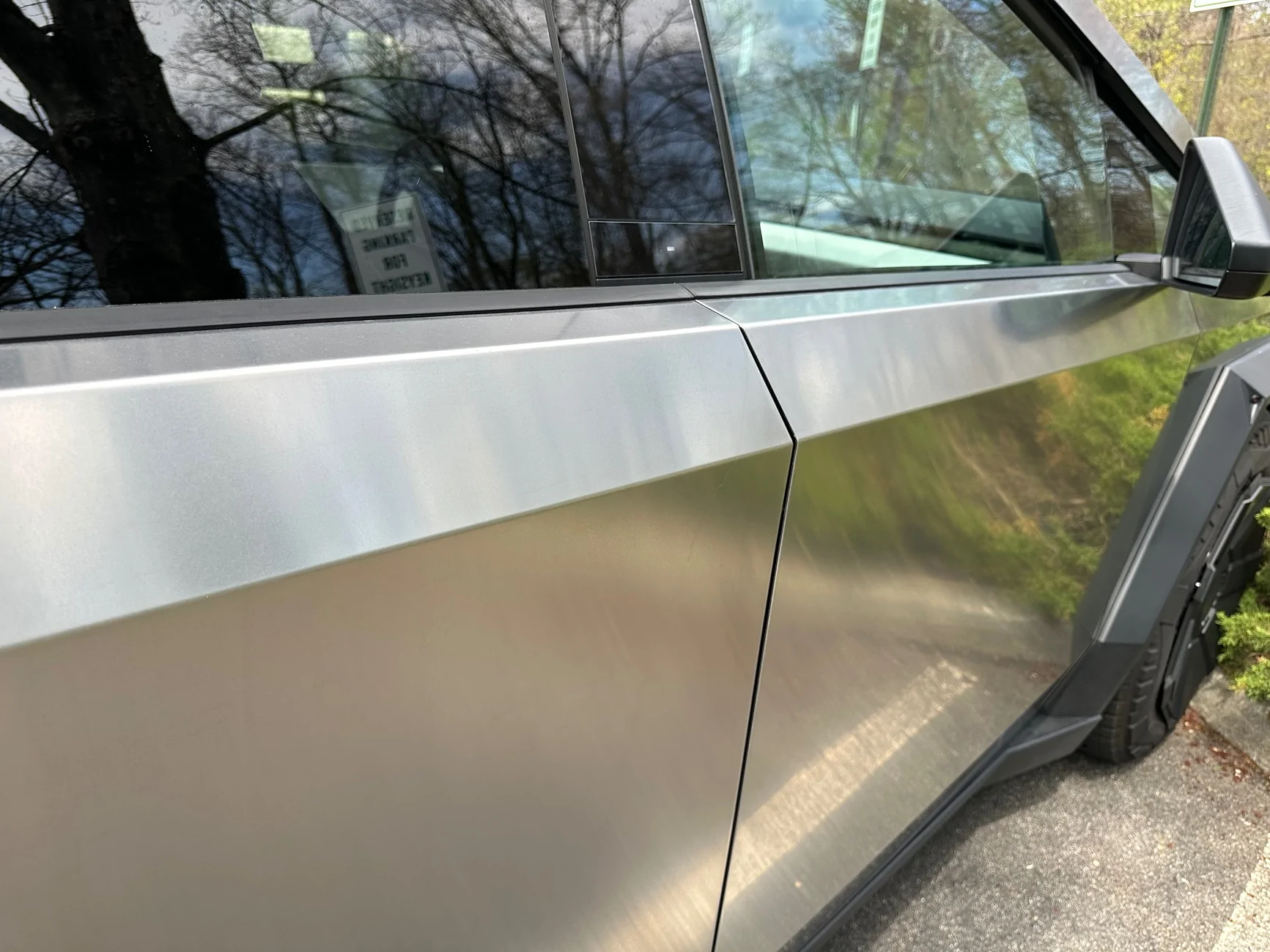

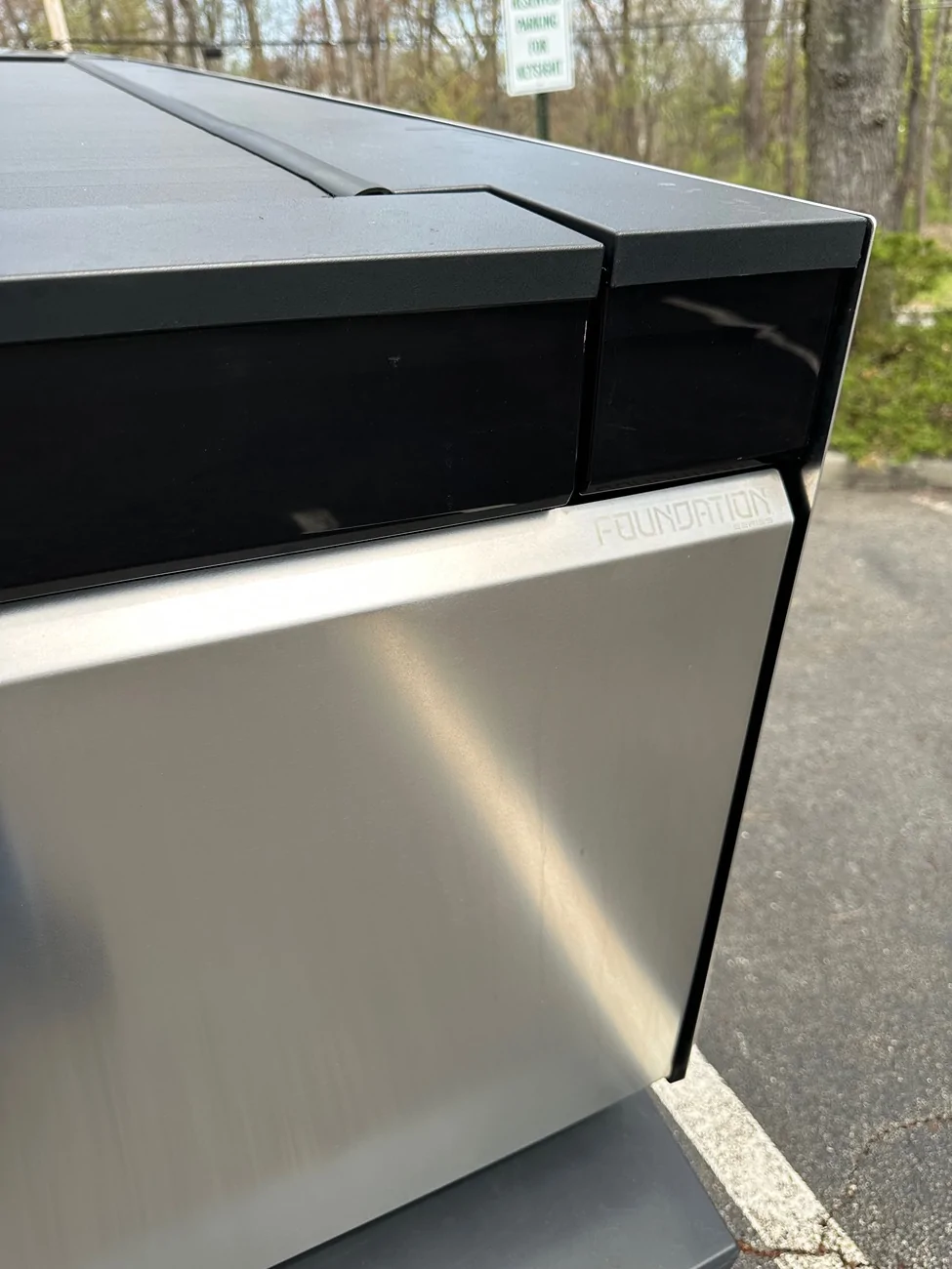

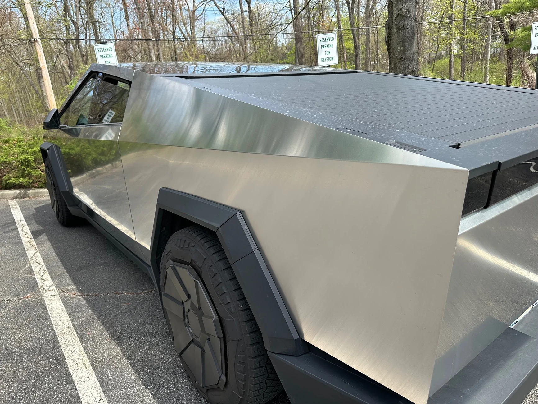

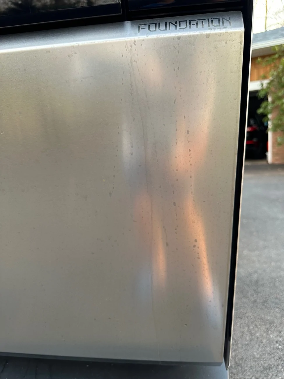

Yesterday (Wednesday), I tied it again, two coatings on those tough spots, using the remaining 1/4 bottle. Then it looks great as shown below:
Tesla Cybertruck CYBERBRITE works Great! But… IMG_1612
Tesla Cybertruck CYBERBRITE works Great! But… IMG_1611
Tesla Cybertruck CYBERBRITE works Great! But… IMG_1610
Tesla Cybertruck CYBERBRITE works Great! But… IMG_1609

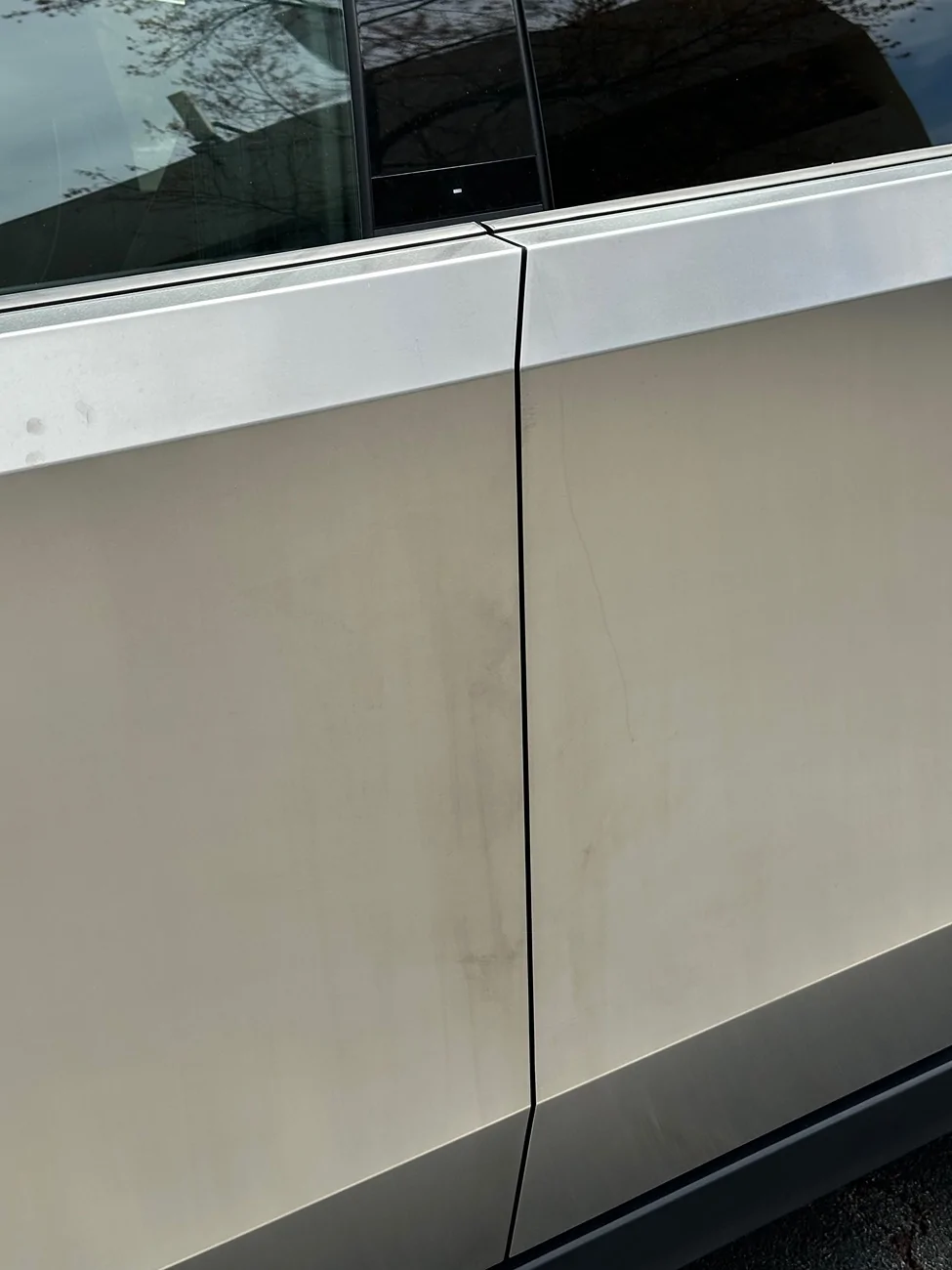

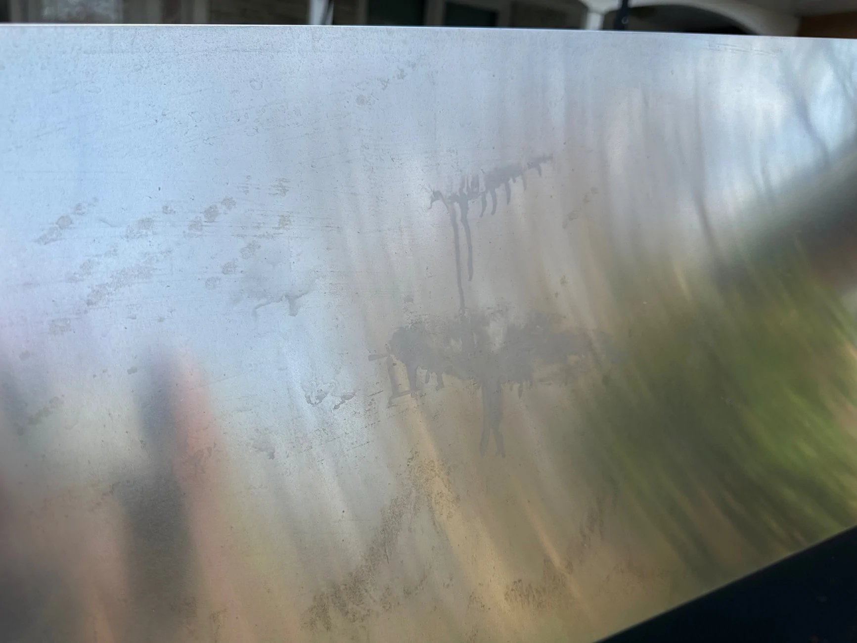

However, I still see a very large spot on the driver door, no idea how I got it in the first place. Any suggestion? Maybe I should try it again today? I ordered three bottles.

Hi, Please contact me on private chat. I have a few questions. As we have introduced CYBERBRITE, there have been a few changes to made for the first time application. I was unaware of some of the issues that might occur during application. I have seen this exact problem on another truck. We solved the issue by changing application instructions and by using 99% isopropyl alcohol. (available Amazon). I believe that it is a result of the Cyberbrite not contacting the stainless due to unrealized coatings that may have been applied. Here are the updated application instructions. Any spots that remain should be first tipped with the 99% alcohol followed by re-applying CYBERBRITE.

One other quick note. By looking at the Tonneau after you applied, the water spots are caused by minerals in the water. I believe that is what's causing your spotting problem.

Thank you Gary for your quick response. You might be right that the water I have is well water, even it was treated by water softener.
