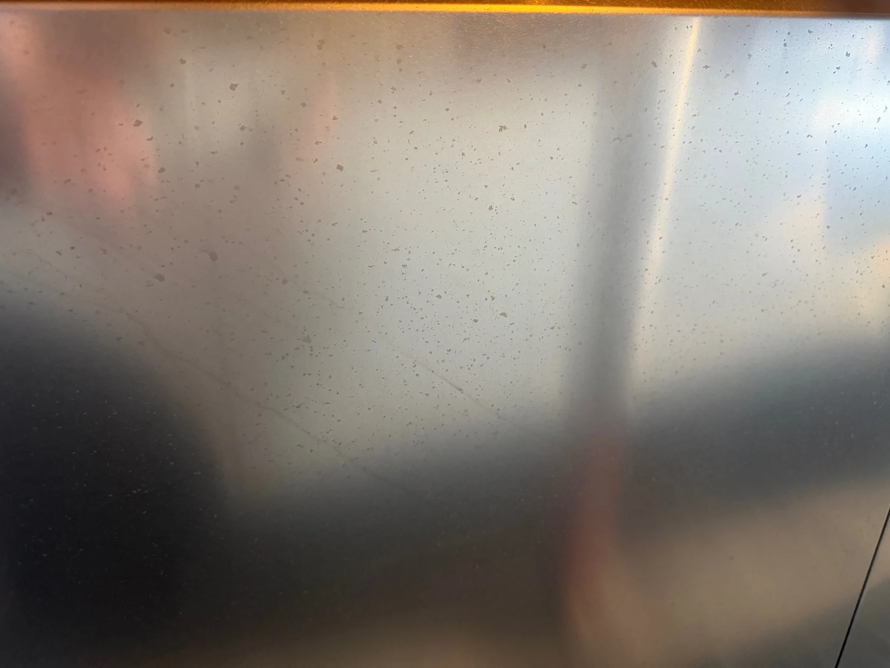

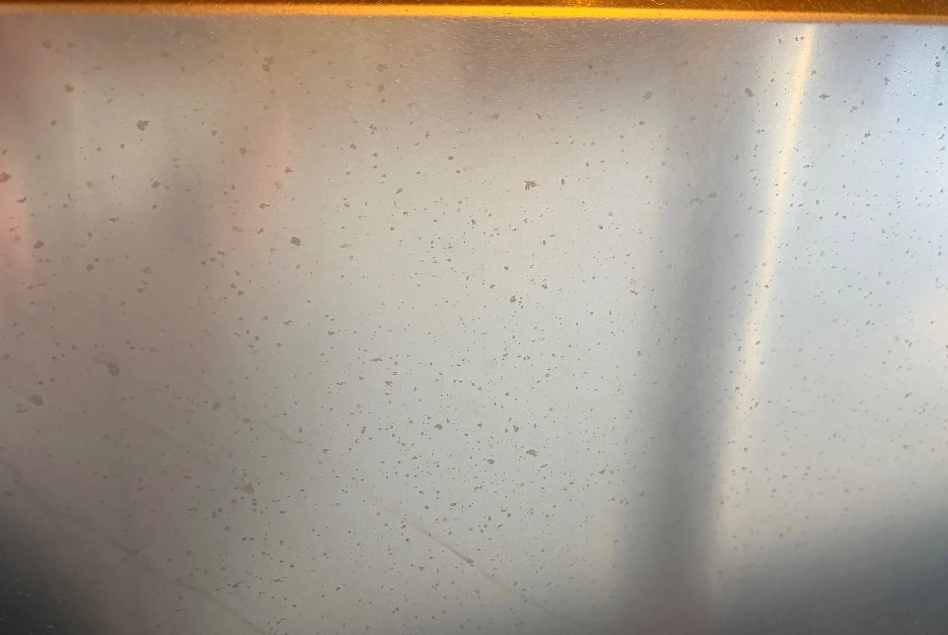

Took the Cybertruck up to Vail CO in the snowy winter last year and came back with a spotted truck. Our local tinting/wrap auto spa said they had another Cybertruck come in with the same issue but worse (they didn’t have a fix yet). Has anyone else run into this? No, I haven’t Barkeepers Helper the whole truck yet, not quite ready for that.

Tried a hard scrub with car soap and a washing hand mit and car wash power sprayer, these are deeper than that.

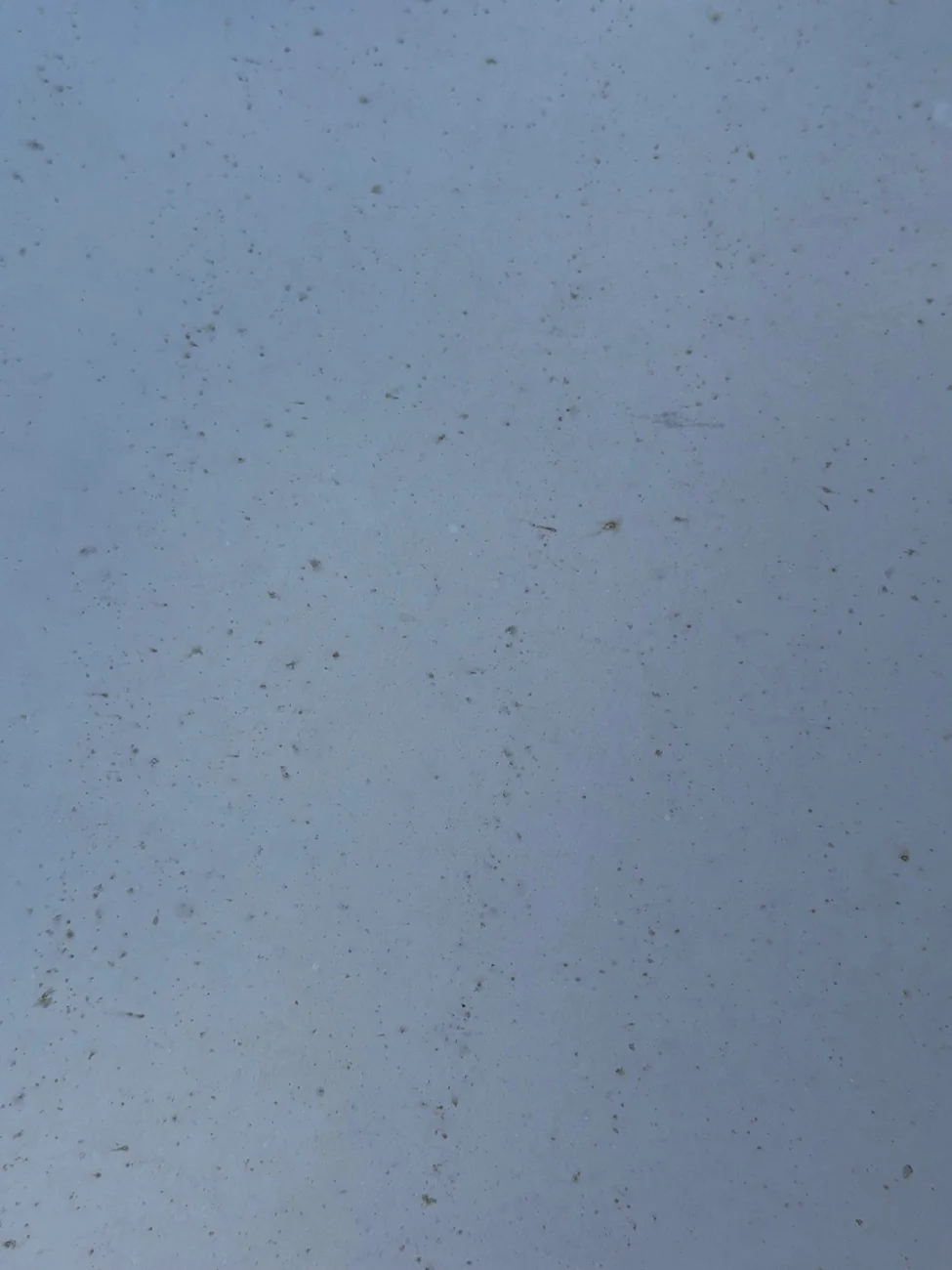

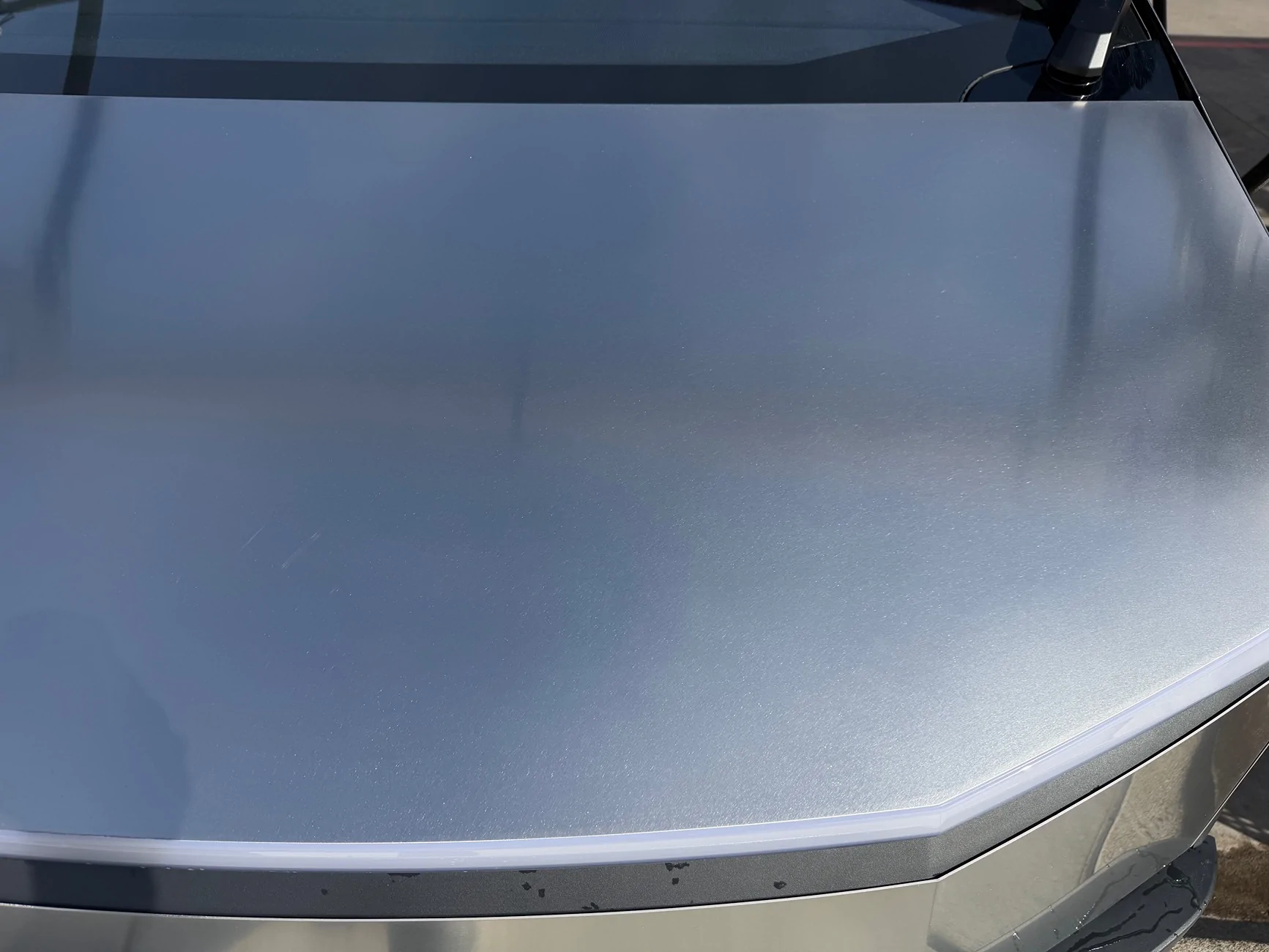

Hi. Attaches pics will show how CYBERBRITE will not only remove those spots but restore to original finish while forming a protective passivation layer to resist further contamination. cyberbrite1.com
