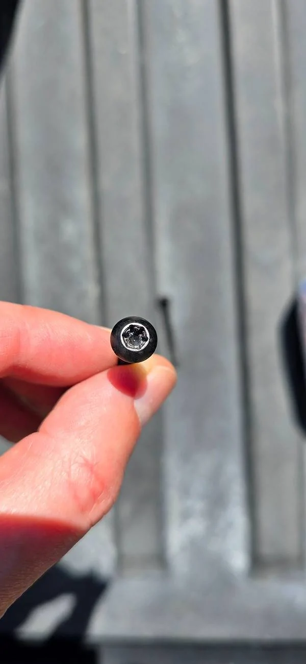

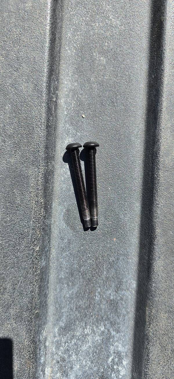

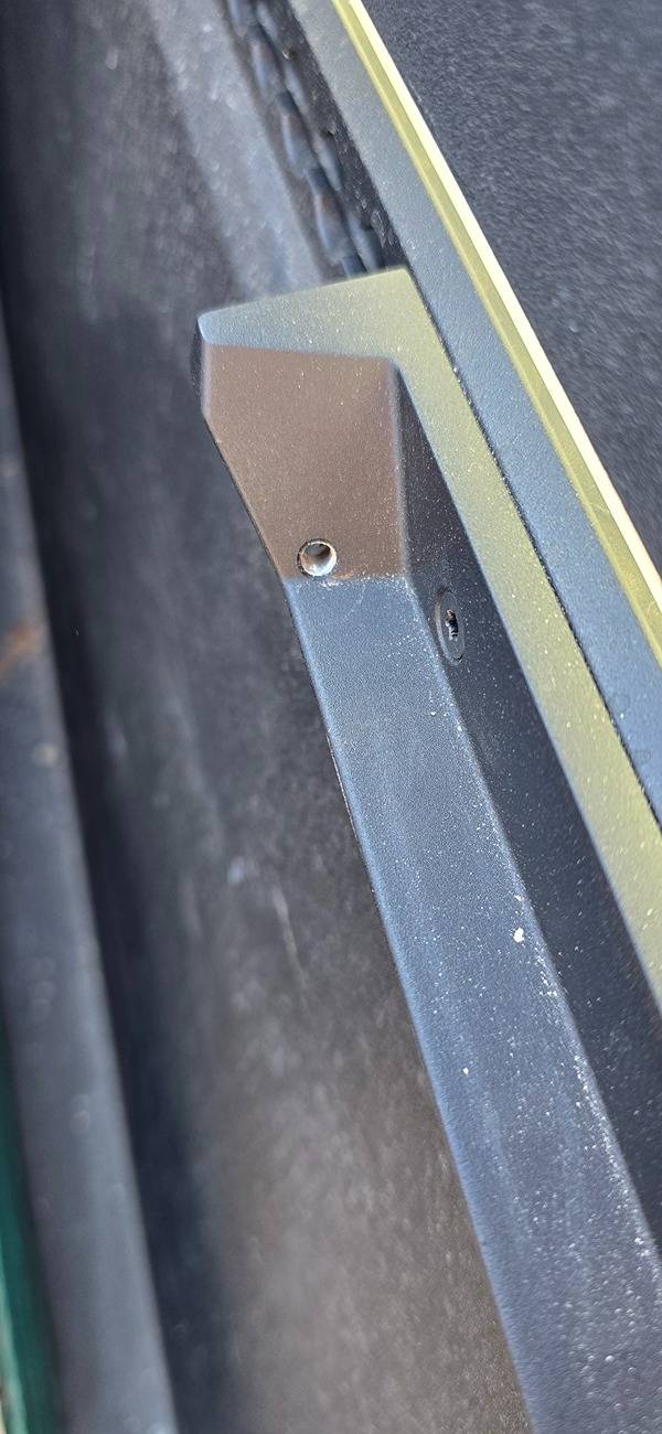

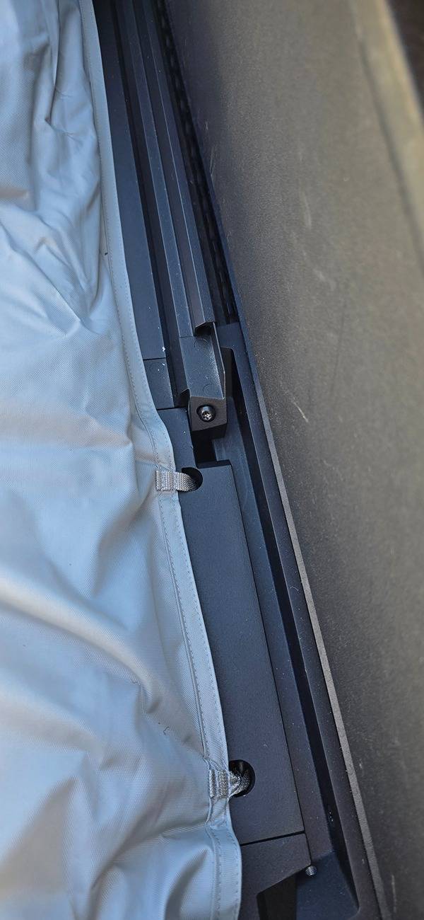

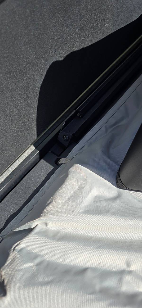

I just removed mine to load some stuff in the truck. Indeed there are only 2 long screws that are holding it. You need to unfold the tent halfway then you will see them in the middle L track bracket. I think it's a T25. Here's the installation instructions and you can work backwards from this:
https://service.tesla.com/docs/Cybe...UID-BD1728A0-EF8D-4502-A0CA-D2B85A9AB298.html
You don't need to unfold the tent to remove these screws. I take my tent out and put it back in quite frequently. The screws are definitely a little hidden by the tent cover, but they are still easily accessible.
As others have said, less than five minutes to take the tent out or put it back in. It's a bit heavy and awkward to maneuver on your own, but definitely doable.
Oh ok, so you just do it from the side with like a super long screwdriver?
aeroguy
Sep 29, 2023
143
340
VA
2013 Model S 90kWh, 2024 CT 6xxx, 2024 CT 6xxx
It is quick and easy as everyone says, less than 5 minutes. I ended up getting dedicated torx driver with handle to use (instead of using the mini angled tool that came with the tent). Makes lining up the holes on install so much easier (and speeds up removal).
