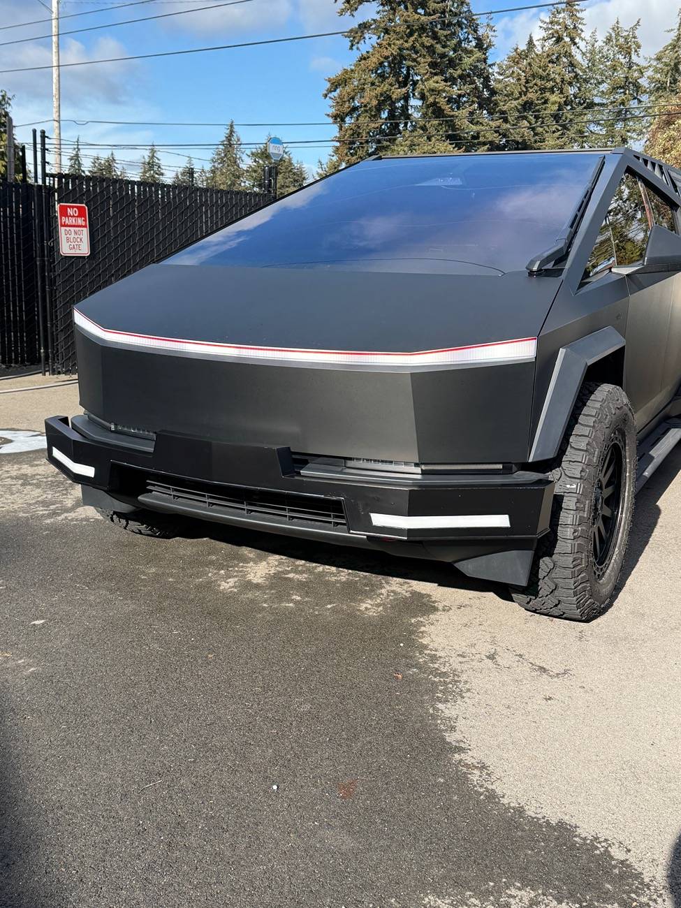

Pretty Straight Forward, 2 butt connectors for wires from truck to step down converter, the rest is plug and play.
Where did you connect the step down converter to? We created a bumper for my CT and built in some 24V lights and my electrical handyman and I are having trouble figuring out where we should connect to. We ran a 12v wire from the trailer hitch for off/on.
under frunk, lower left side by wheel well...you can find in owners manual as well
