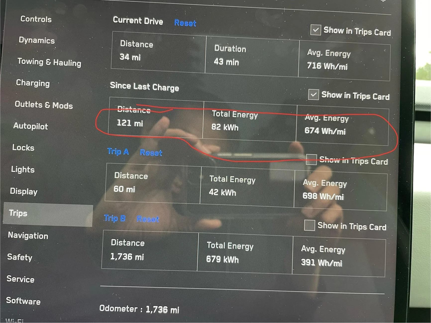

That is good testing exercise to see how weight impacts the energy consumption. Being 4000lb bricks under the touneau cover, there was no aerodynamic change, so the only factor was the weight which cause the consumption from normal 375 wh per mile to 495 wh per mil
So we can calculate that every 1000lb weight increase, it only needs additional 30 wh per mile unless the aerodynamic changed.
So for 4000lb trailer with same aerodynamic 6000lb trailer, eg. airstream bambi 20' vs flying cloud 25',the difference is only 60 wh per mile. I tested for bambi 20, the average energy consumption was 675 wh per mile, it translates the max 182 miles, we can estimate for 25' flying cloud, the energy consumption would be 735 wh per mile, it translates 167 mile, there are only 15 miles apart the both trailer. It proves again the aerodynamic is much more important than the weight itself.
