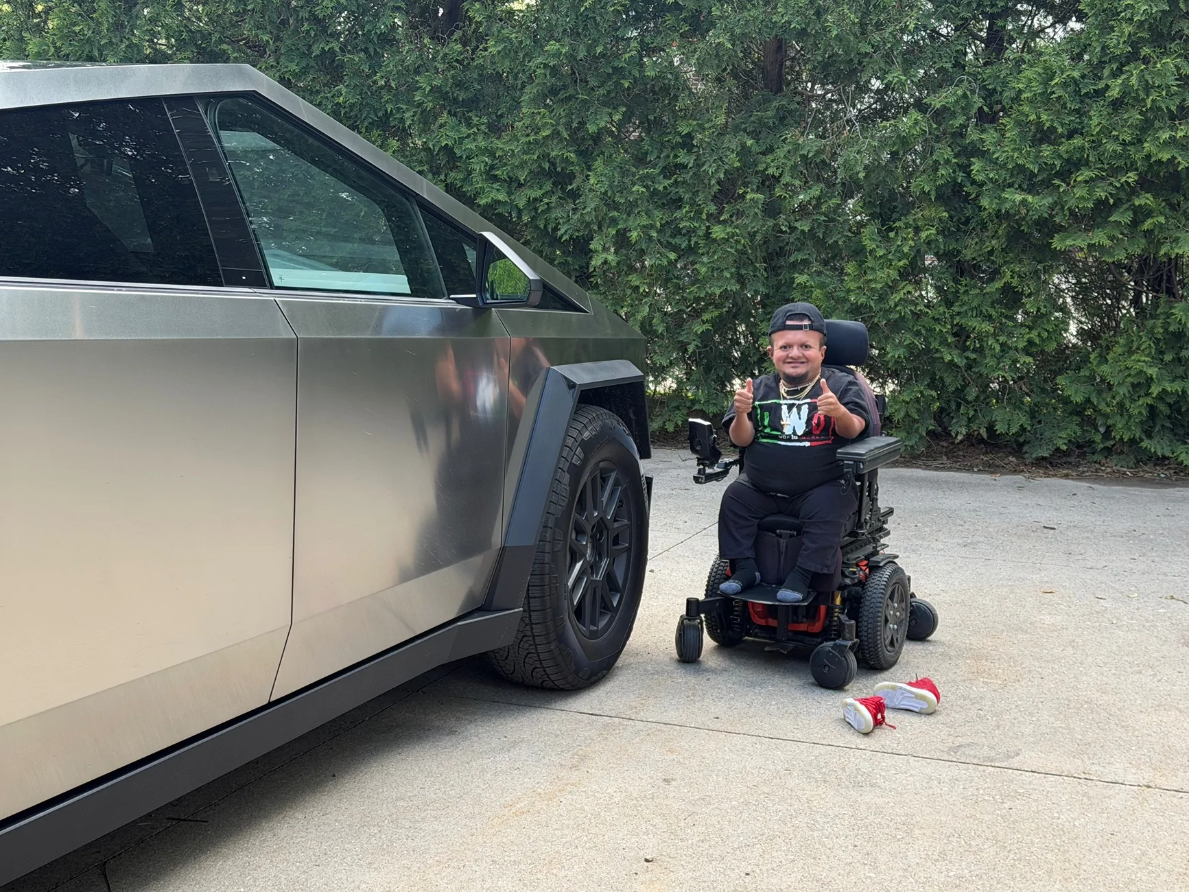

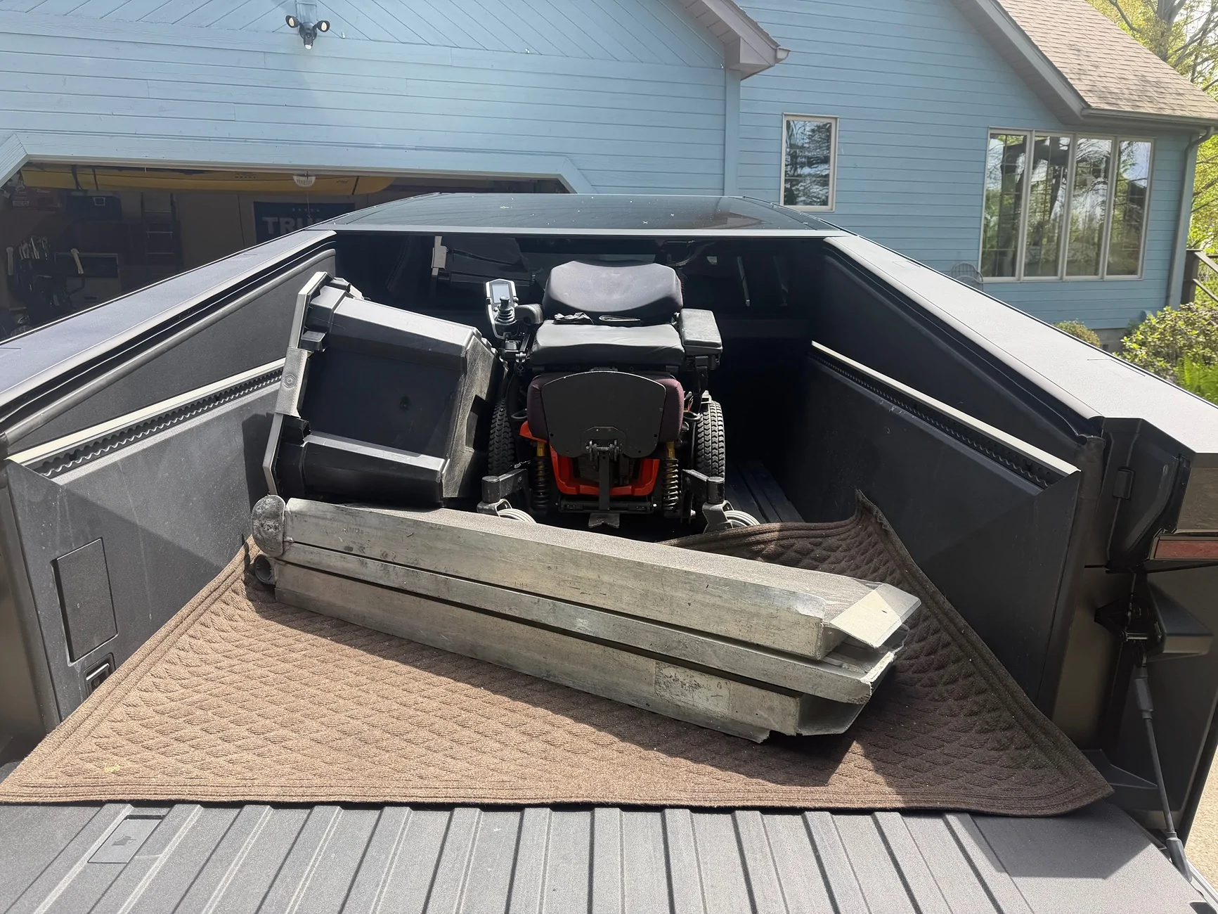

Tesla Cybertruck Putting a powered wheelchair in the bed of the Cybertruck. IMG_8844
I wanted to reply on the public thread to state for anyone considering accessibility issues, you can swap the front door hinge and strap for the rear door hinge and strap greatly improving access for transferring. Made a huge difference for me, and there is no interference.
I LOVE being able to take my wife into the wild on trails that wouldn't be possible really with any other vehicle. Also check my post for eliminating dust intrusion since wheelchairs, and everything else in the bed, don't love dust.
https://photos.app.goo.gl/9k6GyfQFEWKJff7A8
Love it!!!!
