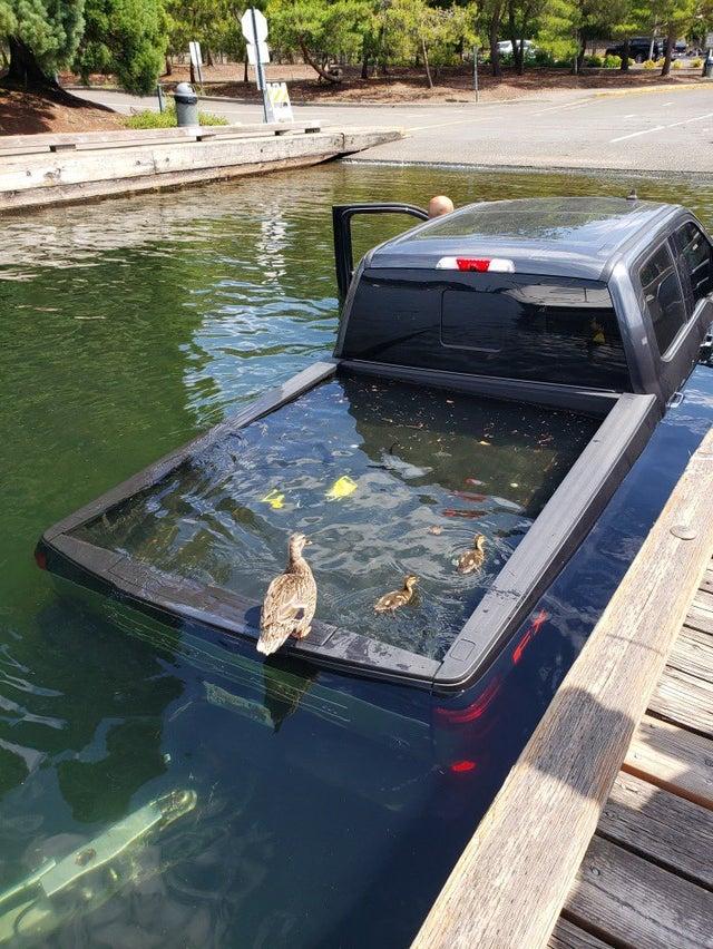

Is 900+ lbs "some water", because that is the context we are talking about here.
This conversation is stupid.
Anyone who fills their truck bed with water, while launching their boat, has clearly made a pretty big mistake and can expect to be featured on a youtube fails video compilation even if the truck makes it out.
Exactly, you must keep water out of the bed at all costs... as demonstrated by this boat launching expert…

Interestingly, floatation doesn’t exactly happen in that manner. Its a fallacy to consider Cybertrucks waterproof as floatation. Yes, float exists but in the boat launch scenario Cybertruck owners can be rest assured that the ass-end of their truck isn’t going to rise, lose rear tire contact and float the rest of the vehicle away - with you in it.
Water weight, 62#/cu ft, can and does fill the truckbed. SWAG CT bed is 15 cu ft that 930lbs is traction minus a marginal floatation uplift value. So there is more weight contributing to downforce than is responsible for uplifting floatation. NBD
