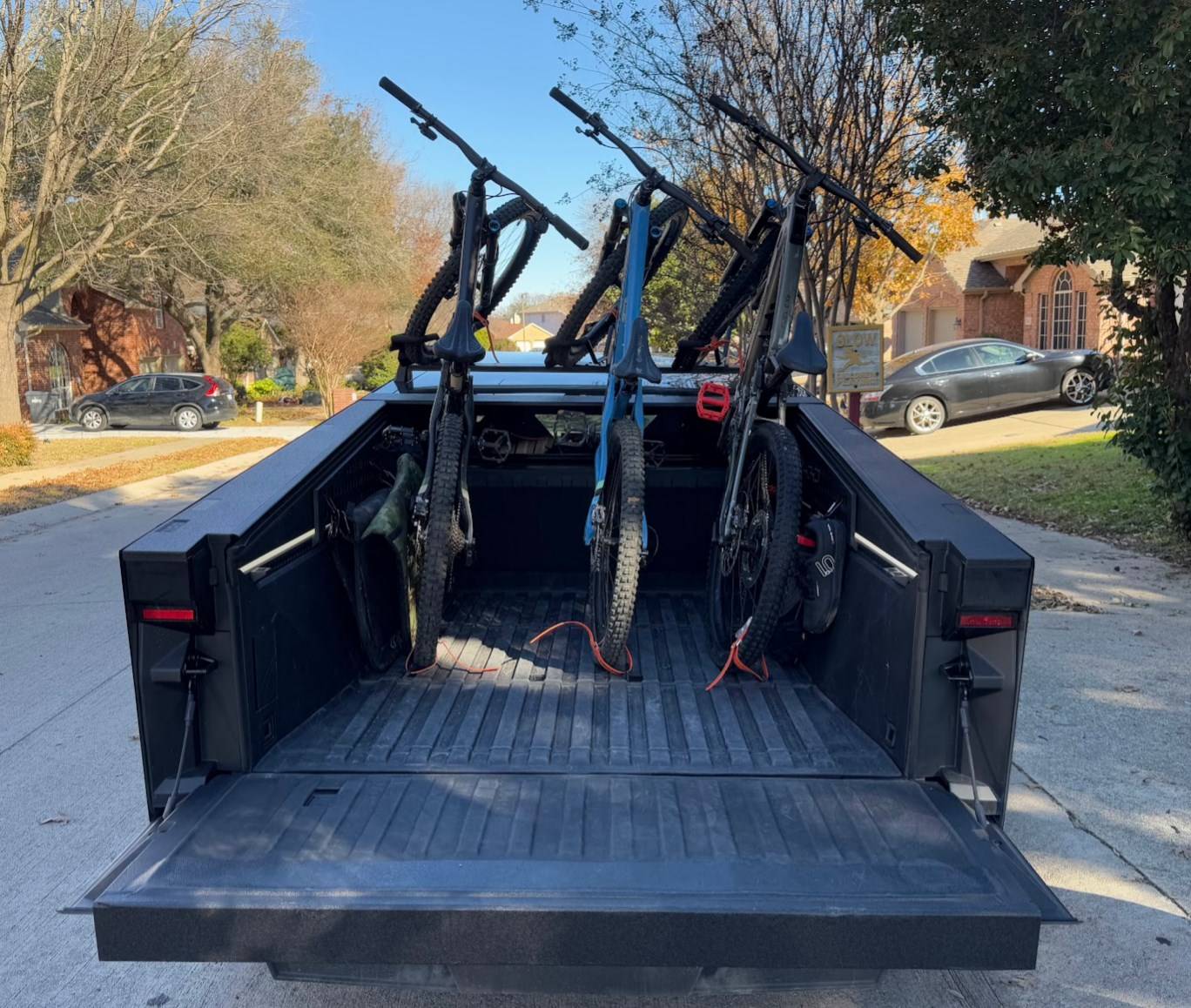

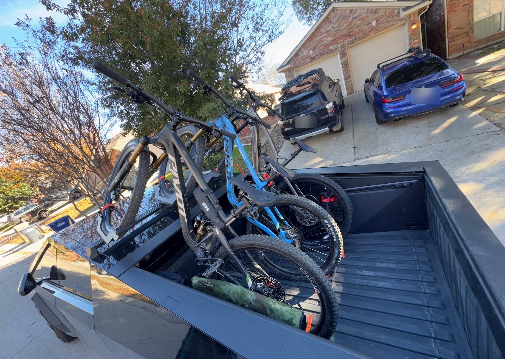

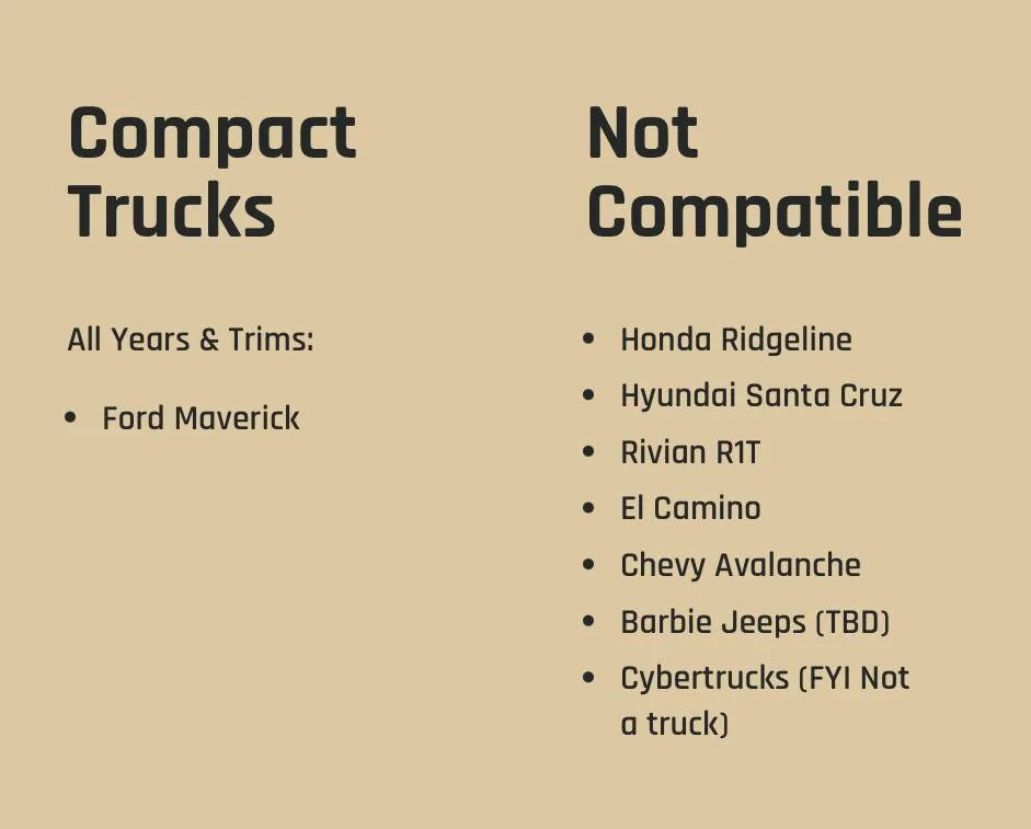

The Boundry website states that the system is not compatible with Cybertruck and actually goes as far as saying that CT is not a truck). How do you secure the rear wheel of the bikes without the entire system? I think I’ll keep using the tailgate cover.

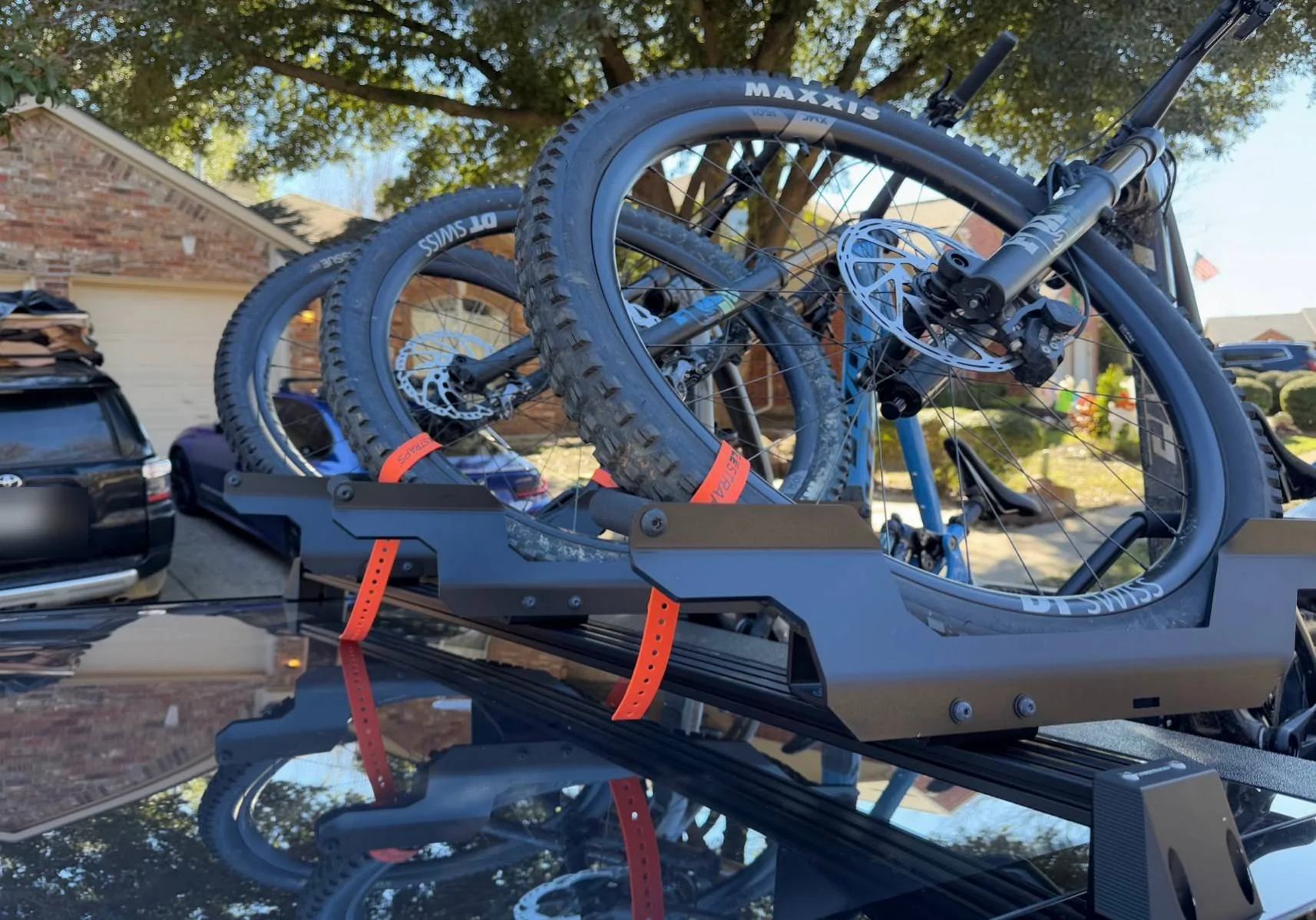

The Boundry entire system is not compatible with CT. I am just taking a part from them and combining it with a part from a T-style Crossbar to make a similar product.
The rear of the bikes are secured with Voile straps to the D rings on the bed. The Boundry system just uses another mini cross bar in the bed to achieve this, but CT doesn't need to do this and can take advantage of the floor brackets in the bed

So you just bought the bracket and connected it to the Tesla crossbar? Then you secured the bottom of the bikes with the straps? I like that.

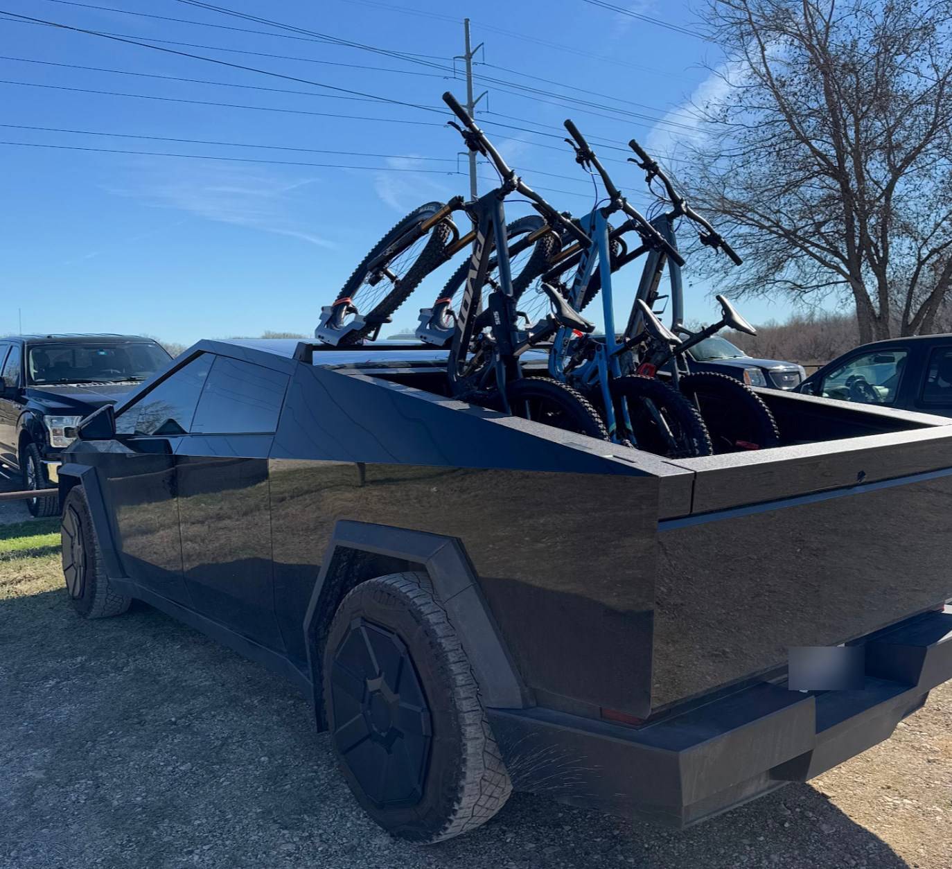

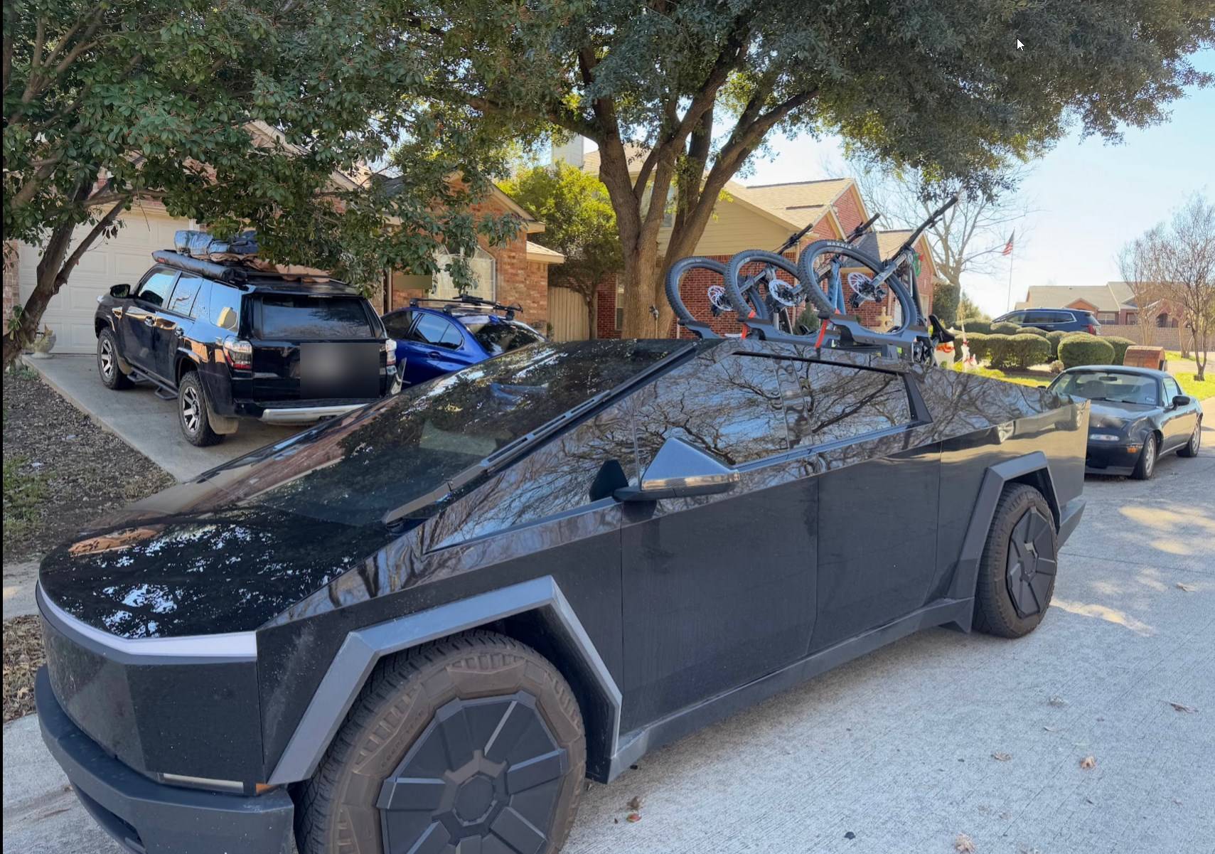

Look super solid! How's the wind noise?

I am not a fan of having a cross bar over the trunk bed (if I needed to transport something large)
And I wanted to get a lightbar in the front eventually (would be hard to get bikes that far up too)
The OEM TEsla crossbars come off in seconds using a latch and key lock system. The aftermarket versions all suck IMO because they are bolted on and they aren't faired to integrate with the truck's side angle, instead they stick straight upright, looking very non-OEM. And you have to use tools to remove them. It was well worth twice the money for the more integrated and elegant OEM corssbars.
