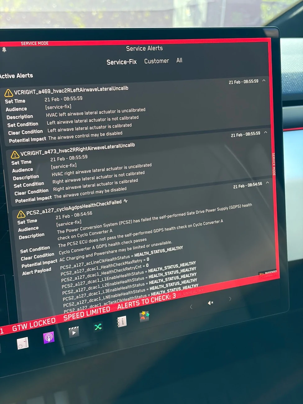

Haven’t seen this posted, but I noticed today that truck defaults to a very low power when these fail.

My FS AWD, 05/24 delivery, 11xxx, 35k just got the ‘PCS Blues‘ haha!!
I plugged in the wall connector and it went to 24A/24A (normally I’m at 40A/40A). Haven’t checked Service Mode yet, but we all know what’s up, haha!!
Submitted a service ticket. Added non-auto close tonneau and loose rear PWS speaker to the service request, too.
Glad they proactively replaced yours!!
ETA: ‘PCS Blues’ confirmed, haha!!
