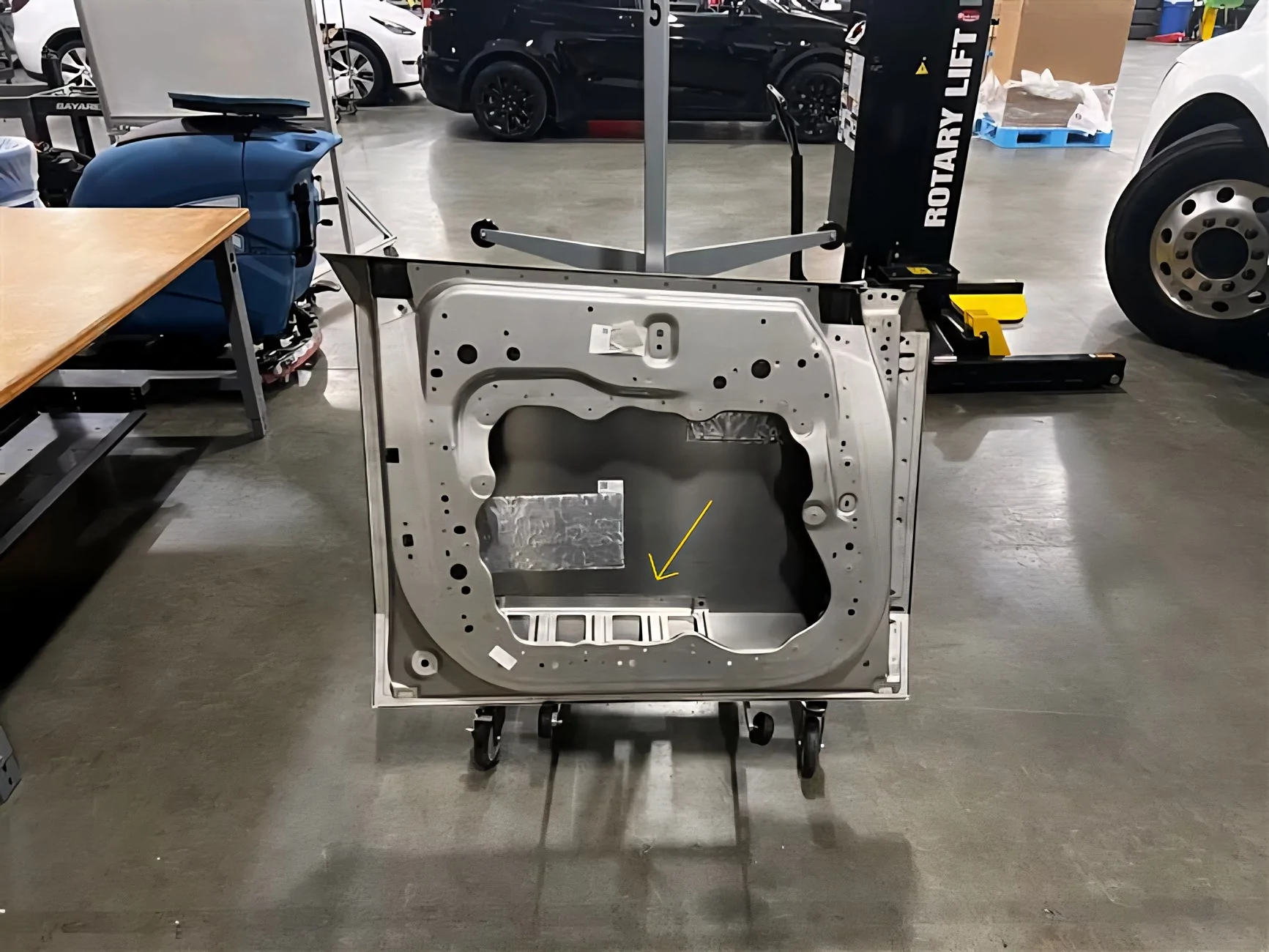

This is the spot...I'm going to get butyl tape and do this myself. My SC won't acknowledge the rattle. They would probably break and scratch something else while "fixing" this anyway.

This is the spot...I'm going to get butyl tape and do this myself. My SC won't acknowledge the rattle. They would probably break and scratch something else while "fixing this anyway.
Ah, great to know. So that’s where the glue is failing to keep the steel panel attached, right?
Let us know your results!

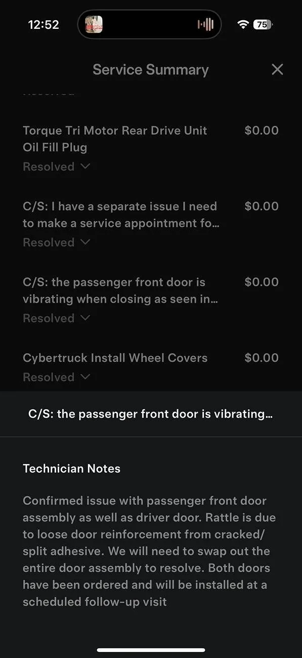

I had a vibration that occurred only over 60 mph in the passenger door. They replaced my mirror and did a few other things which did fix it. However I then developed a slight rattle after the repair. Took two trips to the service center to duplicate it but finally they heard it. Now they are saying the only way to address it is a full door replacement. My concerns are…
Will the new door still rattle?
Will they re use all the pieces of the door which could also lead to more issues and noises from stretched clips and loose parts?
Lastly will the door ever line up correctly?
Is it worth asking them to try both of the service bulletins?
https://service.tesla.com/docs/Serv...ched_Noises_And_LH_Side_Mirror_Shaking_R1.pdf
https://service.tesla.com/docs/Serv...-10-004_Inspect_Front_Door_Panel_Brackets.pdf
I also have the window tinted and door wrapped. Sounds like they re use the glass but will not pay for a re wrap as the door issue is not an official recall yet.
All thoughts are greatly appreciated
