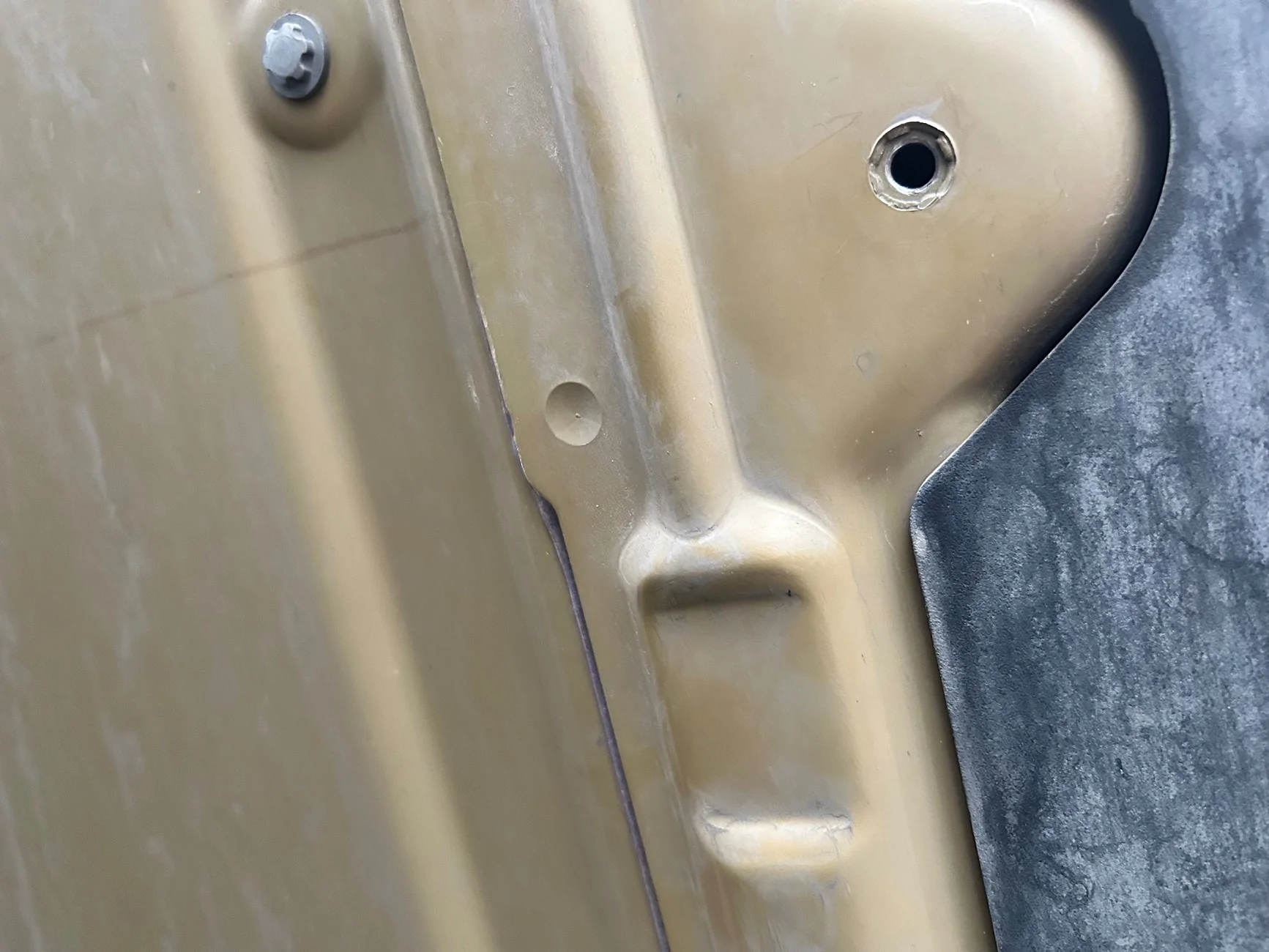

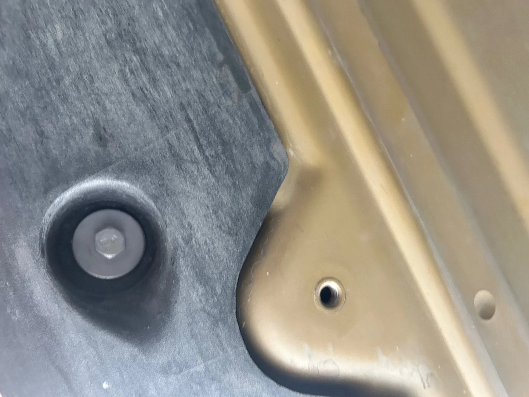

On the passenger side I ran into an issue though. These have bolts that go into the holes provided on the CT, except there is one the passenger side that is messed up from the factory.
There is threading there, but it looks like the drilled out a bit too much of the Golden bottom and went into the underneath plate too much. Here is what the others look like:
How did you finesse the messed up bolt hole problem?

Anyone have thoughts on that messed up threading? I'm going to make an SC appointment and see if they can do anything.

Trying to figure out what you are saying here - are you tell me to chase the threads myself? There was nothing in these mounting points and no one else has worked on my truck so these are messed up by Tesla factory.

There are no threads to chase, it's a hole in sheet metal.
There should be a rivnut in the hole, but it came out after coating.
Yes you are correct.

I haven't mounted the accessory in this particular hole - can't get a bolt to go in. I'm sure this is the same conversation I'll have with Tesla SC - they will say I caused it, but in reality I haven't touched it.
Appreciate your input on chasing the thread myself. I'll see what SC says first.
Mongo invited me to look a little closer at your pic to see that there no longer is a nut in there. You couldn't get a bolt to go in--did the nut come out when you were attempting to insert a bolt? Did it look like the other mounting point from the get go?
Nope, it did not look like the others from the get go - so I knew something was not right. The picture is exactly how it looked from the get go, I never attempted to force a bolt in other than by hand to see if it would thread.

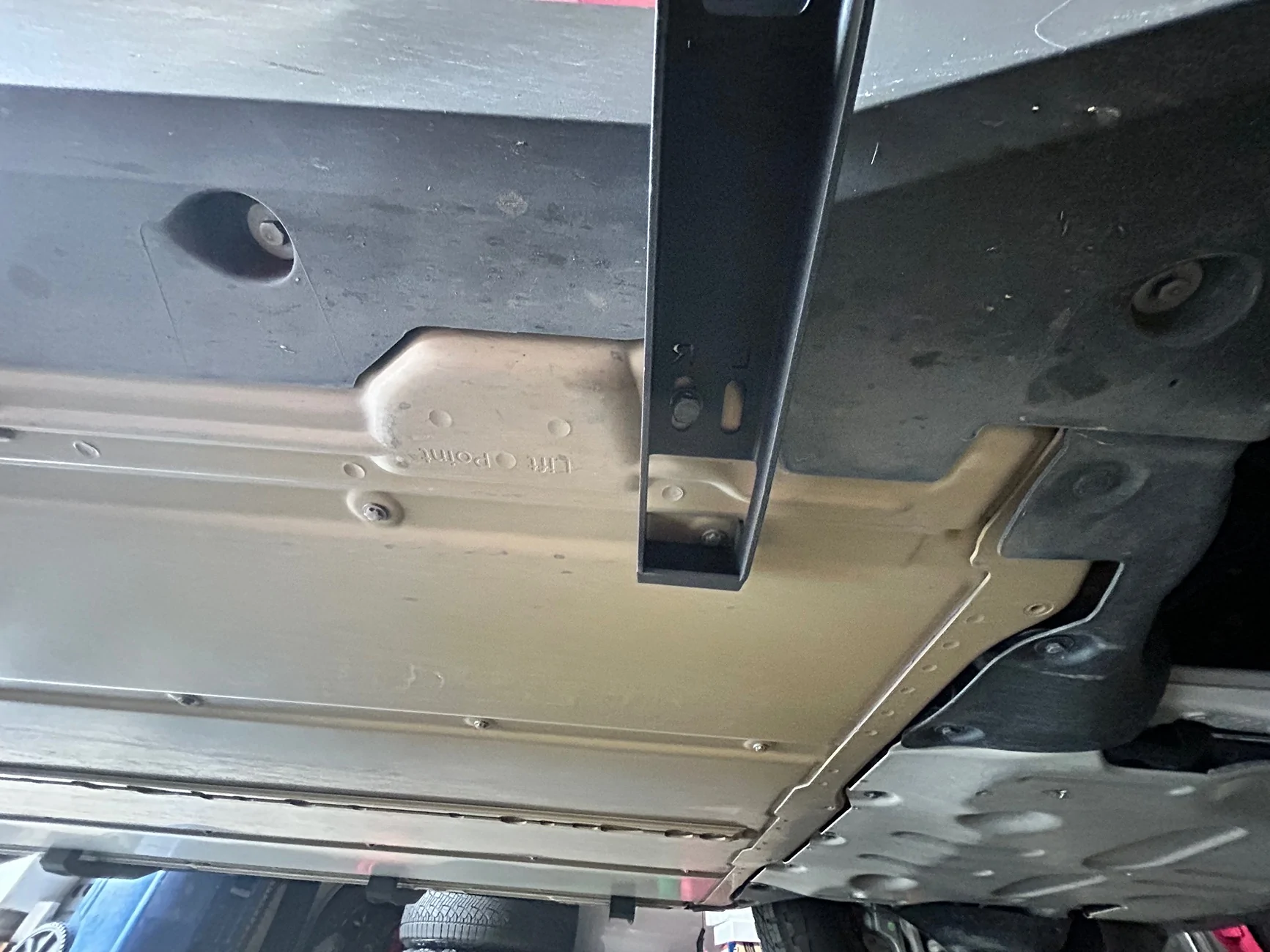

I just installed these on my CT.
Found these on Amazon for $250, they are four separate cybertruck shaped running boards. And they do not block the lift points.
These do stick out a bit beyond the
The hole you are referring to as messed up is actually missing a threaded insert, or rivnut as others have described. It is installed in a similar manner to a rivet and already has the appropriate threads on the inside. No tapping required. Unless the receiving hole is messed up, it should be a simple process for them to install a new insert.
