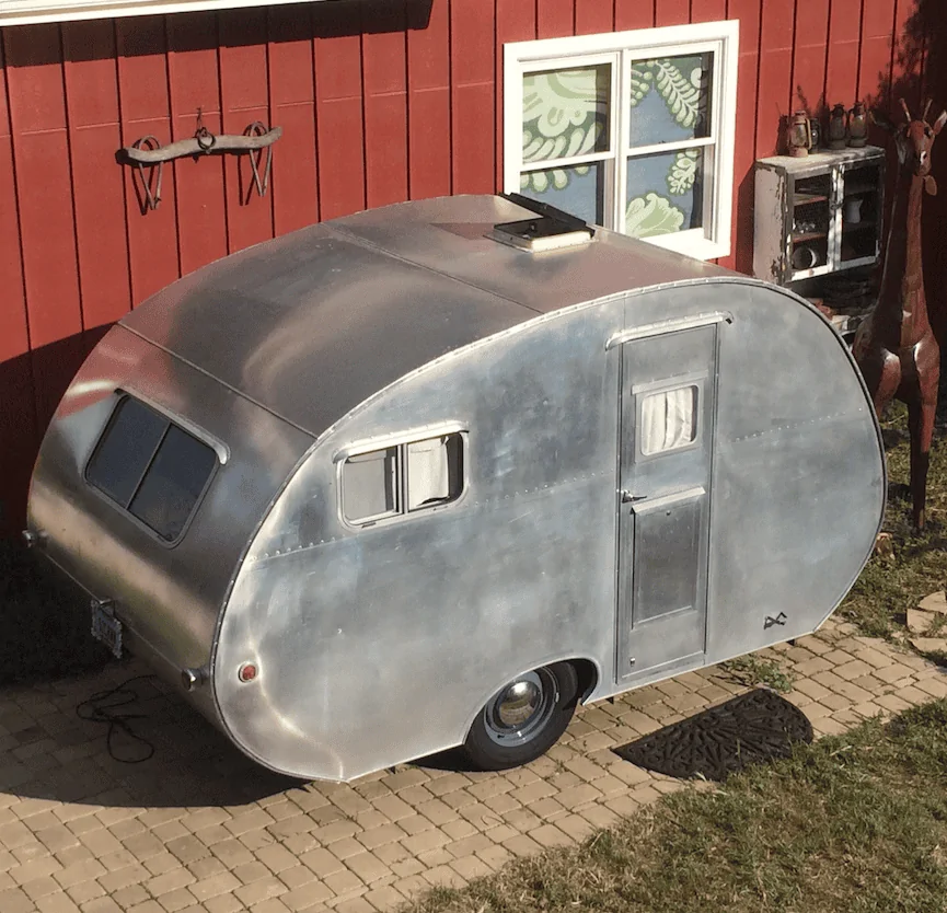

I have a 14' canned ham vintage trailer weighing 2000 pounds and pretty aerodynamic, any estimates on how much that would reduce my range by?
Yes, there is software out there that makes pretty good guesses, but you need the frontal area and the drag coefficient. Pictures from dead on front, dead on side, plus measurements might let someone who has such software do some work... but I do not have this software. I have only seen the results of others who have used it.

When towing this trailer with my 2018 bmw x5 diesel I only see about 30% drop which would roughly translate to a 350 mile range with the trimotor, another beneficial factor is in california the speed limit is lower when towing, sometimes when towing my very small utility trailer i get better mpg Regardless even if the range was closer to 250 miles I could live with that
Is the trailer higher than your BMW? Is it wider than the body of your BMW?
If the trailer sits completely in the 'wake shadow' of your BMW (or the CyberTruck), the impact to range will be significantly lower.

everyting has been replaced on my 1952 Crown 14, new siding, studs, floor, birch interior walls and cabinets, electric and gas, and windows the only thing original on the trailer is the frame, door and suspension, do you have a source for vintage trailer windows, my wife is rebuilding hers and want to go with something more authentic than what I used
