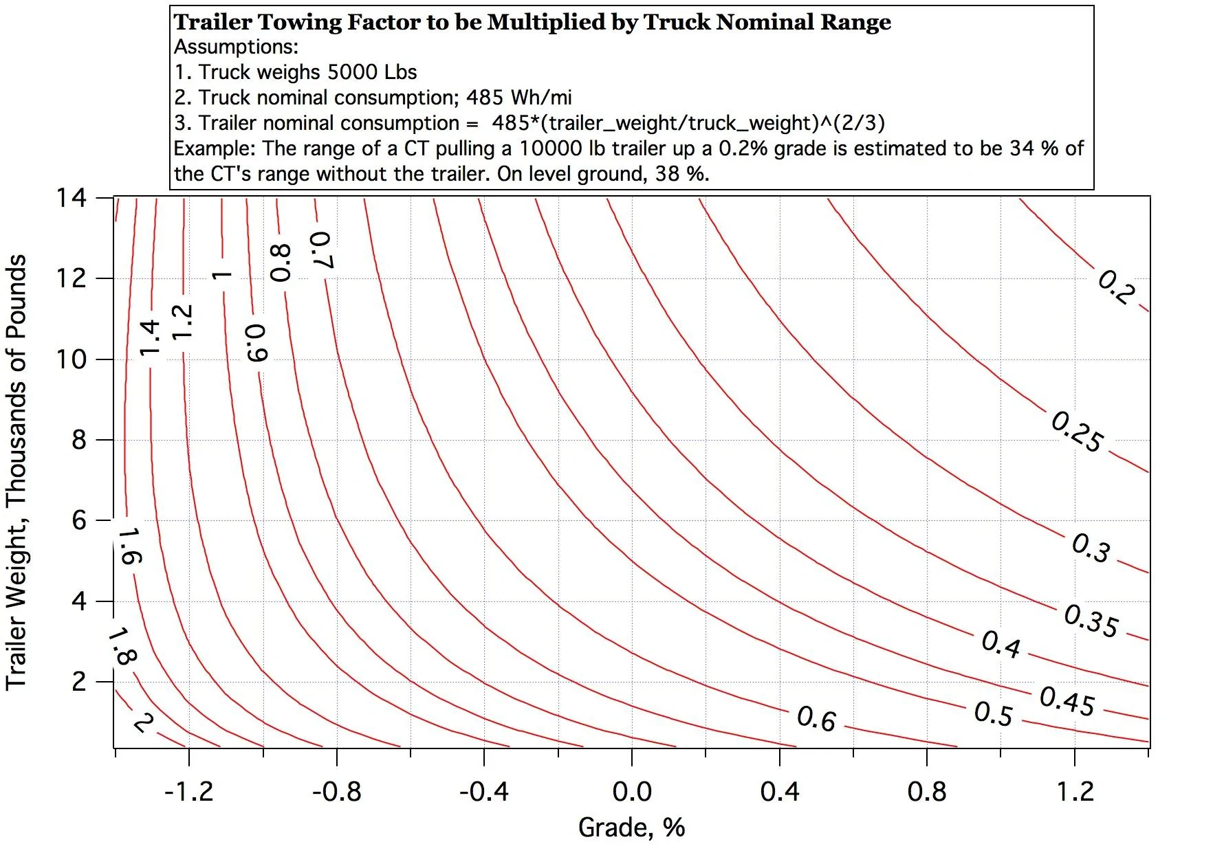

Because the last post was long and probably confusing to many (uses dreaded math) I took the formulas and used them to make the following picture based on several assumptions. Because of this the graph cannot be expected to produce accurate estimates of what range one will get with a particular trailer but rather give an idea of what the implications of increasing trailer weight and grade are when a trailer is towed.
Tesla Cybertruck Cybertruck Towing Range TraileFactors
To use the graph find the intersection of the grade and trailer weight. Now look at the curves to the left and right of this and note the numbers on them. Multiply the number on the closest curve by the range of your CT without a trailer. For example if you have the 500 miles Trimotor and the closest curve is labeled 0.6 your estimate is 0.6*500 = 300. You can refine the estimate by interpolating between the two closest curves. For example, if your intersection lies half way between the 0.5 and 0.6 curves the factor is 0.55.
Because this is an attempt to simplify I'll refrain from discussing the assumptions or the implications of changing them but will be happy to respond to any questions.
To use the graph find the intersection of the grade and trailer weight. Now look at the curves to the left and right of this and note the numbers on them. Multiply the number on the closest curve by the range of your CT without a trailer. For example if you have the 500 miles Trimotor and the closest curve is labeled 0.6 your estimate is 0.6*500 = 300. You can refine the estimate by interpolating between the two closest curves. For example, if your intersection lies half way between the 0.5 and 0.6 curves the factor is 5.5.
This is a perfect tool to help with towing decisions and the impact we'll see with battery range. I'm good with math but certainly more of a visual learner. I saved this chart for a helpful summary of what to expect while towing my Airstream Travel Trailer. Thank you for taking the time to help and put together so much excellent data and information.
