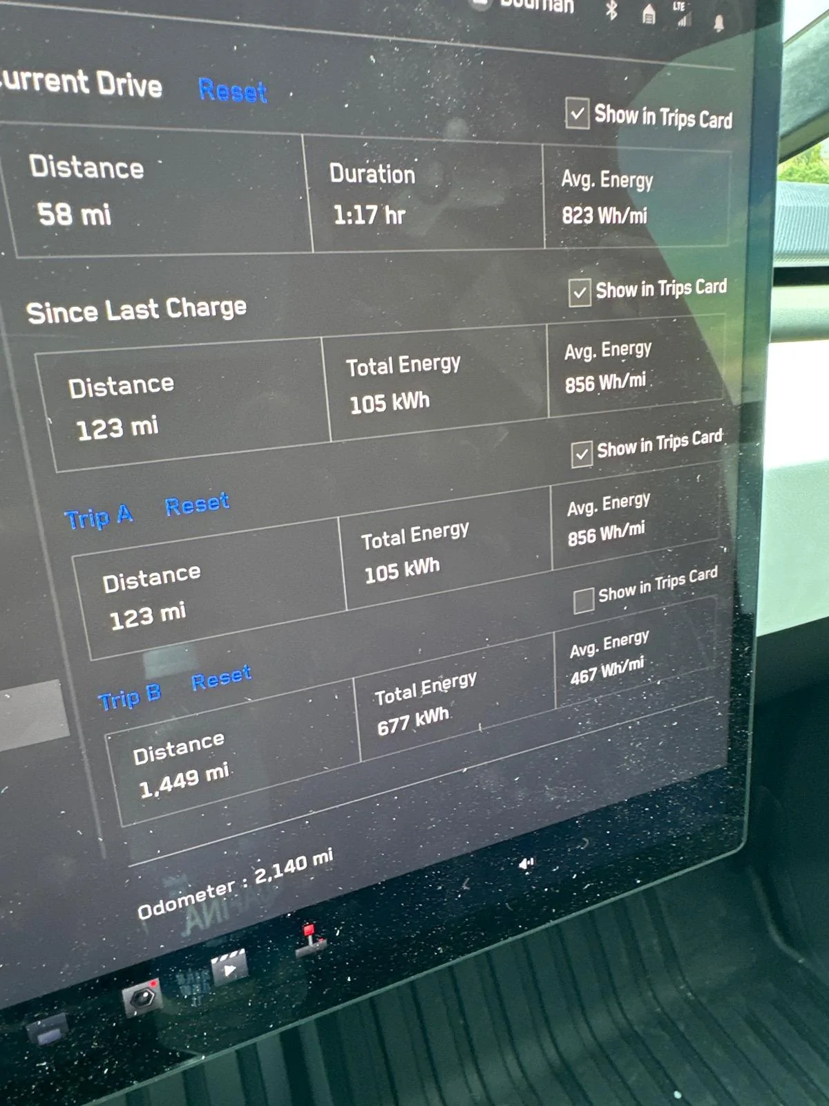

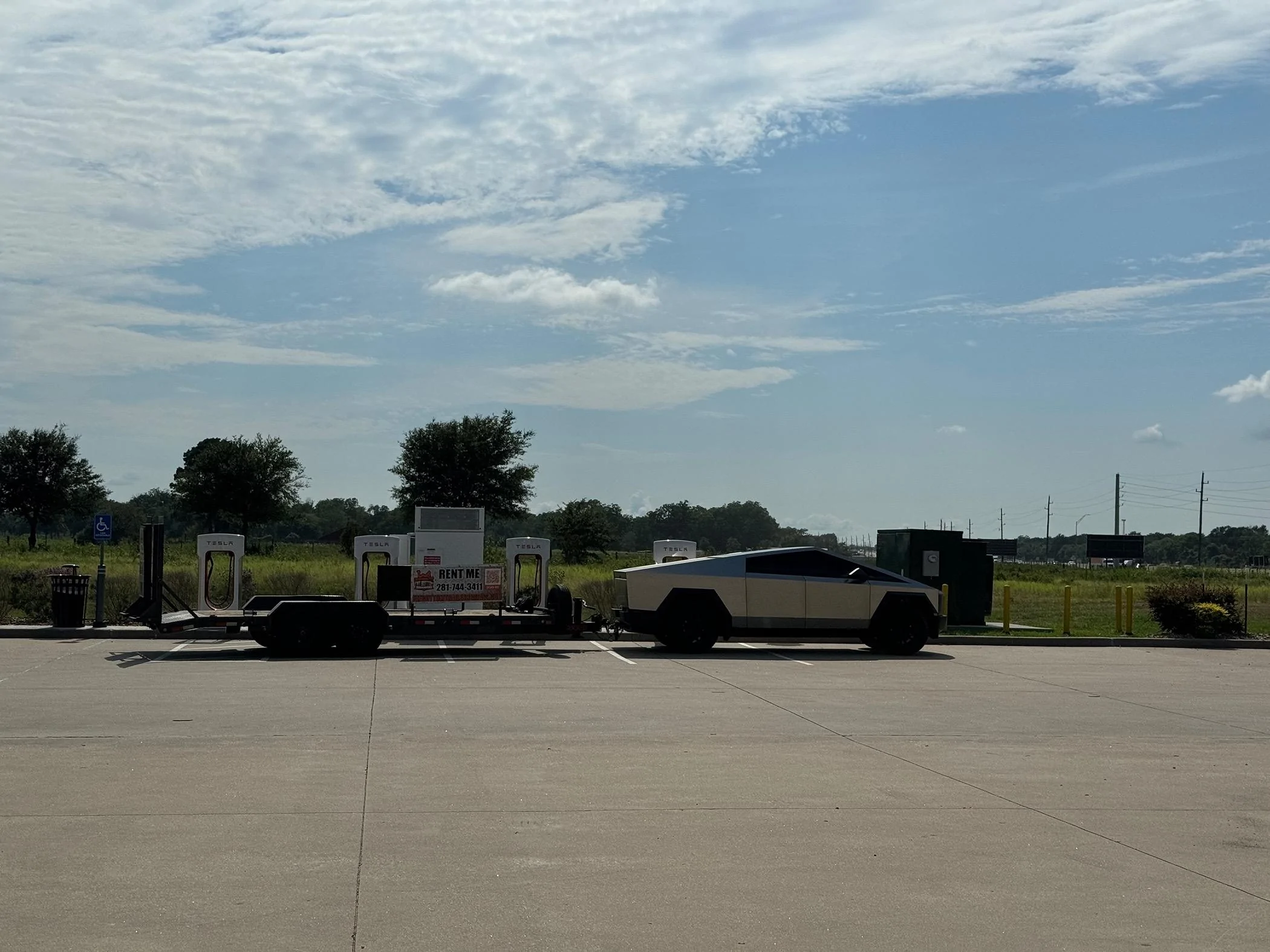

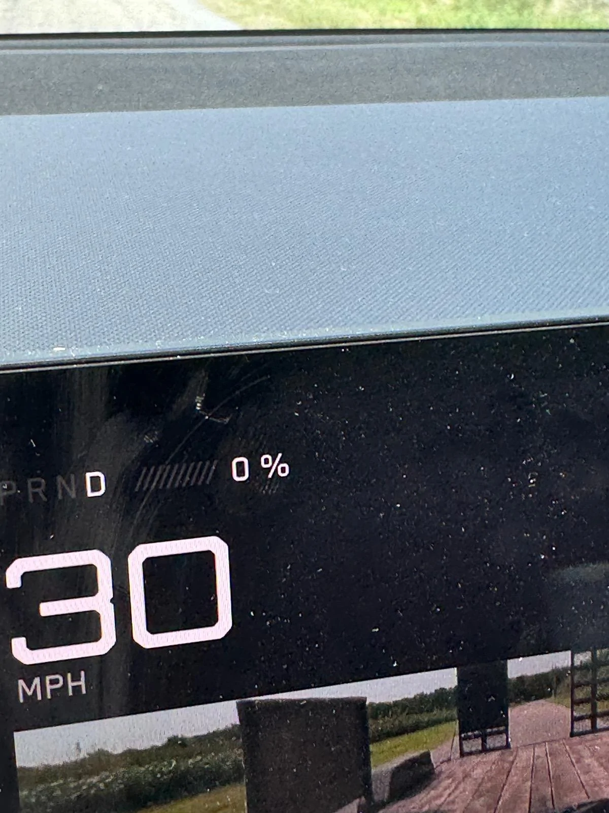

So I towed a 20 foot trailer to pick up some roll up doors for a project I’m building. The entire trip including pickup and drop off at final destination is about 80 miles each way.
let me put this way. I am never going to do this again in the cybertruck. The range is literally half!
Averaging 856 WH/Mi!
I arrived at the supercharger station (my 3rd stop during that trip) with 0%.
Still love the truck though! ?
I mean ... physics 'n all.

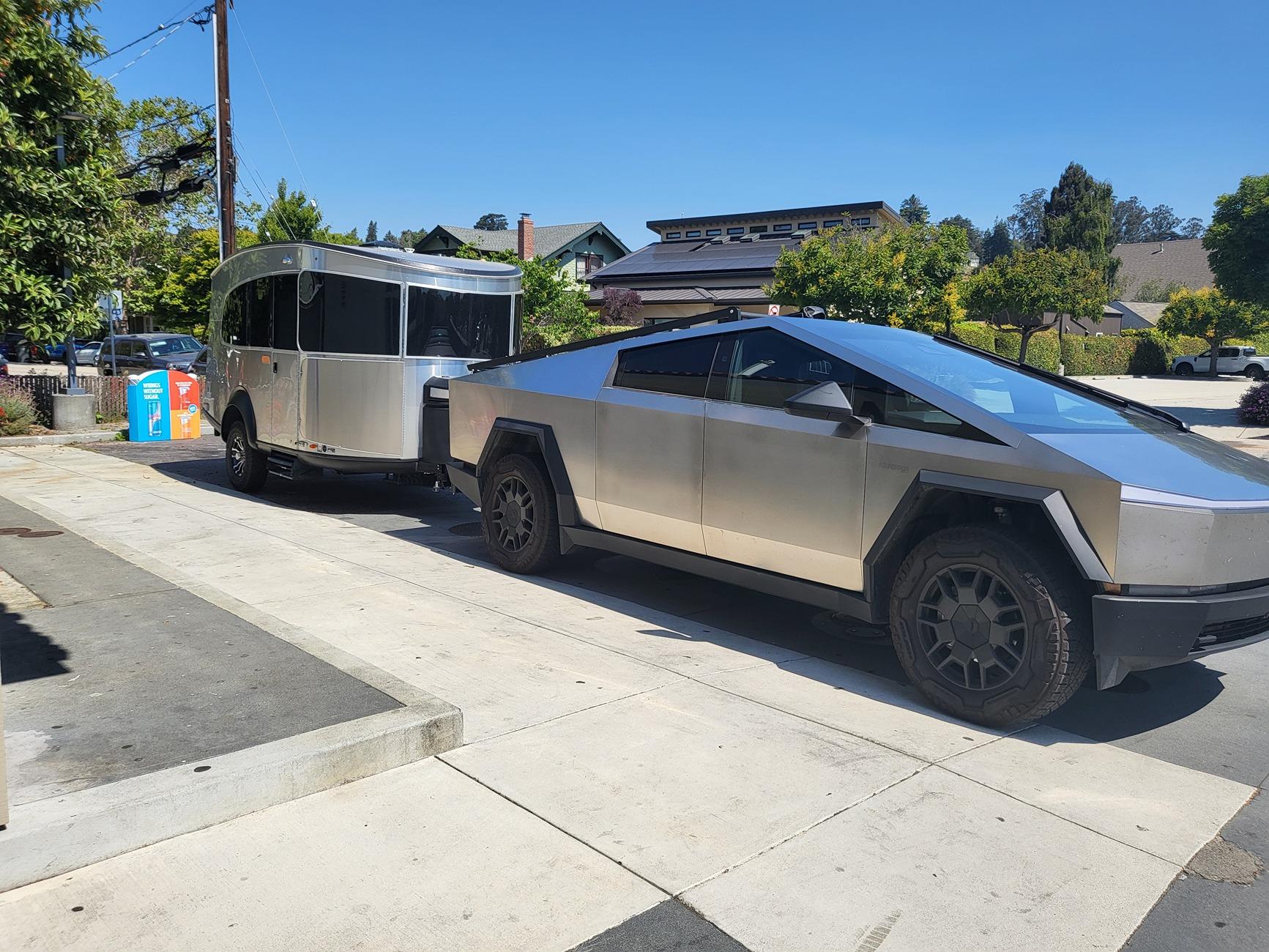

I towed a 3500lb airstream basecamp from my home over the 17 to Santa Cruz, CA and up the coast to Half Moon Bay, CA then back home. It took 7hrs because I stopped 7 times to perform work. Round trip was 208 miles. I started with 100% 315 miles range. I stopped and charged at mile 160 because I had 20 miles left on my range indicator and i wasnt going to make it home. That being said, alot of uphill, windy on coast and temp ranged from 105 to 71 degrees because of areas I drove. Yep, it sucks down the juice but everywhere in the US, won't be a problem. There's chargers everywhere. Better than the Silverado, it has a huge 200k battery that will take forever to charge. Better to stop and take breaks more often than to sit in a lot charging for 2hrs each time.

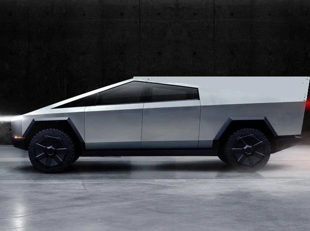

A bed cap that is flat from the peak of the CT roof all the way back would probably help a lot. Something like this:

Exactly. You put my thoughts into form. Good job!

Cybertruck range when towing isn't 'HORRIBLE'. It's about what is expected for the weight. '20 foot trailer' tells us nothing. You need to tell us the weight. A 20-Foot trailer could be carrying/adding a lot of gross weight.
One can't expect to double or nearly triple the weight being transported, and then not expect an appropriate increase in energy required. Laws of physics don't play the games of 'free stuff' or 'something for nothing'.
Towing reduces the range in ICE vehicles too, but the refill is quicker albeit multiples more expensive as well. Yes, heavy load towing range is an Achilles heel for the Cybertruck, but this has been known for some time. I'm not sure emotional labels like 'HORRIBLE' are warranted, because they imply a lack of efficiency or engineering which is just not true with the Cybertruck. I say for the weight it moves, the Cybertruck still does pretty well; why not just show the math and let others be informed?
I have a problem with emotional labels because those are what spreaders of FUD and the MSM use in attempts to gaslight peoples' perceptions.
I think we need a new composite metric for referencing Cybertruck, Tesla Semi, or EV efficiency when vehicles are frequently used for towing - which could be Energy per Distance per unit of Weight, such as the following example:
Watt Hours/Mile/Short-Ton] (Wh/mi/st)
- or -
Watt Hours/Kilometer/Metric-Ton (Wh/km/t)
Using this formula, a sample trailer weight of 7000 lbs (since the OP didn't provide any for his 20 foot trailer) plus 6800 lbs for the Cybertruck, would result in the following for 856 Wh/mi:
856 Wh/mi / ((7000 + 6800 lb)/2000 lb) = 856/6.9 = 124.05 Wh/mi/st or
124 Watt-Hours per Short-Ton-Mile
- or - (Converting to Metric)
531 Wh/km / ((3175 + 3084 kg)/1000 kg) = 531/6.259 = 84.83 Wh/km/t or
85 Watt-Hours per Metric-Ton-Kilometer
(Edited to include estimated 6800 lb weight of the Cybertruck)
If everyone towing with EVs would quantify their energy usage in this way, there would be much more consistent results across various weights towed, and we could truly learn the nature and limitations of our vehicles under certain conditions. Right now everyone is just pointing out how their results are different than not towing at all, but that doesn't tell us anything useful relative to the extra weight they've added to move.
But seriously, why use a label like 'HORRIBLE' while not using mathematical context or even providing weight towed? Let's try to better than the MSM shall we? - because the MSM already has a monopoly on attempts to gaslight people.
