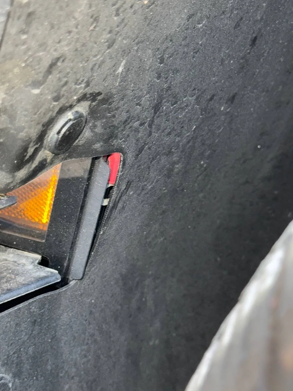

I saw this sticking out. Anybody know what it is for?

Its to Jump start the truck to open the door if your DEAD... lol You tube it a good to know ...

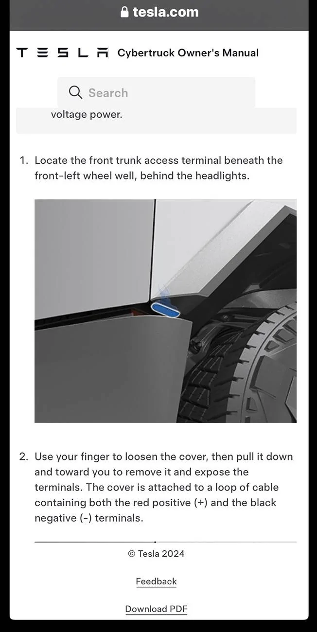

Those leads are only for opening the frunk to get to the jump posts. Neither location is directly connected to the 48V battery. You can use a power source that provides between 9V and 16.5V (such as a 12V portable jump starter or another vehicle), or a power source that provides between 30V and 50V.
Frunk popping leads:
https://www.tesla.com/ownersmanual/cybertruck/en_us/GUID-4EC0FD18-0503-40FD-8C97-0F6BB39DA79D.html
Jump posts:
https://www.tesla.com/ownersmanual/cybertruck/en_us/GUID-2C9FAB79-5A7B-40BB-B572-D10CDF7661E6.html
