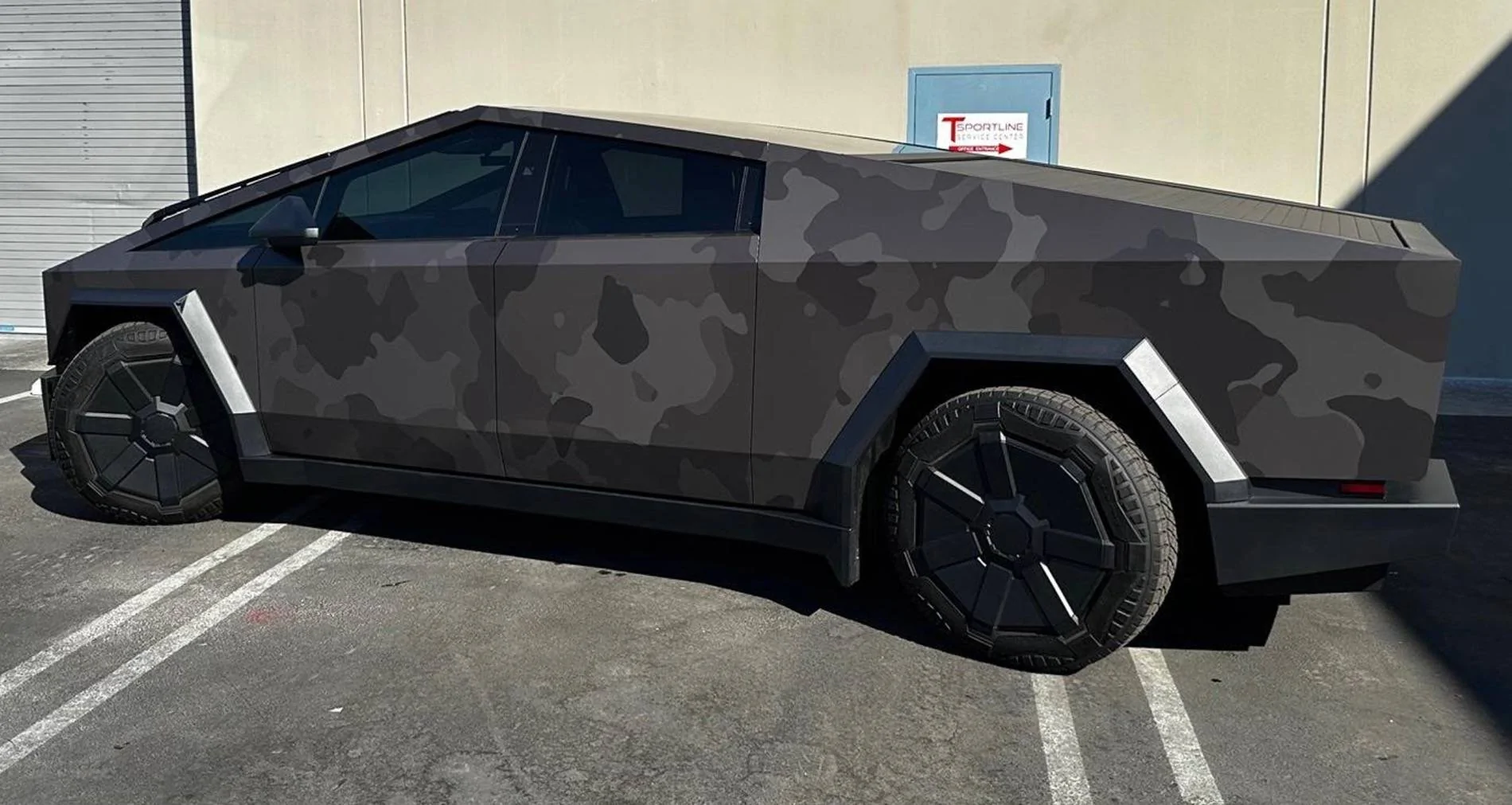

If only someone could manufacture a decent looking camo wrap in PPF.
That'd be technically possible, but not optimal with current manufacturing processes. Let me explain...

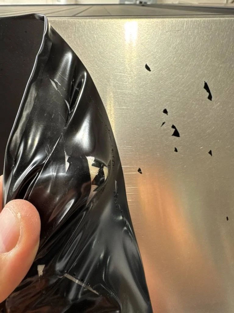

There are basically 3 popular ways to manufacture color PPF - color infused, co-extruded and laminated.
Color infused (TWRAPS, STEK, XPEL) - in this process, the TPU resins are mixed with color pigments and whatever else goes in there (like the specs that make it look pearlescent or metallic for example). Then the whole thing is extruded and coated, but the color is part of the actual PPF. This gives superior color depth and longevity.
Co-extruded - in this process, the TPU base and the color are being extruded & fused together as they are being extruded. This performs great at stretching but you can't really do patterns. This approach gives you the same longevity as color infused but it may not give the same depth of color for some colors.
Laminated (UPPF, Inozetek etc) - in this process, you have the base TPU PPF (transparent) extruded into clear PPF which is then coated with glue and the color laminate (similar to vinyl) is added to it. The PPF and the color are essentially glued together. With this approach you can theoretically do more stuff like patterns like that but laminated PPF performs poorly when stretched and carriers a risk of delamination over time. This is generally a lower quality PPF that neither has longevity nor depth.
Here is an example of laminated PPF being removed...notice how the color particles remained on the truck. That's the reason we don't do laminated :)
