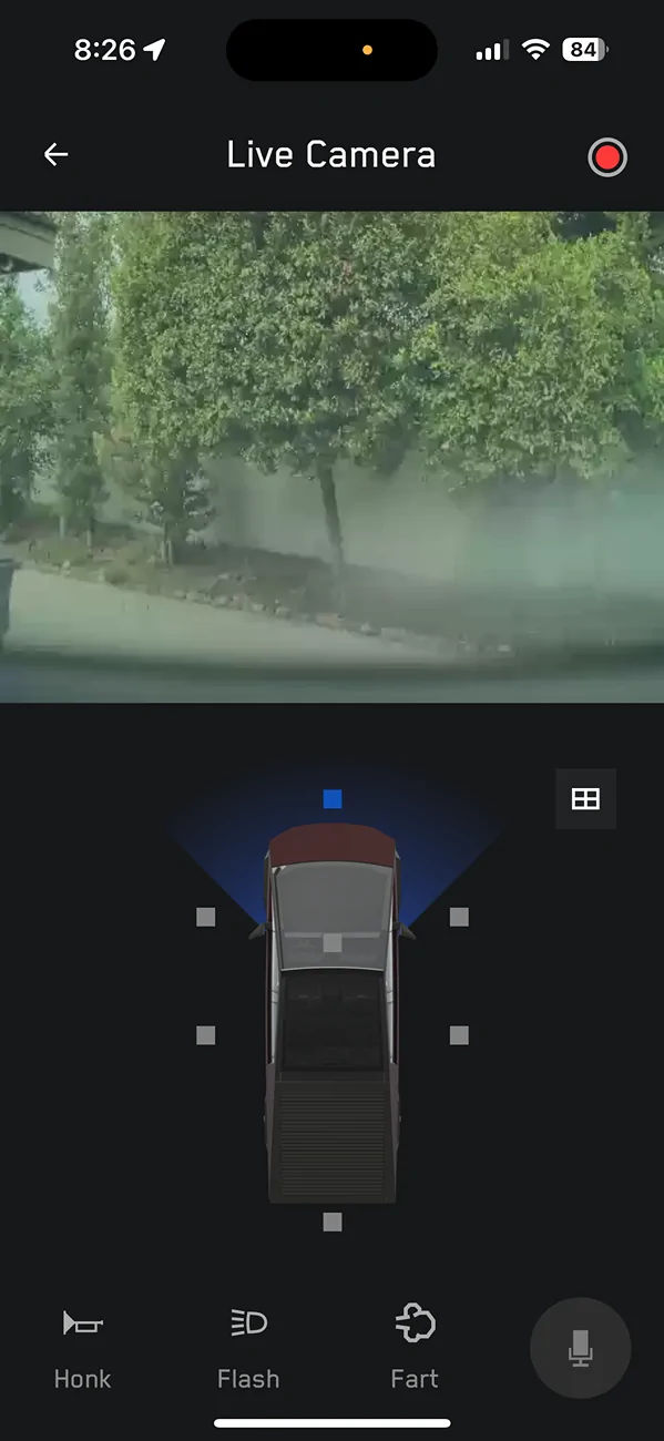

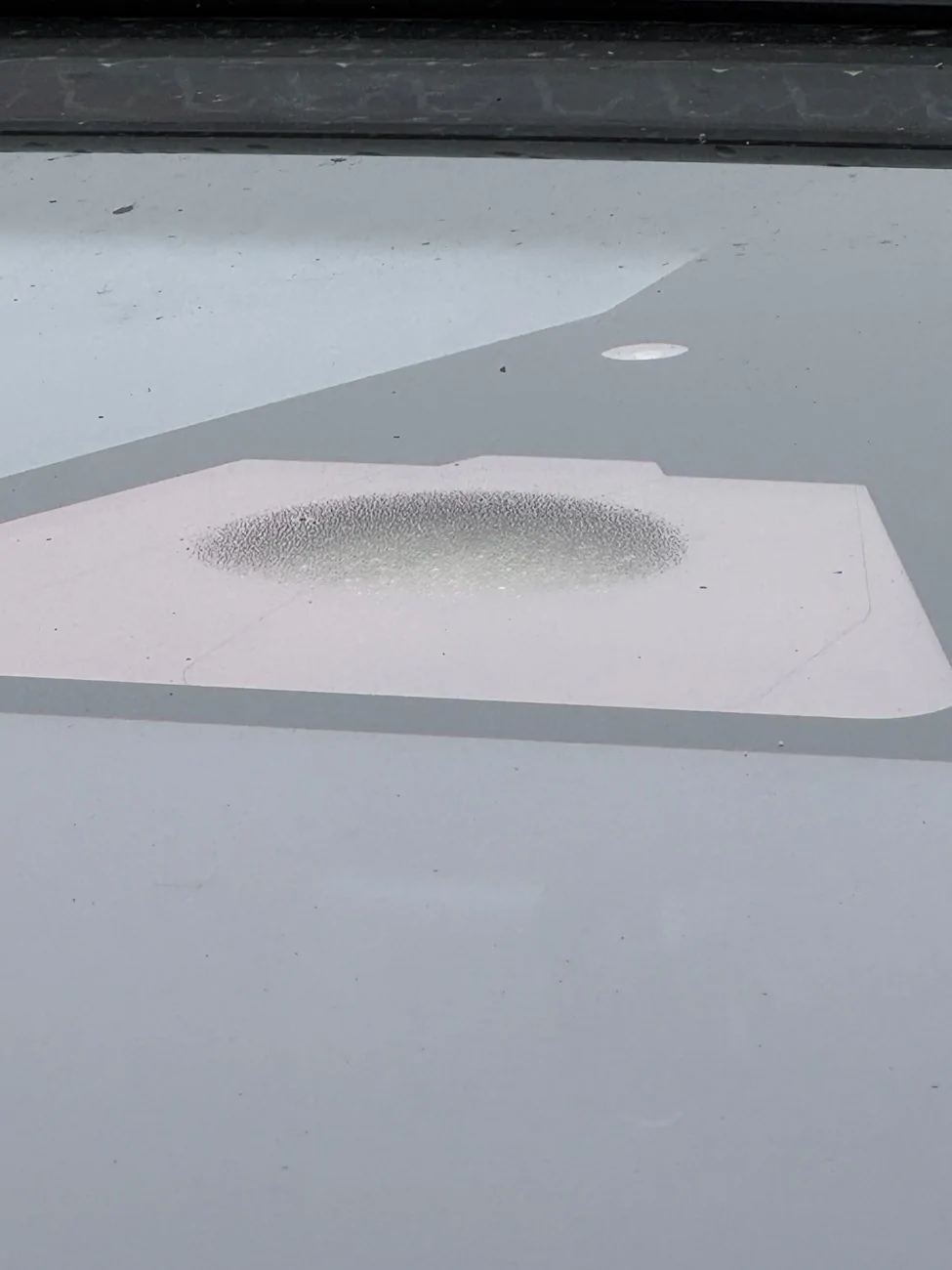

While taking out the trash this morning I noticed this condensation on the windshield right in front of the of the front camera. I wonder if this might contribute to the wipes - not only the condensation itself but perhaps accumulated dirt there? You wouldn’t be able to see the condensation or the accumulated dirt from the inside. Just spitballing.
Tesla Cybertruck Damn BA Wiper wipes IMG_2907
It does obscure the front sentry view
Wonder if throwing a desiccator in there would help.

I pretty sure the condensation is on the outside of the truck. At least I sure hope it is. If there were something to prevent the fogging due to outgassing, that would be helpful (on the inside of the truck).

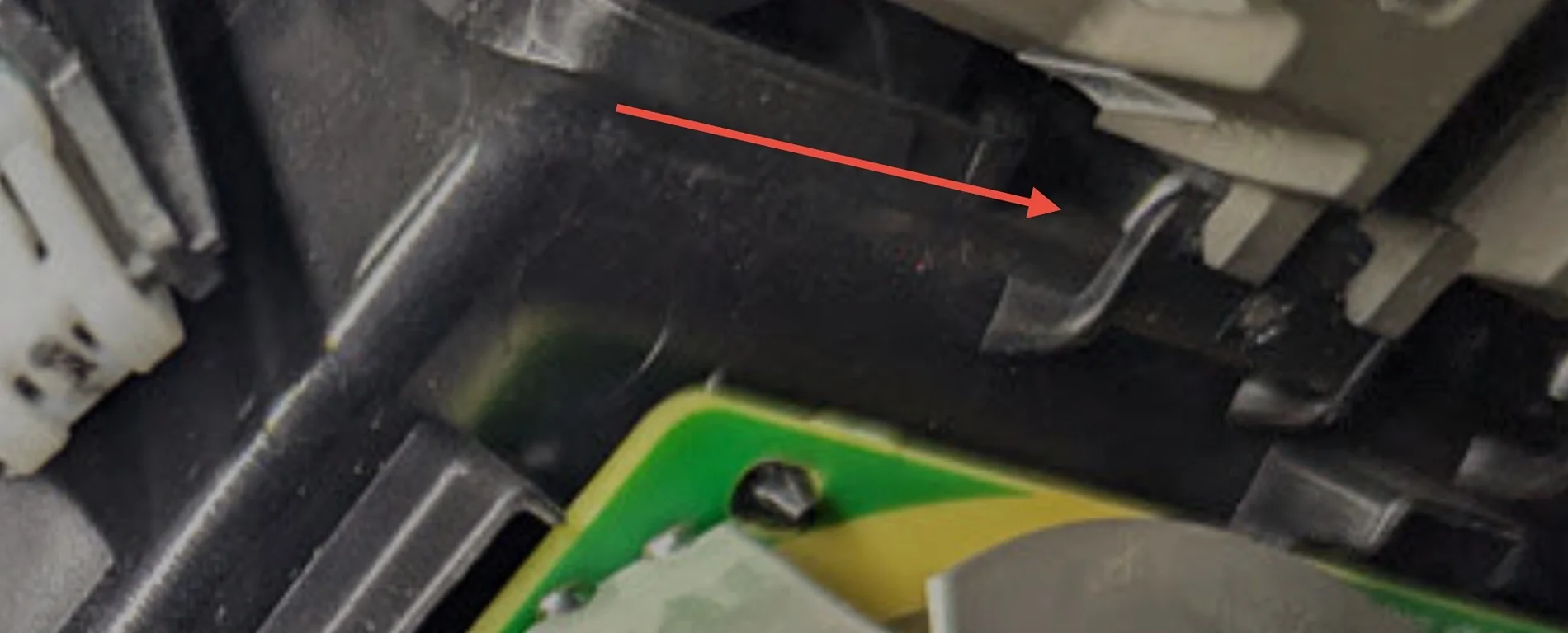

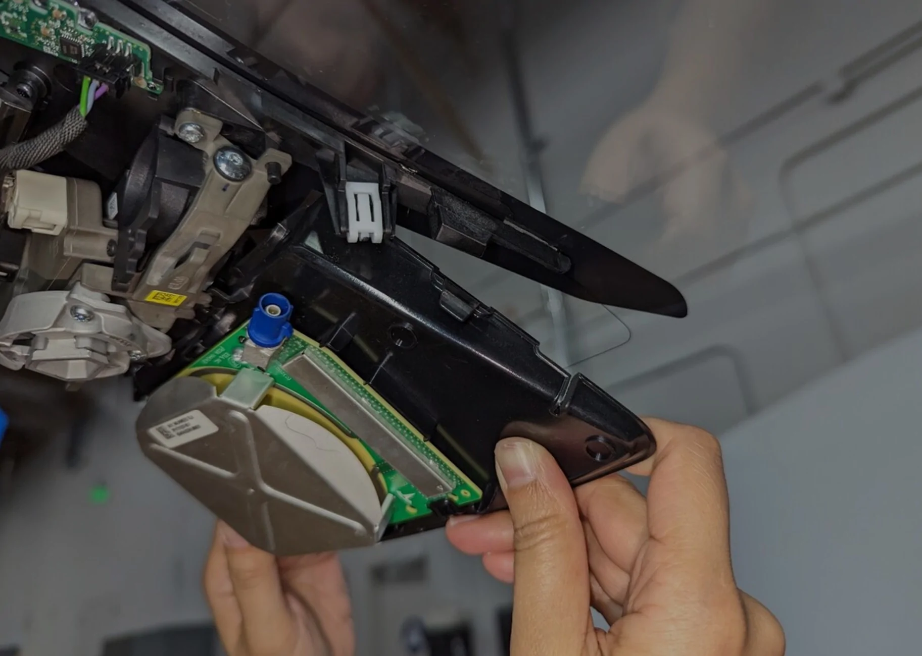

The glare shield least on the foundation is fairly brittle plastic if anyone attempts to clean this themselves. Having a Hansshow mirror I didn't want to mess with a Service Center on this.
Putting the glare shield back in I took my time. Still managed to see both tabs fall on the floor board and as I removed it the back little hinge tabs they have were starting to break.
Tip: Do not use super glue - even more off-gassing and its not worth it.. I temp put mine up with some UV Tape until I can get a replacement part in, but this is like $48 shipped.
I feel like this needs a little redesign to make it more serviceable or switch plastics so its not so fragile.

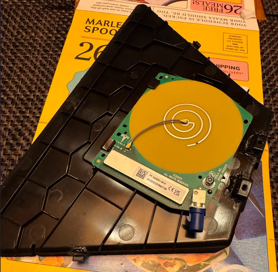

Per service manual -(Mine does not look like this)
Tesla Cybertruck Damn BA Wiper wipes 1757351658222-bj
Then mine
Tesla Cybertruck Damn BA Wiper wipes 1757351897789-iv
Least to me, the back little hinge deals should just be a plastic fin that goes into a lip or something. They are super prone to cracking. The 2 tabs in the front didn't even survive putting it back up and it's not like I was muscling it around.

I got my new Glare Shield in and went super slow putting it in and had success.
Glass is clear, no dry wipe, or glare alerts so far.
