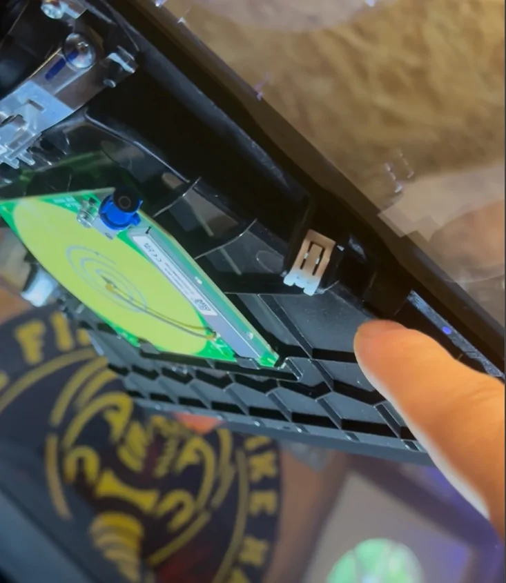

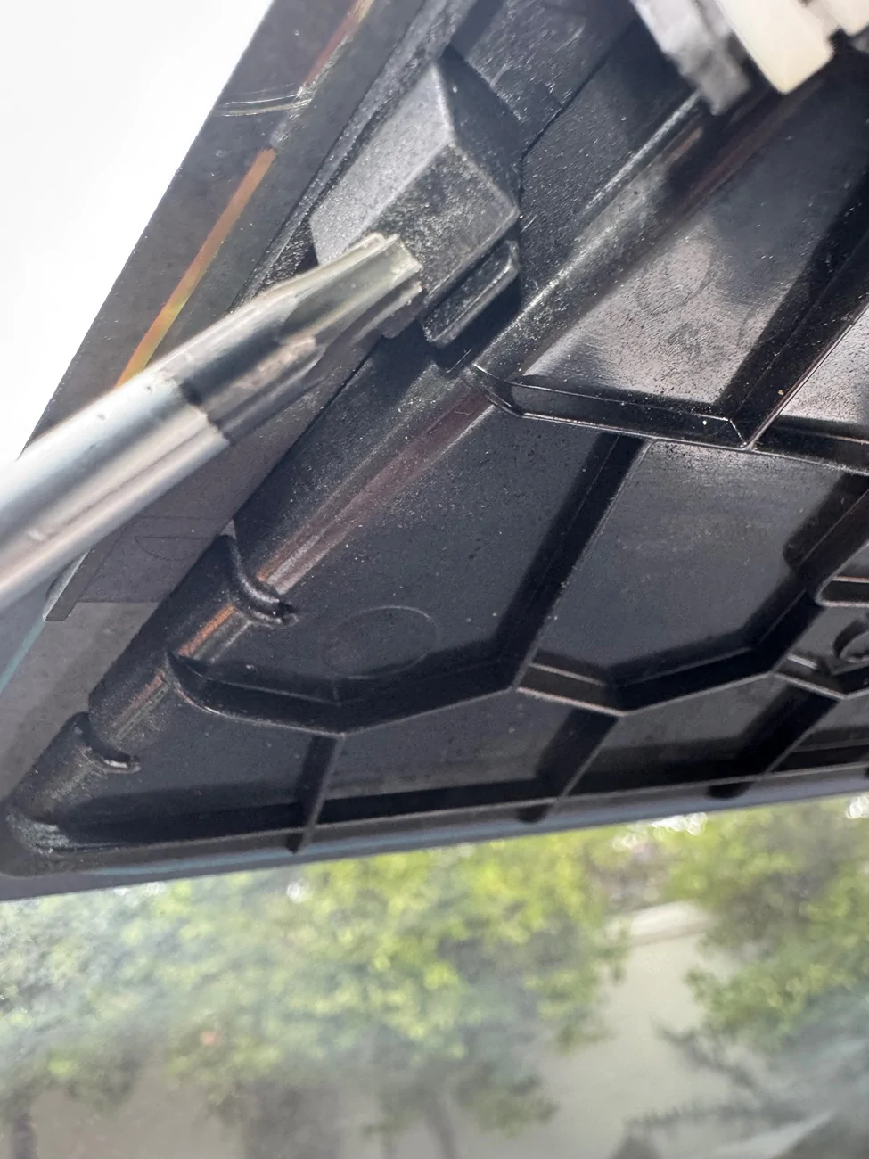

This is the bit of plastic with the GPS unit mounted to it. 2 Tabs on the side and then this funny hinge thing in the back. Its whats surrounding the cameras the front and has a matte texture to cut glare.
I had to remove this to clean the glass the cameras look out. Off-gassing (fog/haze) from plastics common issue. If you can pull it without breaking anything you're ahead of the game. Its very fragile and just go super slow.

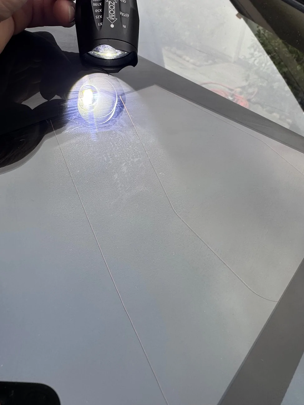

I was doing the same thing Most the time it stayed off, but finally broke down after getting UI alerts for glare. You can take a LED light and shine it in the front cam housing to see how cloudy it is. But a good cleaning fixed it. Just sucks to get to even if you don’t have an after market rearview mirror.

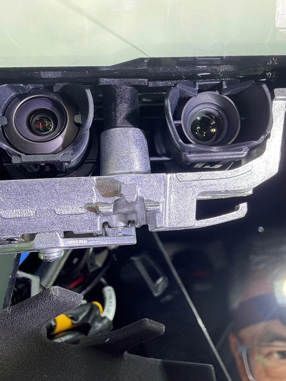

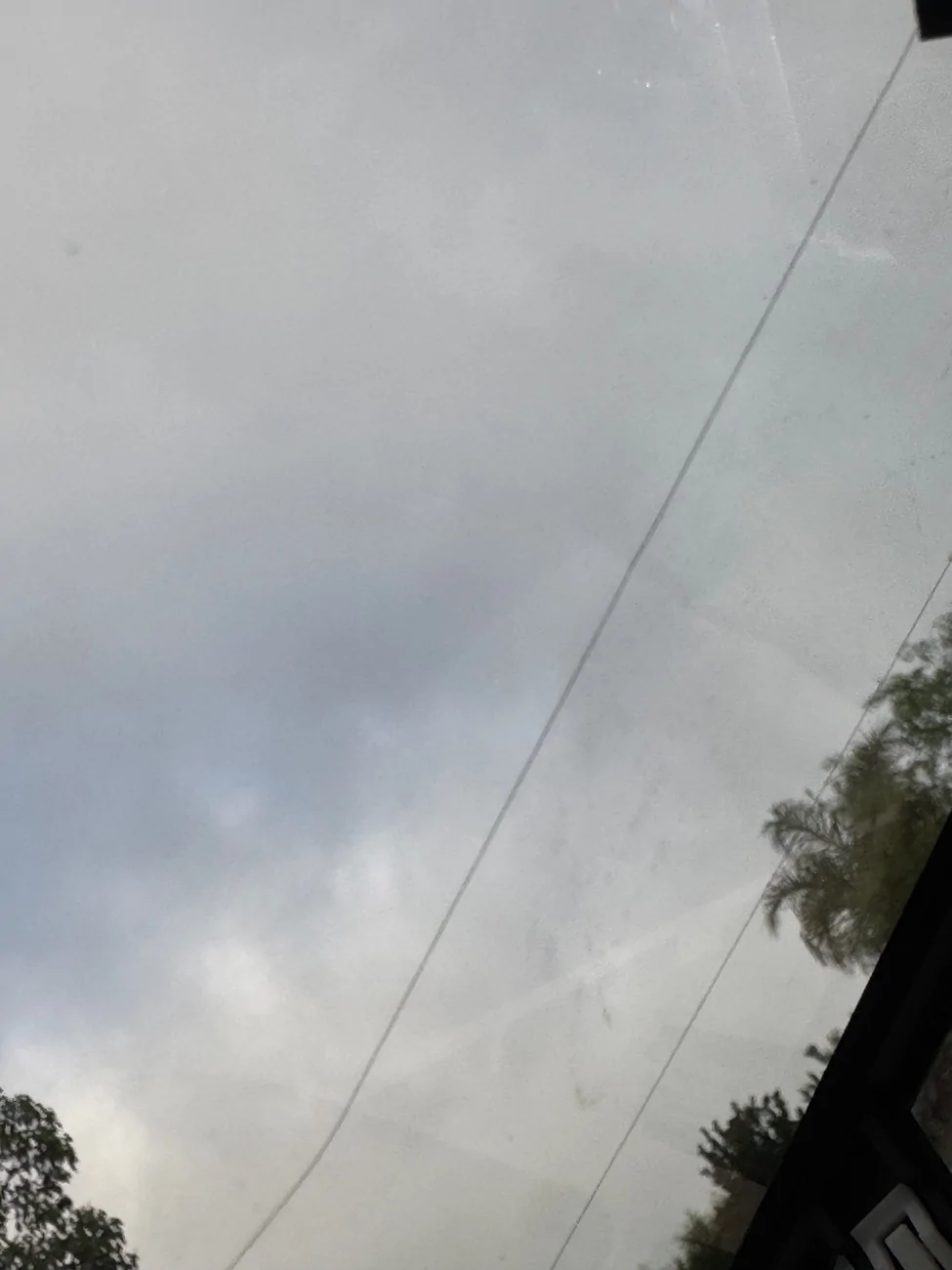

Ok. I did the thorough cleaning of the window beneath the glare shield. Once again, it’s pretty easy to do if you don’t have the Hansshow digital mirror. It’s a bit of a pain if you do. The window has never been cleaner. I will follow up with the dry wipe anecdotal data. As a reminder, I’ve cleaned the window a week or so back but had noticed I didn’t do a great job and thus elected to redo the cleaning. Even so, no dry wipes since I did the initial cleaning.
Tesla Cybertruck Damn BA Wiper wipes IMG_2925
these smears are on the inside, beneath the glare shield

Hard to show but there when seen from the inside , in the right lighting, you could imagine that FSD might think the windshield needed cleaning - especially if it has never been cleaned

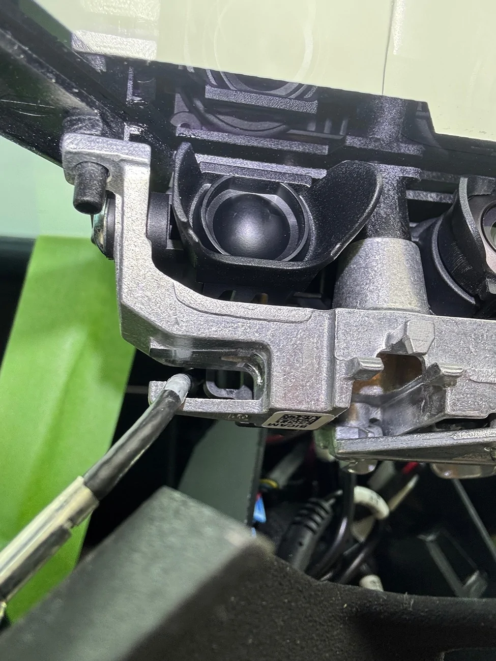

Tabs to release the glare shield, one on each side - push them inwards
A view of the little hook at the back the glare shield
The camera lenses look pretty clean, I blew them off with air

Great shots - yeah least my ride yesterday was event free. I used isopropyl alcohol and a lint free towel.

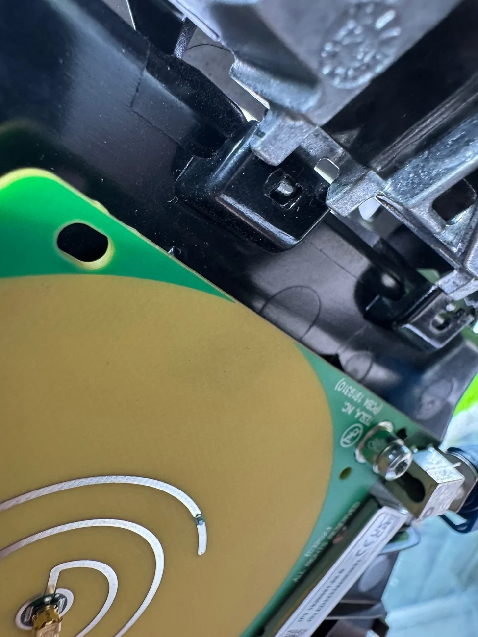

Tip: the glare-shield plastic is stiff and brittle. I broke a tab by pressing the shield back in without pushing in on the tabs to relieve the stress.
I found that once I could line up the rear by coming in and a angle it folder up then snapped in but I told the mobile tech "these feel like single use and won't survive after some time". I recorded this after I got my replacement which I ordered from the epc.tesla.com site. Just went extra soft on the tabs but my original one they just both fell out of the mount area at the same time, and my rear hinge/tab deals had separated.

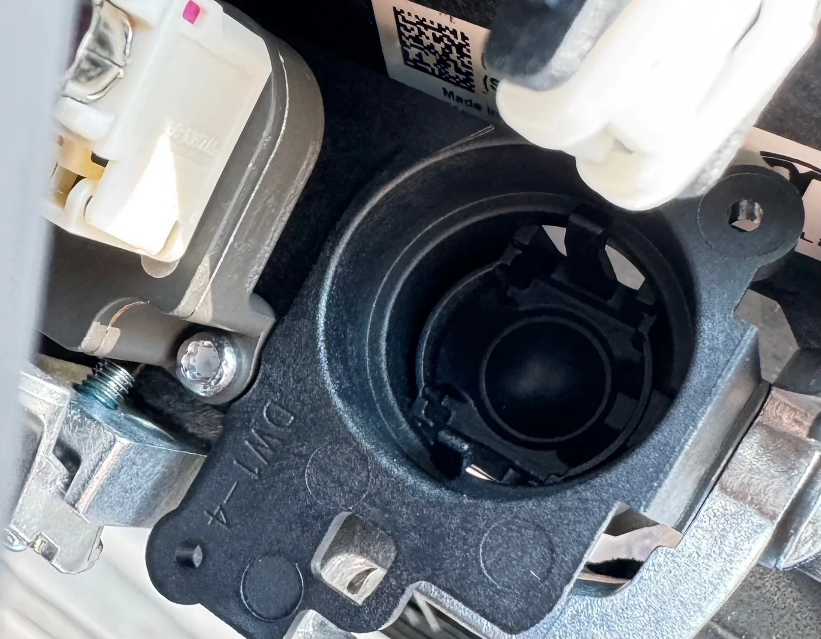

I don’t know what this is… it doesn’t have a clear lens and the surface is unusual if you look closely so I left it alone
Tesla Cybertruck Damn BA Wiper wipes {filename}
That’s a dummy insert, which you can clearly see from the back:
Tesla Cybertruck Damn BA Wiper wipes IMG_1506
I guess that’s where the LiDAR was going 🤪
