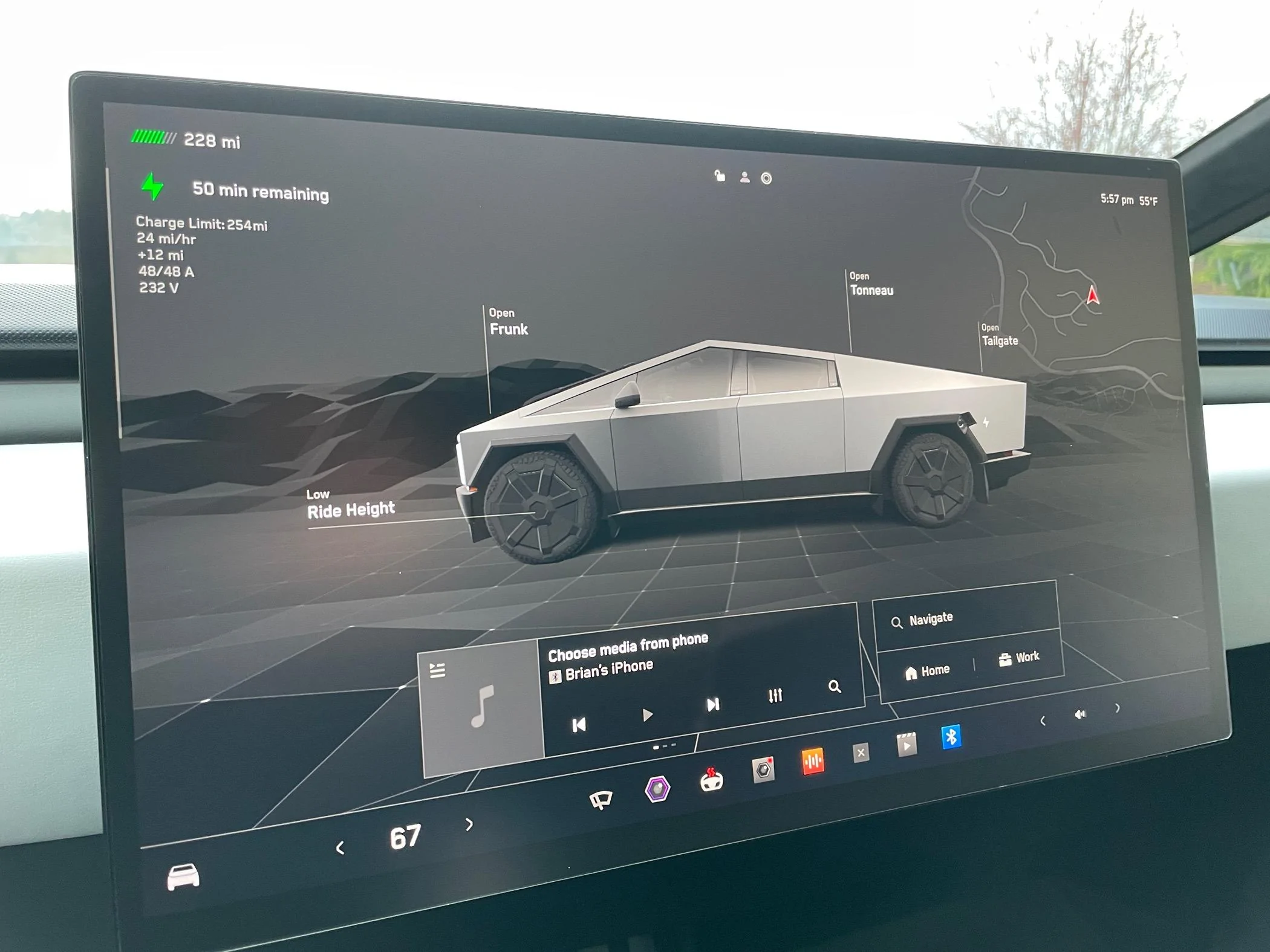

The matte screen protector does it dull the sharpness of the screen at all ? is it a lot dimer ?
which one did you buy ?
I bought the one from Twraps. I’ll need more time to fully evaluate, but initially it turned out great. I installed later in the day so will inspect closer for any air bubbles this afternoon.

so you cant really tell that the screen is duller or dimer ? it looks pretty much the same from a picture. i dont like glossy so really curious how matte looks.
It looked great to me with brightness on auto. However, I would like to manually adjust brightness to lower levels just to see how it performs.
I also have the matte on our model Y https://www.amazon.com/gp/product/B084BNC3FG/ref=ppx_yo_dt_b_search_asin_title?ie=UTF8&psc=1 and it works great. It's amazing how much it reduces glare and finger prints. Would love to see Twraps include an installation aide like Spigen as that make install a breeze.

is the twraps one plastic or tempered glass like the spigen ?
