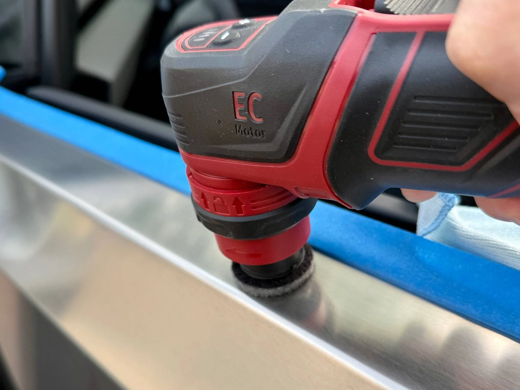

You'd really have to work that panel w/ higher grit pads and polish to do that. The 7448 is about 800 grit. The only thing you'll notice is the panel will be a bit brighter, but will eventually dull out.
You can see from the previous response picture, I used 7448 on a section near the driver door window trim, it has the same factory burnished look after a few passes.

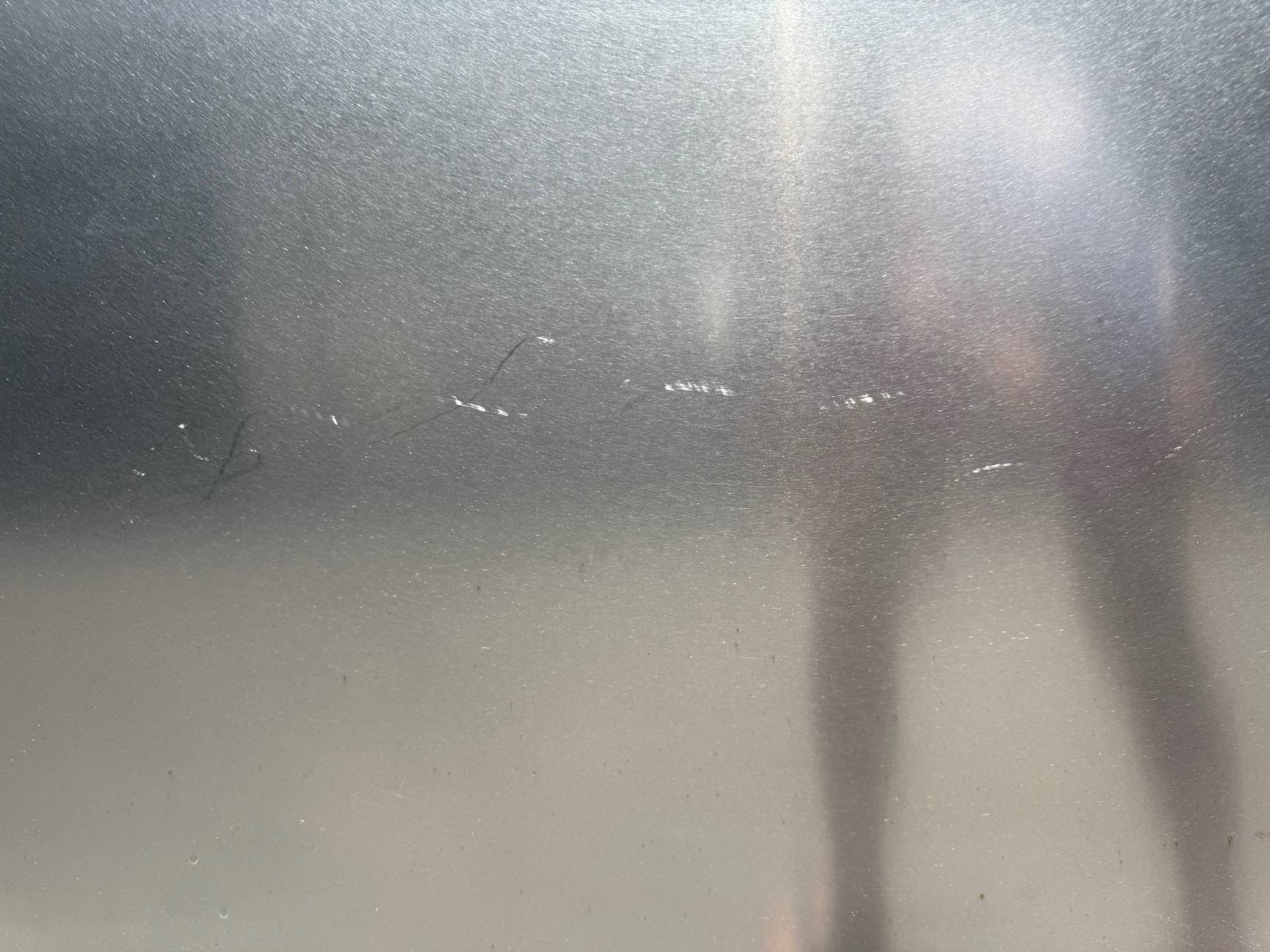

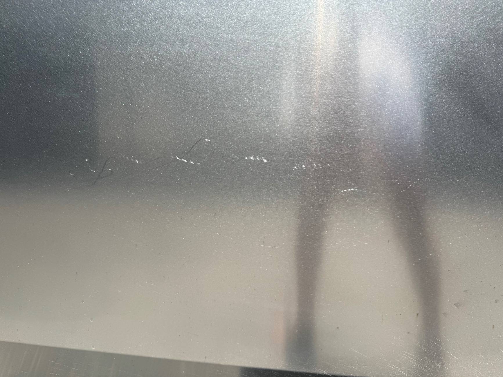

It's not hard to do, just have to have the right tools and scouring discs.
3m 7447 Very Fine 5"
3m 7448 Ultra Fine 5"
Dewalt 5" random orbital sander (corded or cordless) or whatever is available to you
Blue Masking Tape (mask off the plastic fenders to prevent scuffing)
Start with the 7448 on the scratched areas to see if it removes the scratches and then follow the recommended pattern from the Tesla Service Manual on refinishing the Cybertruck. If 7448 doesn't remove the scratches, then go to 7447 and then back to 7448 to add appropriate levels of burnish to the stainless steel surface.
The area will be lighter, but will eventually darken. I removed some superficial scratches on the driver side door panels w/ success. Also, made some custom 1.5" 3m scouring discs to refinish the smaller areas near the window trim.
Check out the YouTube video on how the panels are refinished.

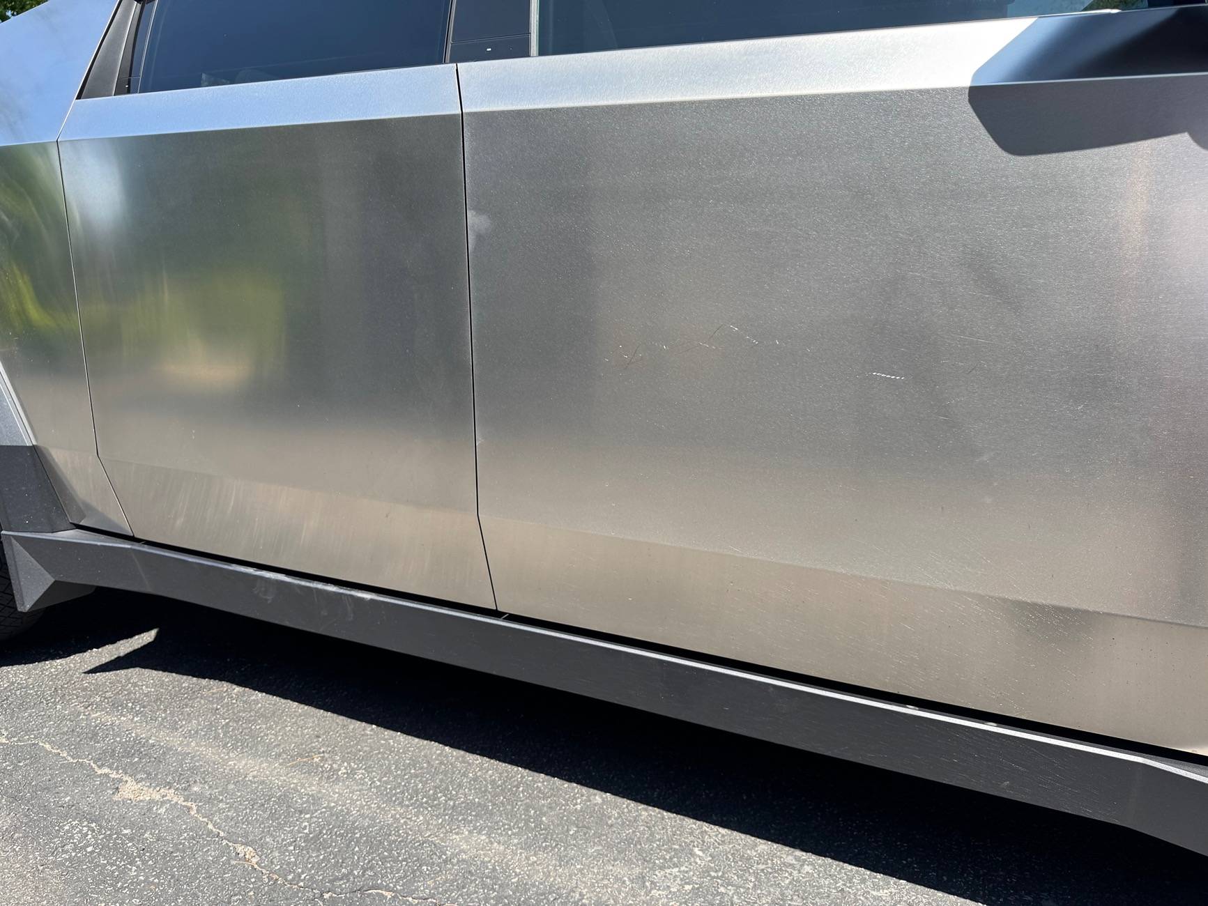

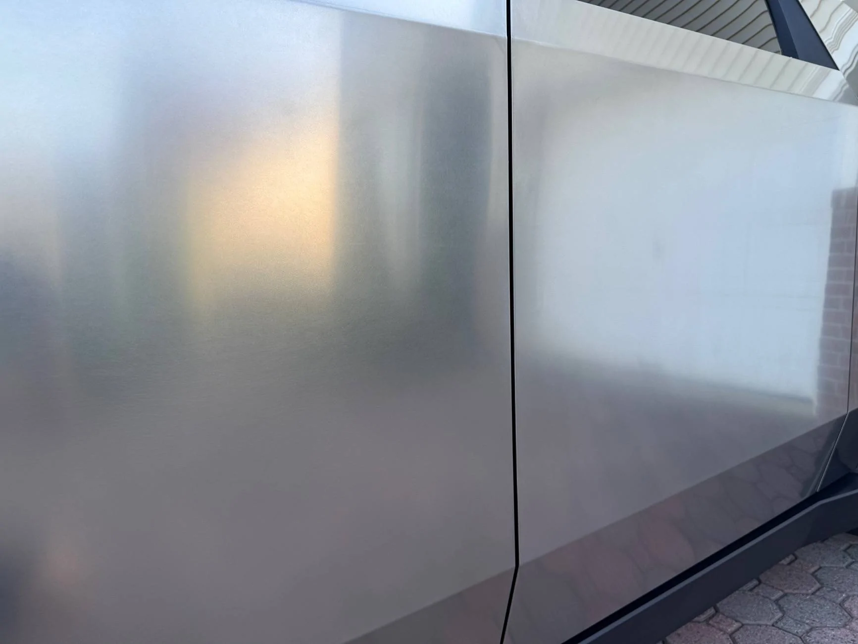

How’d it go? Here’s what mine looked like after.
