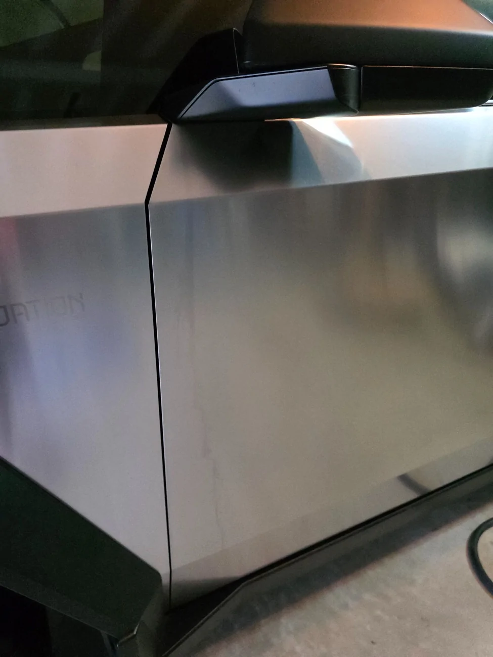

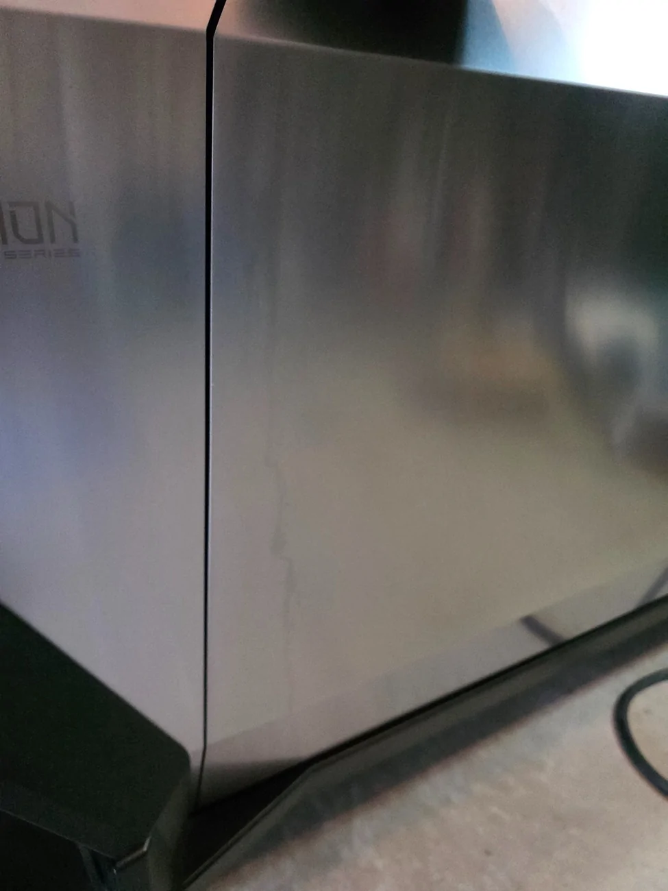

Citrisurf 77 does as it states. But be careful, like me; make sure even when you rinse that you use lots of water around your mirrors and tail light. I believed I did a good job but my morning there were 3 discoloration runs from each area.
I called Citrisurf for technical advice and they suggested Barkeeper soft cleanser or have a layer removed.
I have tried Barkeeps spray; no change. Next will use Barkeepers soft cleanser.
