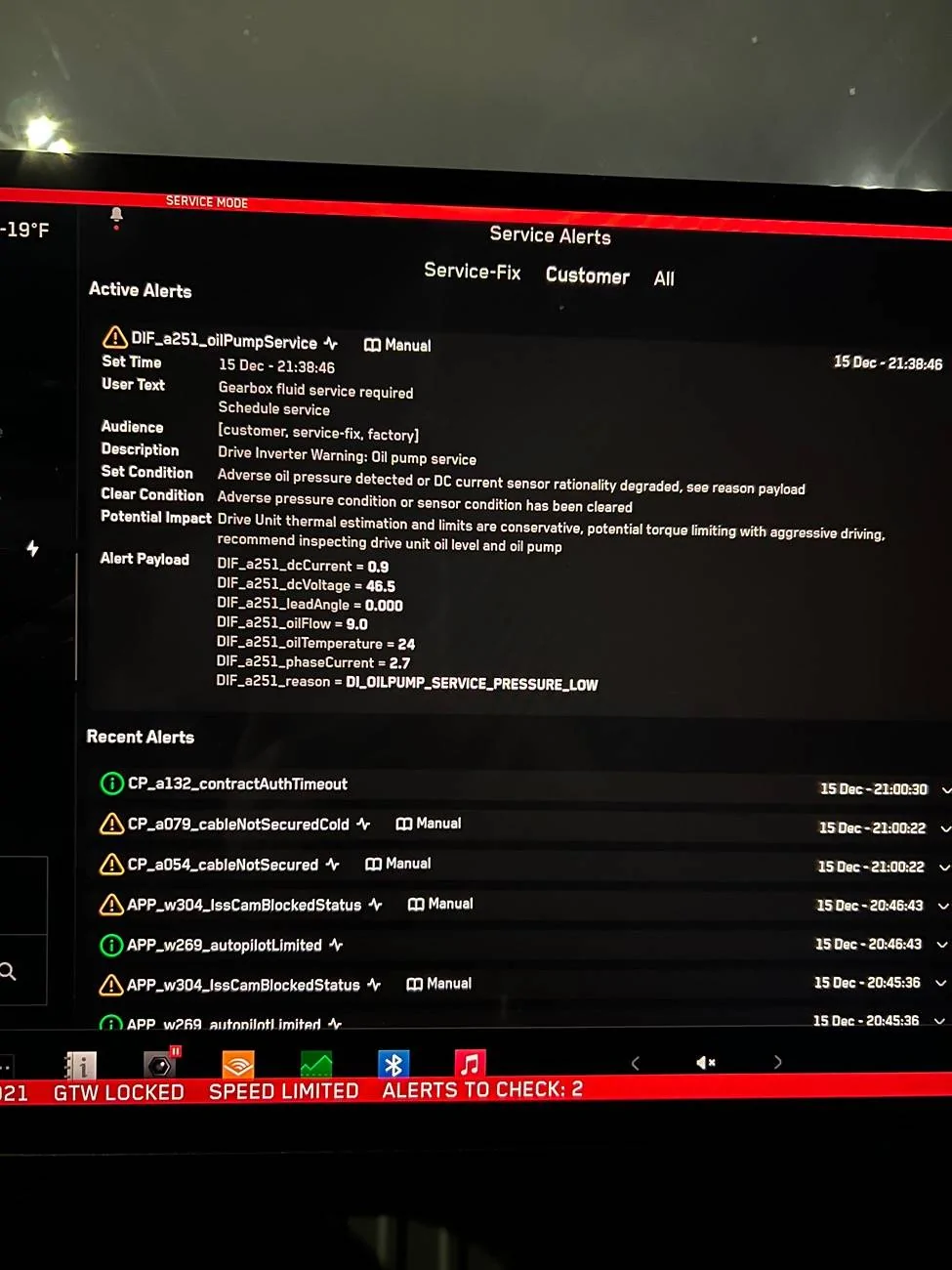

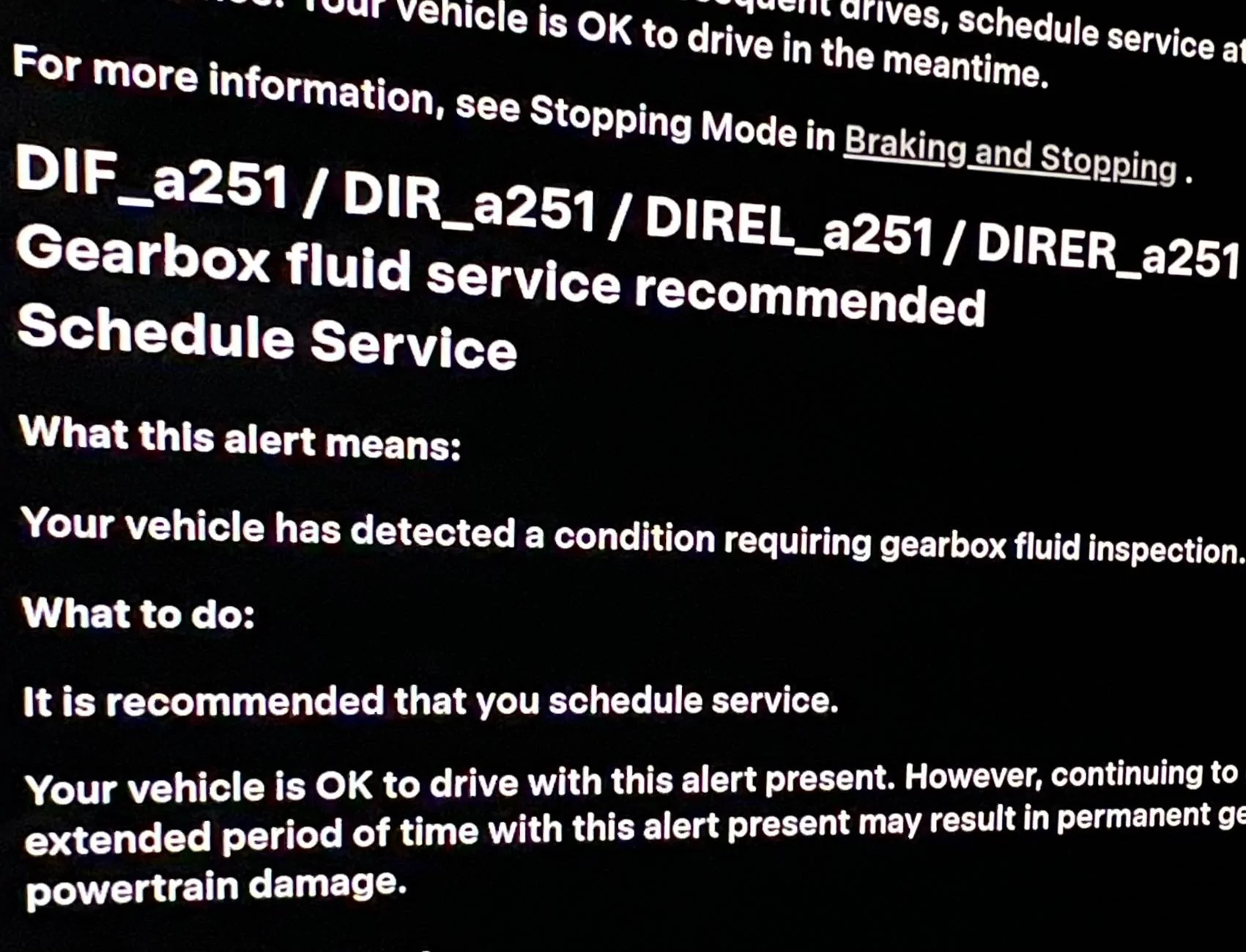

I was driving in minus ➖ 20f temps and started a 50kw fast charge about 30 minutes into charge I noticed this notification ?
I drove home after charge 2 miles, still on screen. Started a service request, really hoping for a mobile technician as my SC is 360 mile travel.
Which is how I got it home but I haven’t even made my first payment and having to loose money or time traveling is not really helping me love Tesla

Service texted back today, firmware issue reading oil below 0 celcius, will release a patch in the future. Safe to drive and removed the notification from my CT.

Hearing many with similar reports driving in cold conditions.
