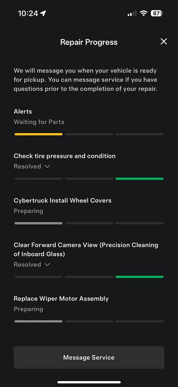

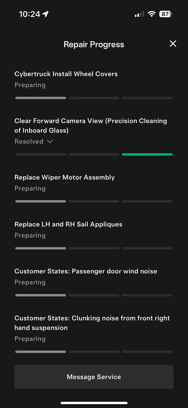

Are they replacing the front drive unit because of the clunking sound you were hearing, or because of the gearbox fluid error? Does replacing the front drive unit kill two birds?
Great questions. I’m not sure yet. I haven’t gotten the rundown from the tech.
The “Waiting for parts” status looks to be related to gearbox fluid service alert in the repair status menu. The clucking issue still shows “preparing”.

Well, they still have it. I stopped by the shop today to grab a few things out of it. Parts are in and they said they’ll be done with it tomorrow.
He said that they are rwplacing the motor due to the clunking sound, not the gearbox fluid service error. They have an upgraded motor because they had issues with the originals.
