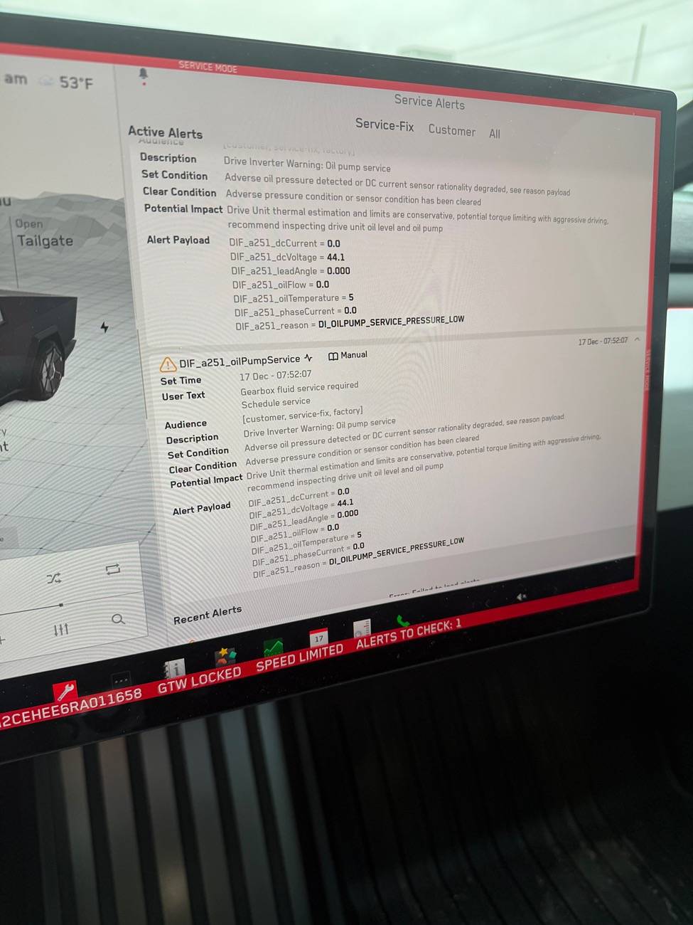

Well - I had a service appt scheduled for the 16th and they are going to take a look at it. They said mobile service wasn't an option. I had my fingers crossed it was just software, but after a 5 or 10 min drive my front drive unit temp is significantly higher than rear so I fear I might actually have a leak or something. We'll see. Super bummed because was supposed to take the truck on a 3 hour drive (one way) this weekend and don't think that'll be happening now.

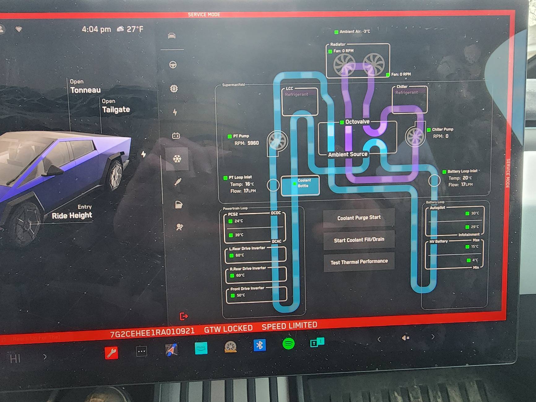

The motor temperature rise may be due to it being used to heat the pack.
My beast uses the rear induction motors for heat. You have AWD I believe, so the front is induction. Thermal path is rear, front, pack.
It's still in the green, so I wouldn't worry. If you go into the service mode and pull up thermal -> coolant you can see exact temps.

Yeah, this is what Beast looks like after 8 minutes in Supercharger preconditioning mode without actually driving. 60C rear, 50C front to get fluid to 20C when its -3C outside.

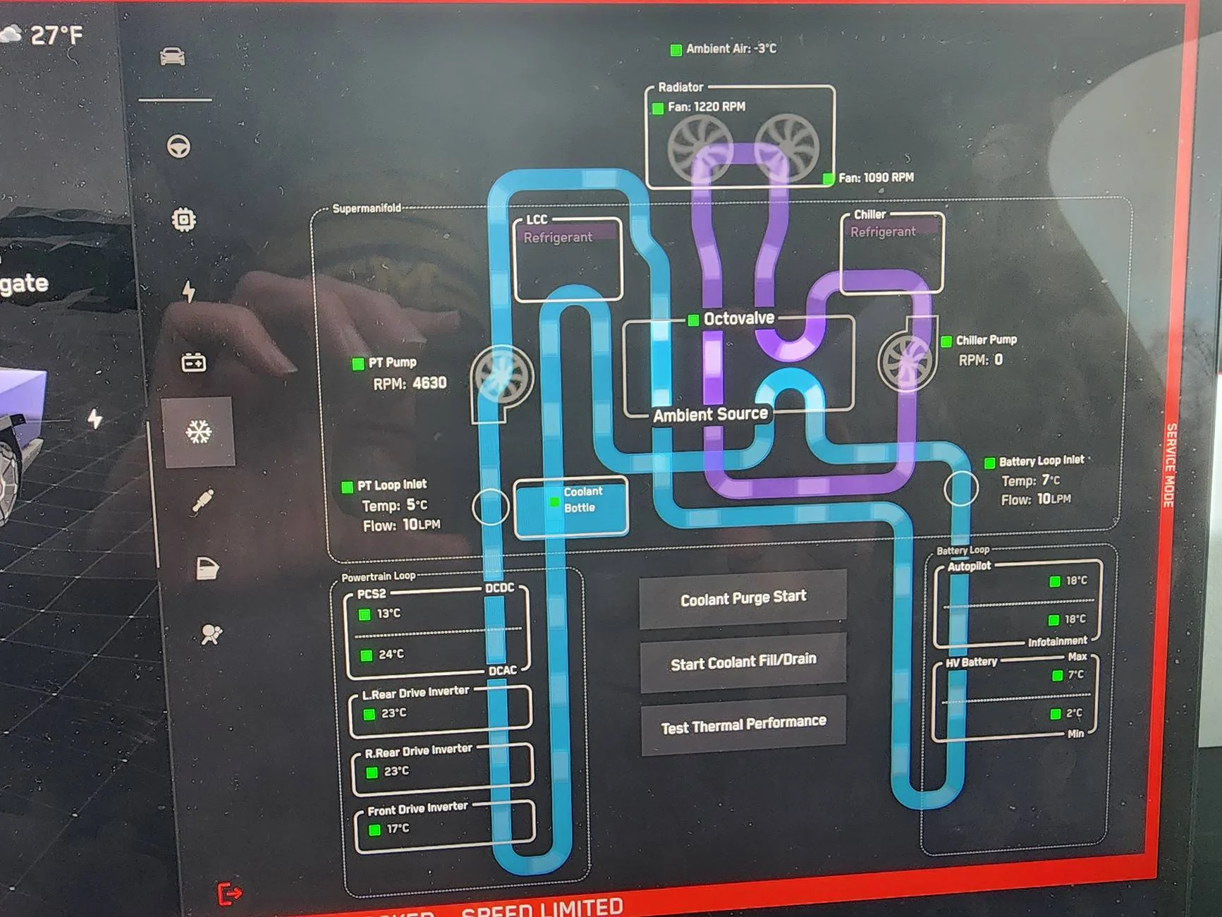

Just climate on max defrost:

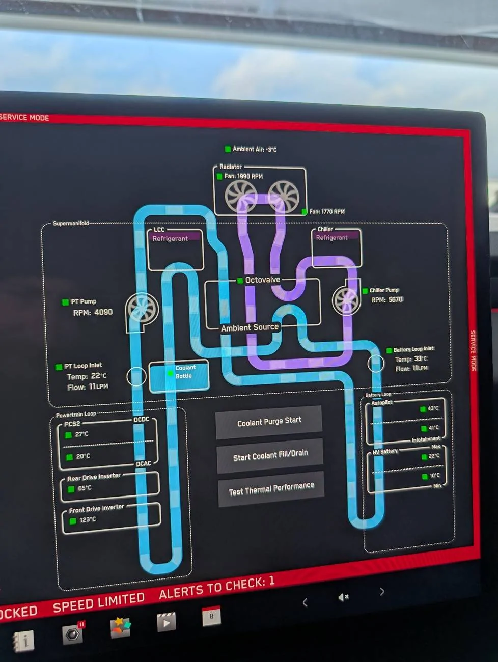

Just did that same 8 min test...was up to 130C on front unit right when I opened it. Seems toasty...and double the rear unit. Lot higher delta between the two that what yours showed, but mine did get the coolant loop up to 33.

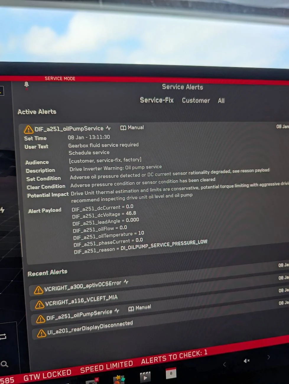

This is from when they told me I needed a new oil pump if that helps
That's incredibly helpful. And unfortunate. Ha! Not looking good for me as mine looks very similar to yours.
Woah, that's seems toasty!
Depending where the sensors are it might have an oil issue or air bubble. (Or could be sensor itself, need to let it cold soak to check baseline)

I received an update from the SC today… they have ordered and are replacing the front drive unit. It will be a couple days.
