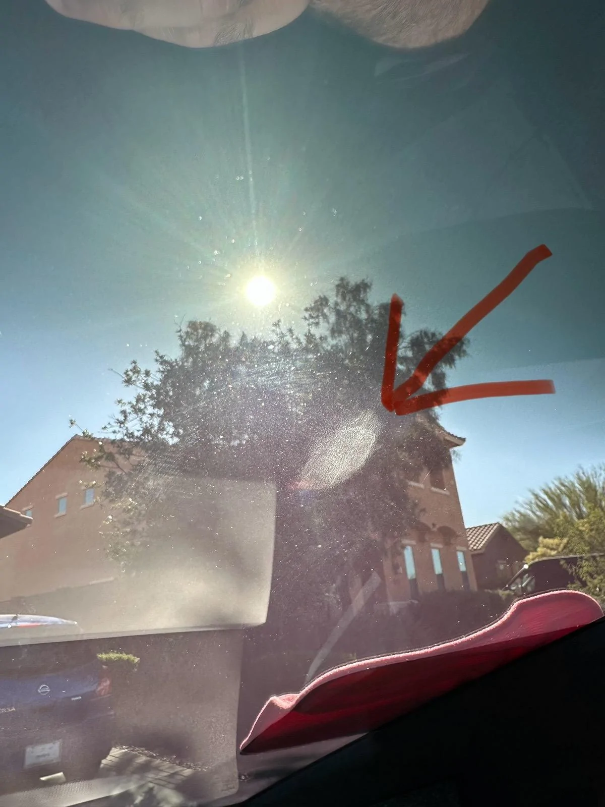

Have a question if this has happened to anyone else with a Cybertruck.
On delivery the windshield was pretty cloudy, when we drove away into the setting sun, I could barely see out of it.
I tried to clean it at home several times with water, spray away, alcohol, and it’s not really working, better but the cloudiness just smears. It’s off gassing, just can’t get it clean.
Took it to a professional tint company to have all the windows ceramic tinted, clear on the windshield and roof.
They said they tried for 4hrs and could not get the windshield totally clean.
They used many different products and it’s much better but still just a tad cloudy.
They said wait a month or so and keep trying to clean it and bring it back and they should be able to tint the windshield.
Anyone else have this issue?
Even tried the Windshield Wow
https://windshieldwow.com/products/pro-set
The VOC's off gassing create this window haze. All of the interior bits off gas for a while. It's basically the new car smell.

Here is a car detailers secret I learned about 10 years ago to get glass/mirrors spotless. I keep numerous spray bottles spread around the home and garage to clean glass and mirrors.
-Spray bottle
-70% isopropyl rubbing alcohol (50%)
-Distilled water (50%)
-Waffle weave microfiber towels
Cover dashboard with towels. Spray interior glass thoroughly with mixture. Use towel #1 to clean glass initially. Buff again with towel #2. Your done!
