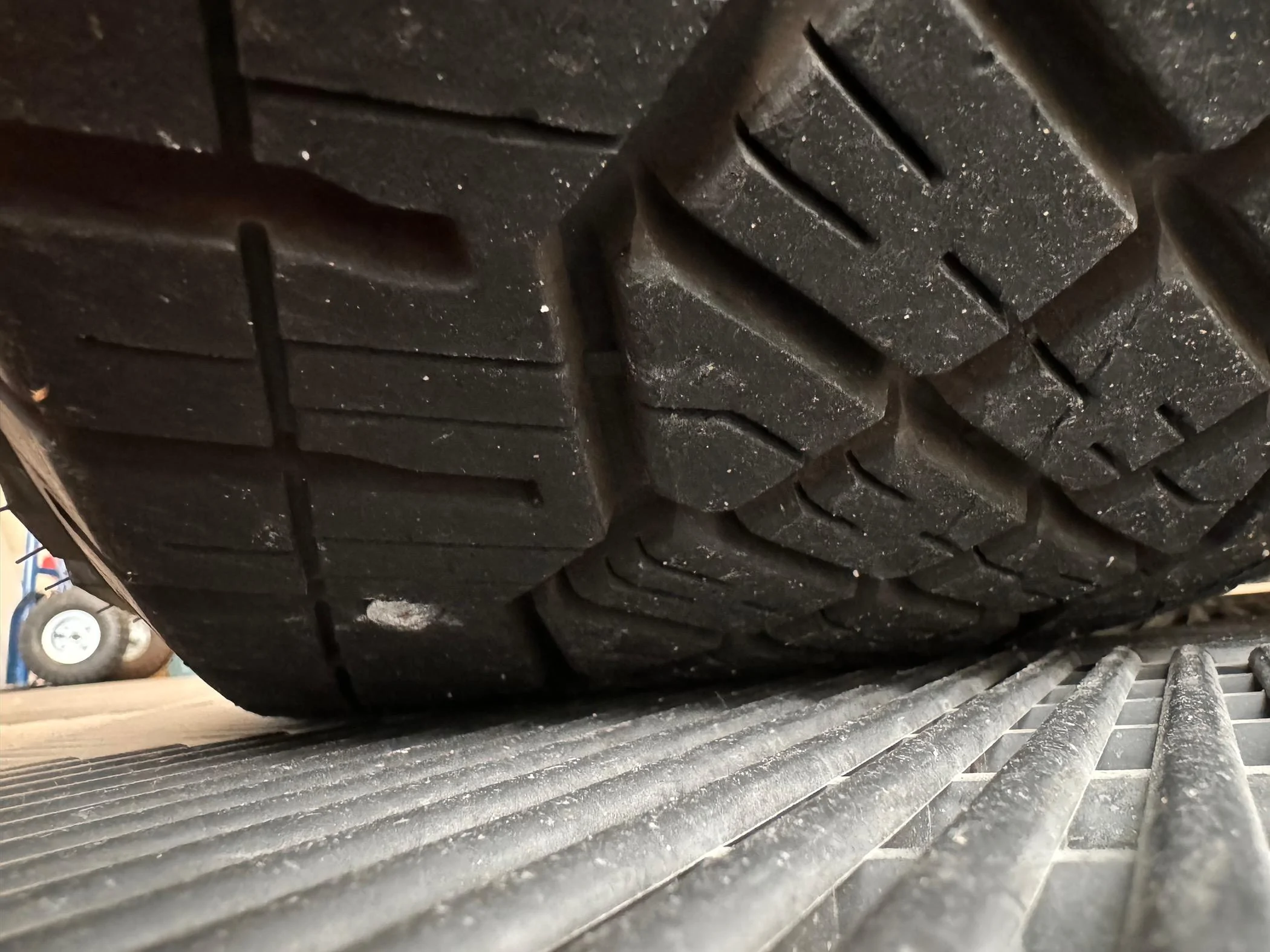

I bought this well-reviewed patch kit:
https://a.co/d/632eXwU
I've already used it, but not on the Cybertruck hahahaha. Plugged a nail puncture well, didn't even need to jack it or remove the tire.
Make sure you have some good pliers and a sharp blade too. The pliers might be needed to remove whatever caused the puncture and it can also be useful for pulling a plug tight after insertion, for special types of repair (like if you have to insert a knotted plug in the center of the cut between two folded plugs). A sharp blade makes it easier to cut the plug(s) flush with the tire surface, which will improve the reliability of the repair.
I can't believe we are in the 2020's and some people still complain about a lack of a spare tire but didn't even think to carry a plug kit and a small tire inflator. A spare tire can only repair one flat, and then you are helpless without a plug kit. Who wants to jack a vehicle anyway, if you don't need to, especially off-road, if you can just poke a plug in there, inflate, and be on your way?
I guess the old saying might be true, "You can't teach an old dog new tricks". But then we have 20-somethings insisting you need to carry spare tires. Probably because their grandpa told them that's how you fix a flat. :rolleyes:
