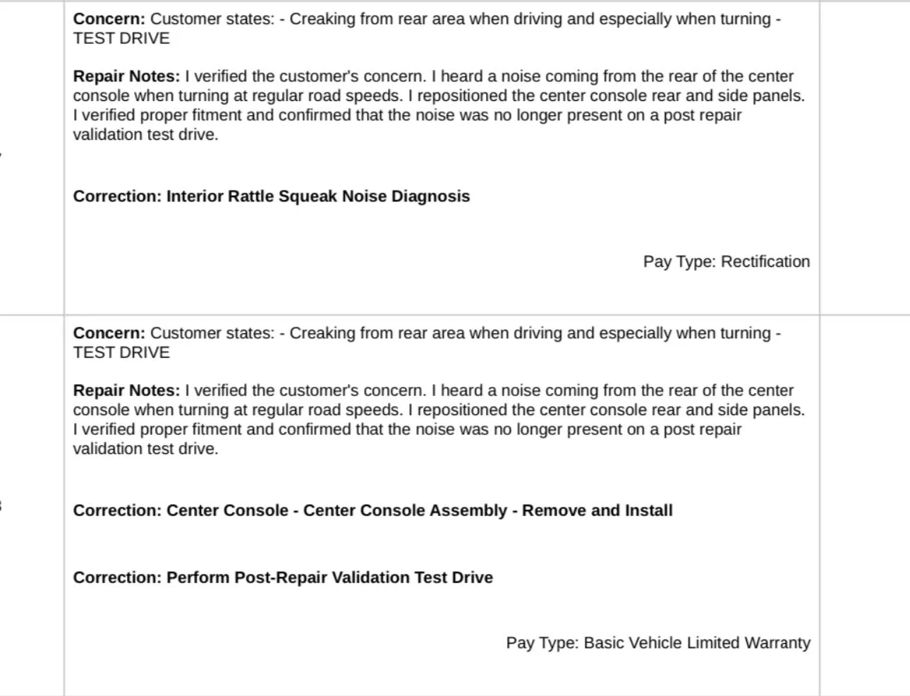

My rear center console had a creaking on the bottom every time I made a turn. It was maddening. Had it fixed last week this is what they did.
Glad to hear they can fix it! Thx for sharing this.

I got mine back from the service center yesterday and the creaking is gone. We'll see if it lasts.
"Squeak was coming from the lower rear trim on the center console assembly, beneath the rear touchscreen. Removed the rear trim piece and applied insulation to the component and its surrounding areas. Resecured the trim piece and performed a post repair validation."

Mine was at service all week for delivery day fixes.
They claimed they fixed the creak in the notes by taking off the panel and re-installing it. By the time I picked up the truck they told me the creak came back...they noticed it when pulling the truck around for pick up. They are ordering me a new panel for the back of the center console.
Went heavier with the foam when I got back home and that will have to hold me over until the next service visit.
