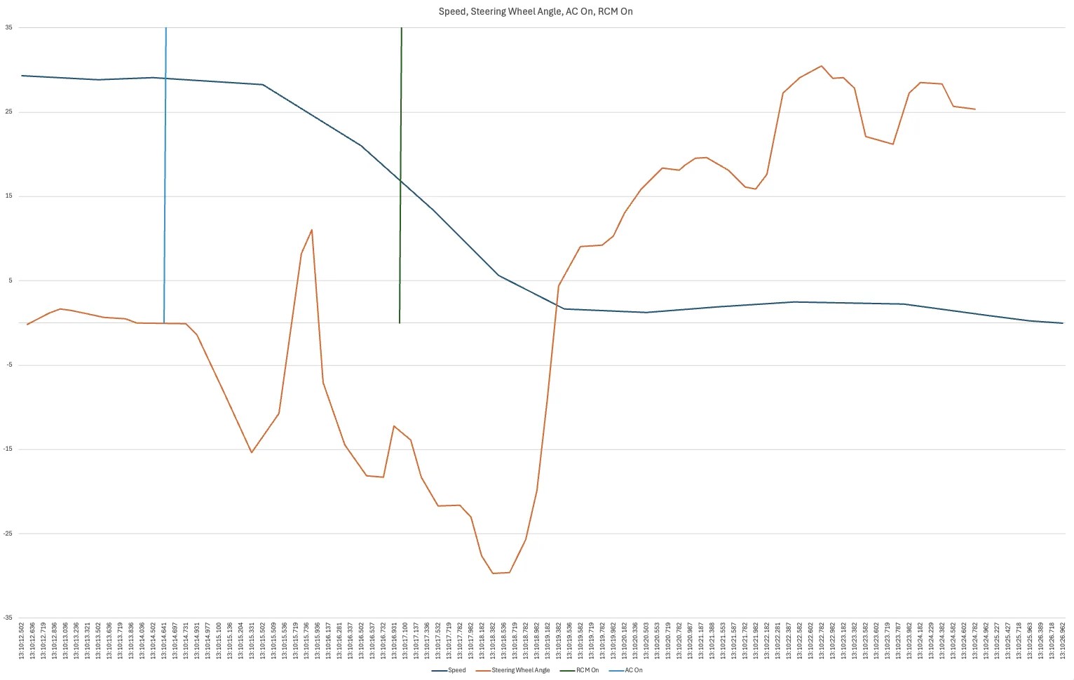

I received my CT back from the service center, but with no clear indication of the root cause.
All items were replaced that were affected by the airbag deploying.
The SC said that all the components were sent to Tesla engineering for them to evaluate.
I requested the vehicle data from Tesla and it confirms what I experienced, that right after engaging the air conditioning system the airbag deployed.
See the image and video below:
- The vertical lines on the graph is where the digital signals triggered and best visualized by giving them large values instead of just the On or Off signal.
- Speed is in kph, Steering wheel angle in degrees with negative values equaling turning right.
- I'm not sure why the "RCM warning light status" is delayed by around 2 seconds.
- You can see the forward facing camera vibrate when the airbag goes off in the video.
I have driven it around 1400 miles since receiving it back with no issues.
p.s. - the Littleton, CO service center was excellent in their handling of the situation and for accommodating my needs. They have been the best SC I've encountered so far.
