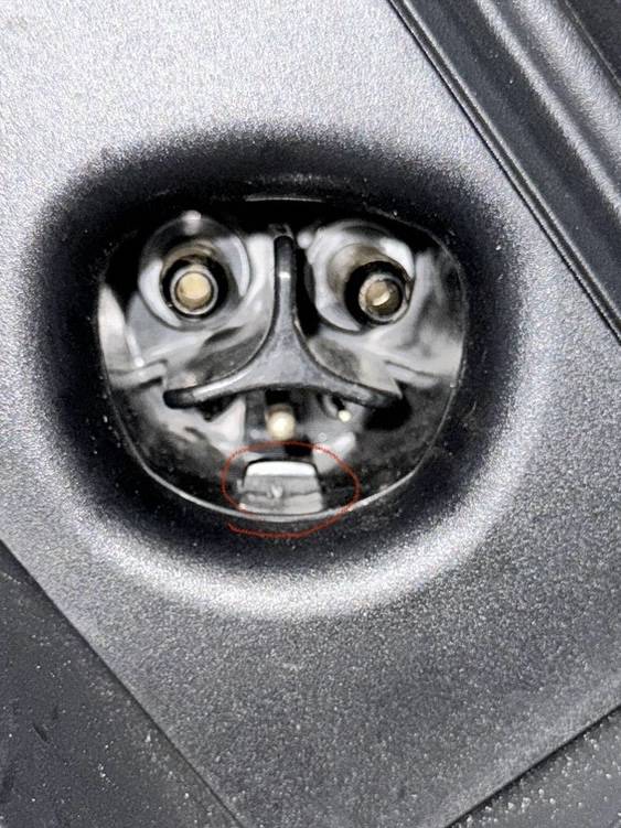

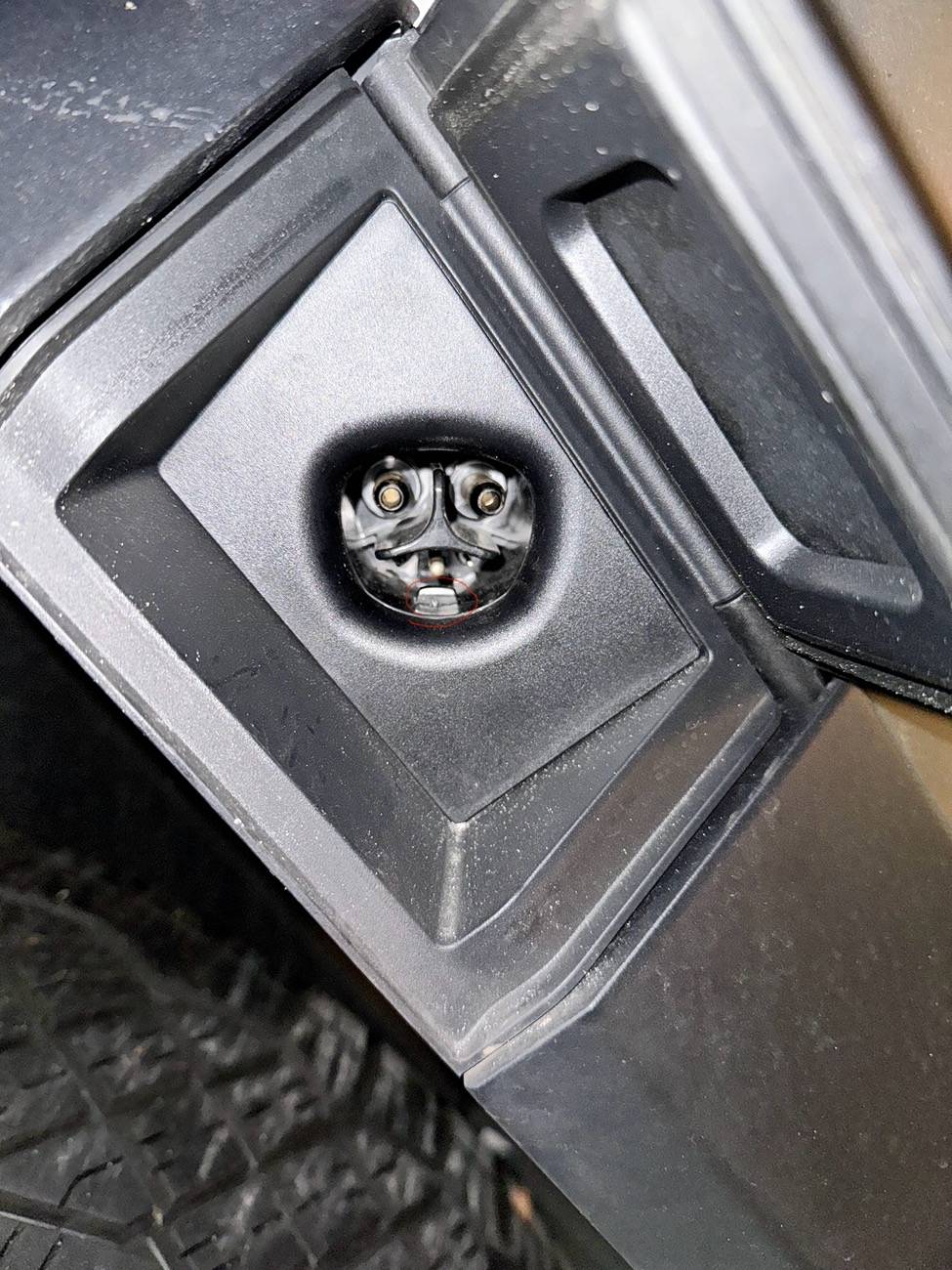

10,313
34,184
The impact damage seems mostly cosmetic. Airbag deployment blows the pyro fuses which disables the pack, but replacement is straightforward. Heck, just replacing the pyro fuses would likely make it driveable, albeit with multiple alerts about the deployed airbags etc.
Pyro Fuses R&R
You can't charge the HV pack without the pyro fuses. IDK if being plugged-in will keep the MV battery charged, or how to charge it from an external source, so perhaps you should disconnect it to keep it from draining further while you await repair.
Disconnect MV Power
Once the MV power is disconnected you'll need to leave the frunk open. If the MV battery is already dead then you'll need to "jump-start" to gain entry.
Jump-Start Procedure
That looks totally fixable, but just the airbag and pyro fuse replacements will be several thousand dollars. The damaged exterior trim is easy to replace, but the stainless panels will be pricey.
