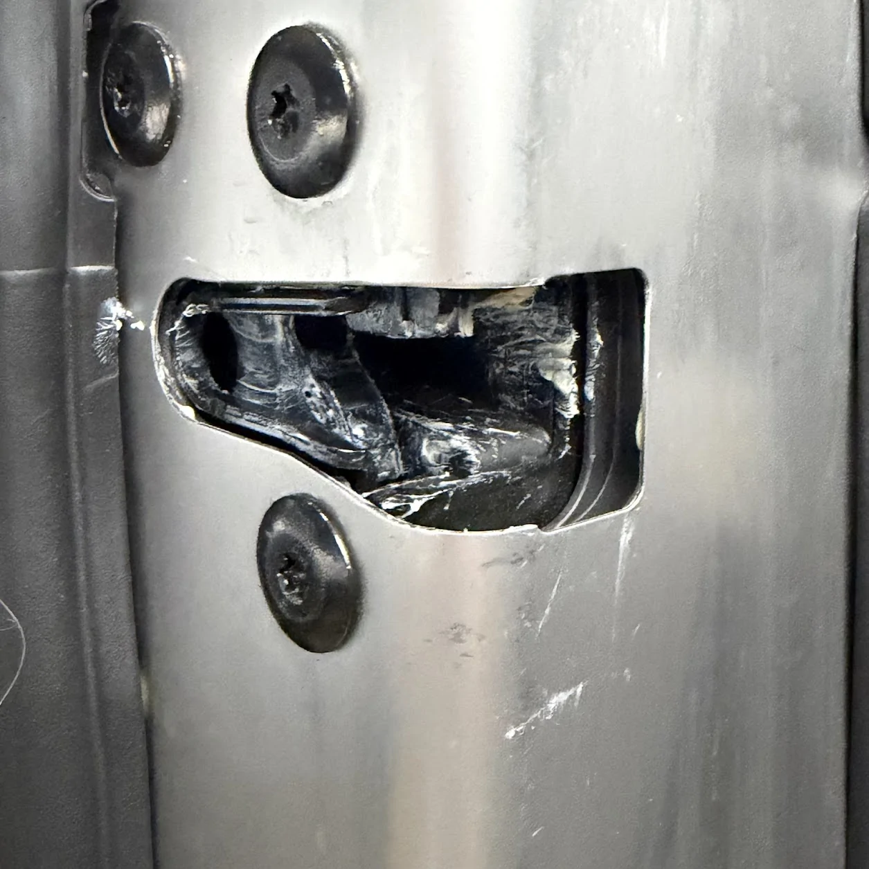

We do/did. The SC 'fixed' it by putting gobs of grease on the closure latches. It did actually seem to help, the other rattle/squeak was coming from the mirror, that was fixed by (re)applying some felt between the mirror and door.

Mine squeaks drivers side only as you swing open door. Swing back and forth it squeaks. Very annoying. Not obvious where coming from to fix. Gobs of grease on latch is not the fix. As it’s not where sound comes from.

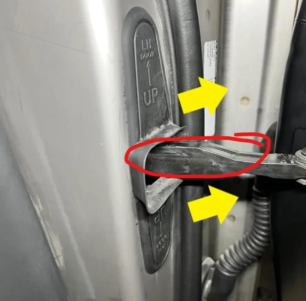

My drivers side door squeaks as well. I'm gonna try to apply grease as @AO-Pete mentioned earlier in this post to this part (circled) of the door, which is where the squeaks are coming from on my truck.

Yeah I tried that didn't work. Let me know if it does for you.
I didn't think it was either, and god knows I'm unimpressed with the FW service center, but it solved the problem for us. Worth a shot. The headliner trim was also loose in ours, it wasn't making any noise, just bugged me that the drivers side was clearly lower than the passenger side when you feel along the leading edge, no doubt a bent trim clip somewhere.
