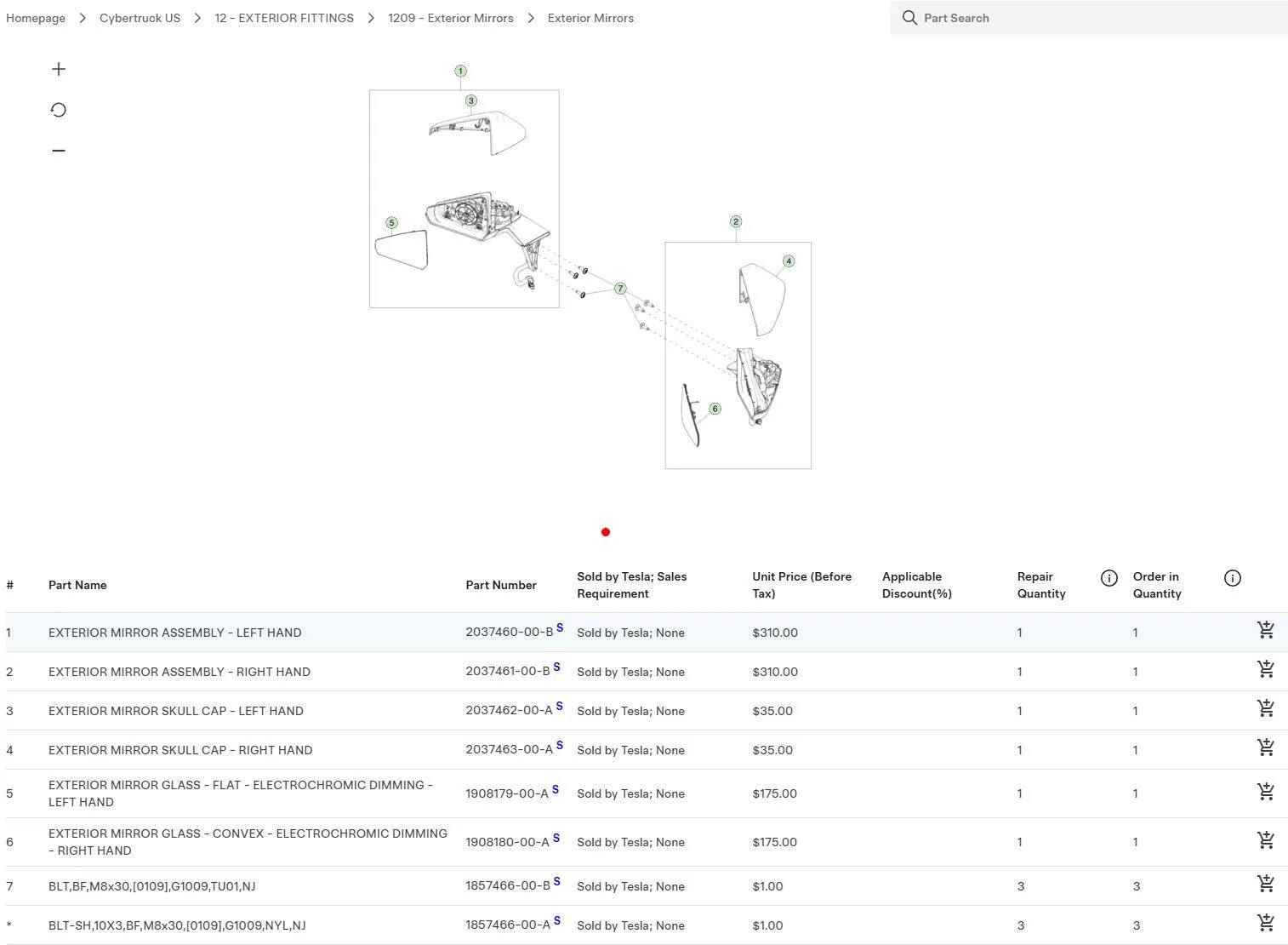

Here's all the prices. Just send a message to your SC for them to order-in, no reason at all to pay for labor, it's just 3 bolts and a wire connector, loads of videos out there show how to remove.
How do you get to this site that shows you the prices?

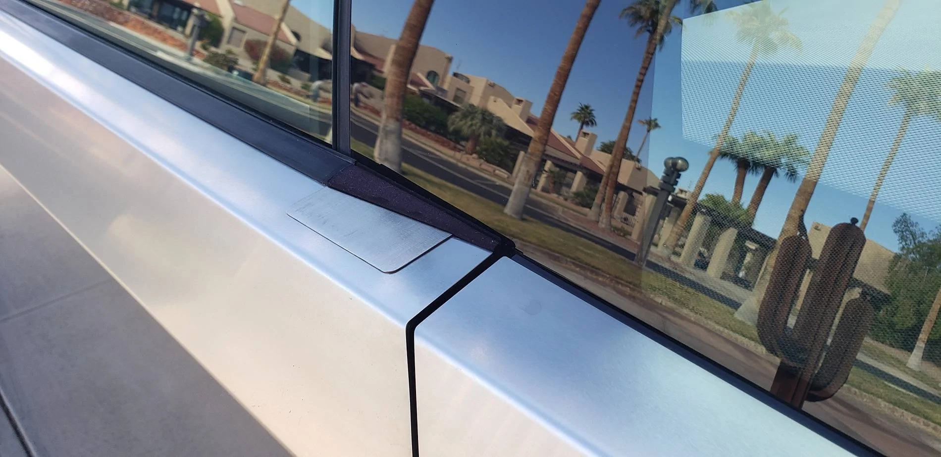

I have a narrow garage. Within a week or two of delivery I struck the driver's side mirror on the garage door frame breaking the plastic enclosure. Rather than spending $500+ to have it repaired, I chose to delete both side mirrors. It's now so much easier to park the truck in the garage, and walking between the CT and my Model Y without the mirror in the way is nice. I chose TickTock's design for 3-D printed stainless steel blanks and plastic trim pieces to fill the holes where the mirrors were attached. It cost $98 for two sets of polished surface blanks and trim pieces from IN3DTEC.com.
Thank you…. Working on separating the glass now but I did speak to the service center and they stated they don’t sell individual parts it’s the whole assembly.
10,426
20,964
My experience has been they will sell you any part that has its own part number in the parts catalogue, that's how all auto parts work.

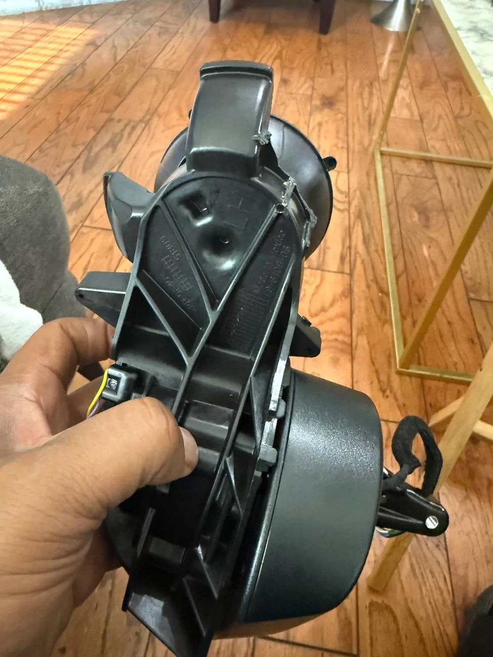

Does anyone know how to separate the motor from the arm? If I can do that, I may have found another option.
