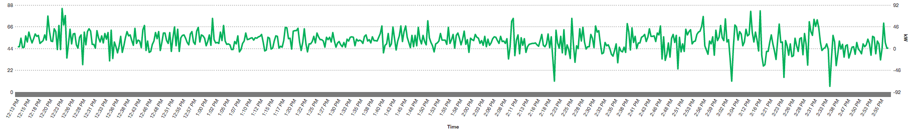

Regen recaptures the mass related energies that is the inertial (0.5*m*v*v) and gravitational (m*g*v*grade) loads. How much you recover depends, thus, on the size of these loads. If you smoothly accelerate to 70 mph and drive for hours at that constant speed on level ground then your biggest load will be the drag load. The inertial load will be relatively small and regen doesn't buy you much. If, conversely, you are driving in stop and go traffic or on a winding road in hilly terrain both the inertial and gravitational loads will swamp the drag load and regen can extend your range appreciably (which is, of course, why it is offered). Consider the following picture:
Tesla Cybertruck Driving the Cybertruck Untitled 2
Probably hard to read but the first part of the drive was on busy highway (NJ Rte 17) then onto the NY Thruway and then the last third crossing hilly Vermont. The measurements are of power flowing from (above 0 on the kW scale) or to the battery (below 0). The energy recouped is the proportional to the area between the 0 line and the curve. On Rte 17 the curve dips below the 0 line fairly often as one has to slow for traffic and traffic signals. On the Thruway one doesn't have to do this nearly so often and so there is very little area below 0 and not much recovered. In the hilly terrain, clearly, the power curve spends, relatively, lots more time below the curve and, therefore, quite a lot of energy is recouped under such conditions. I'll note that I have had trips, one of about 22 miles duration, in which all the energy required and then some was recovered. The SoC at the end of the trip was higher than at the beginning.
The amount of range recovered from a given amount of energy recovered has nothing to do with the battery SoC. If I recover 270 Wh I get additional rated range of 1 mile from that whether the battery is at 4% or 84%. Do be aware, however, that if SoC is 90% or more regen is disabled and I will not recover 270 Wh even if going down hill.
The car clearly knows how much energy it has taken from the battery and how much it has put back in. Evidently you can access that info if you tap the CAN bus and know how to interpret the fields. It would be pretty nifty, IMO, if Tesla displayed that info or at least made it available through the API.

Don't forget hilly terrain. As the record in #28 shows that's where the major benefit is obtained.
