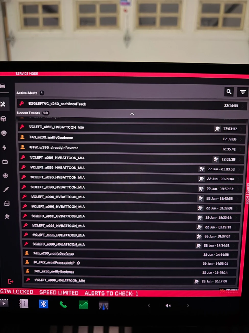

Anyone have a daytime running light failure after PCS replacement? Picked the truck up last Thursday after replacement and didn’t notice the DRL was out. Drove at night for the first time since repair today and realized the DRL was off. Checked service screen and see the attached errors.
Tesla Cybertruck DRL failure after PCS replacement IMG_8665

Mine was fixed with zero issues / alerts present. You should message service in the app likely they give you a fast pass or tell you to bring it back or they do a remote diag / reset something.
When I installed my lightbar per the instructions, I connected the 48v bat in the wrong order and it threw a bunch of errors like those, just did a 2 thumb reset and it went back to normal.

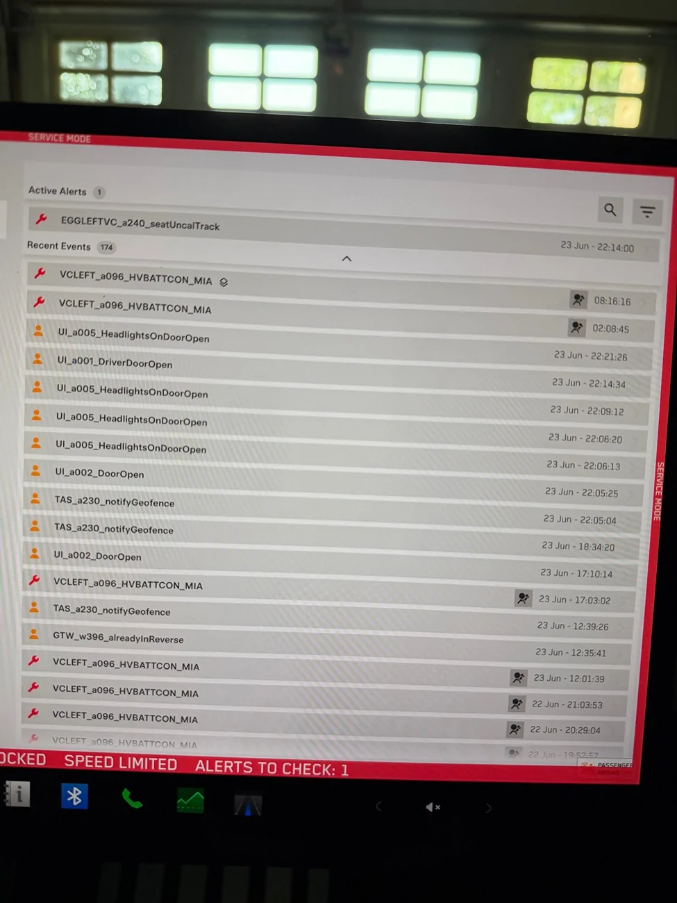

None of those alerts are DRL related, what are the more recent ones?
Have tried doing a dual scroll wheel reset and Power Off?

Thanks. I did a two thumb reset last night and also a full power down. No luck unfortunately. I requested service last night too with a request for mobile service as I live about an hour from the service center. It’s still early but right now the app is showing for me to schedule an on site appointment at the service center with first availability July 9. I plan to call when they open today.

Yup. No luck with reset. Tried last night

Looks like a list of things that popped up when they had the HVATT disconnected. Shouldn't affect anything currently. But, that's just my take.
