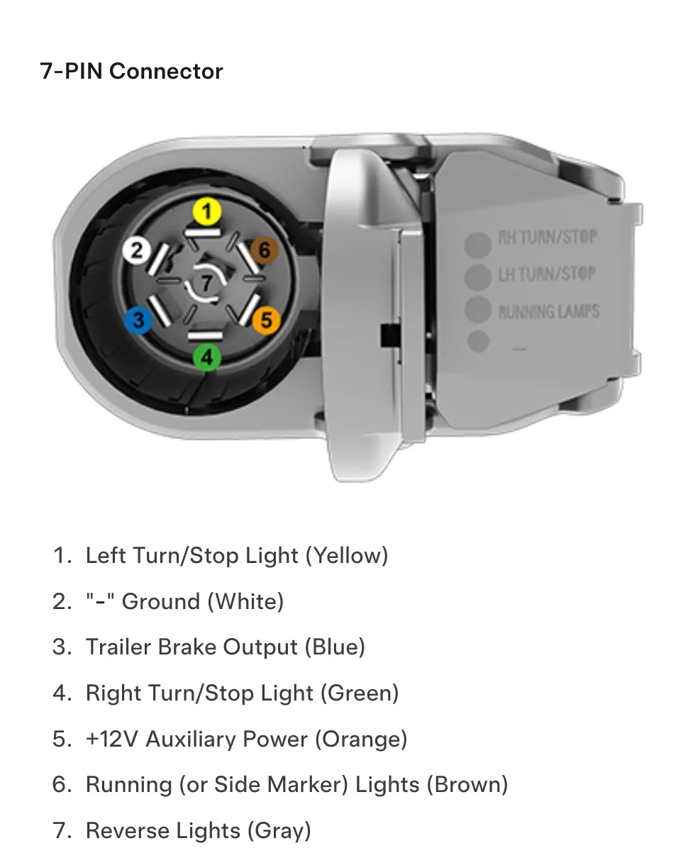

I assume you are using this numbering system for the trailer pinout:

What mode were you in when you took the readings? Was trailer mode on? Was trailer light test on?
I think the values look good if idle and unloaded. Left and right brake should be off (0.6, 0.09), backup off(0.16), running light on (16-22), Aux on (13.44), brake at a low value (11) for detection.
Once the sun rises here I can verify values in my truck, but it should be self protected and hard to actually short.

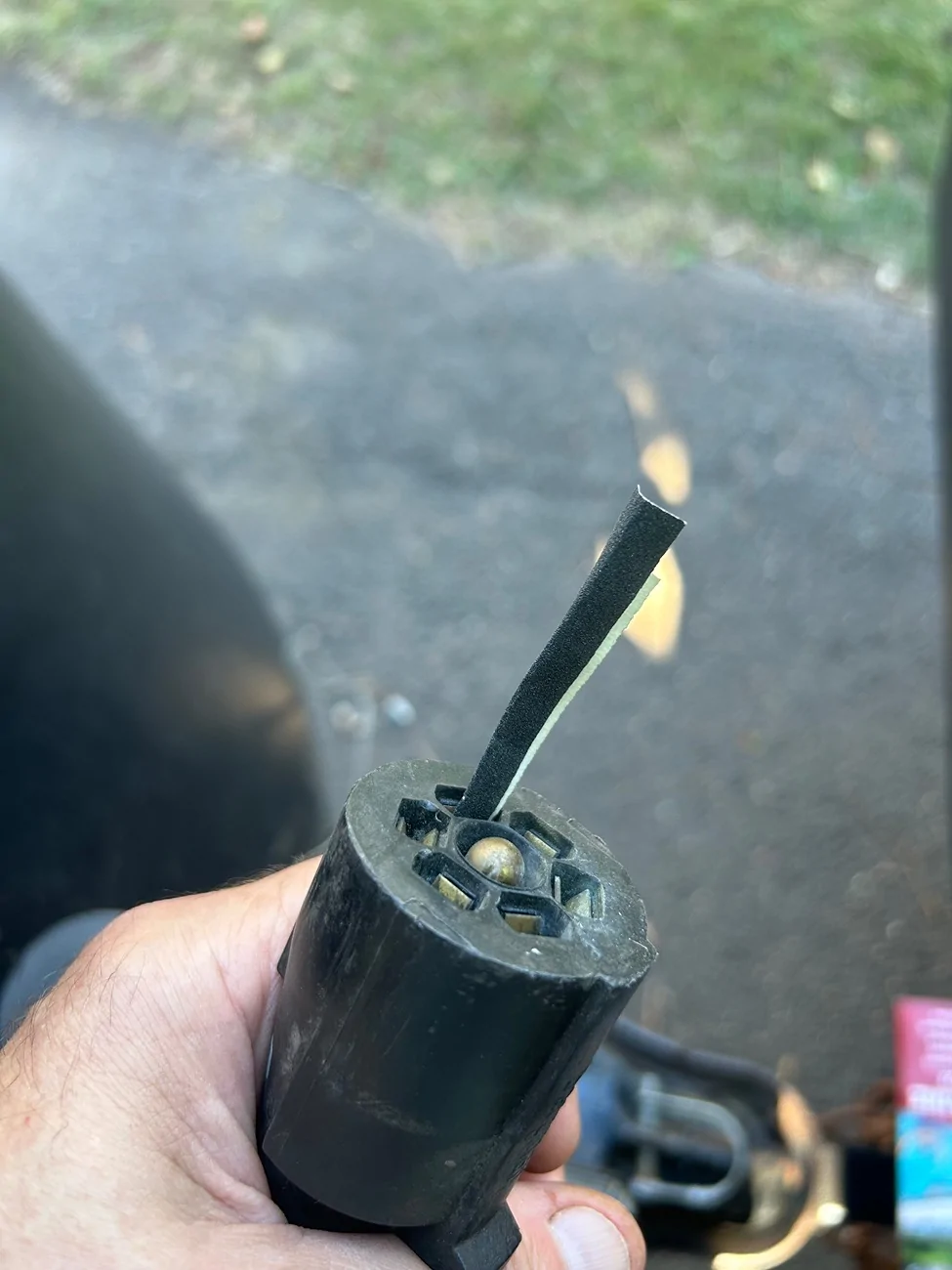

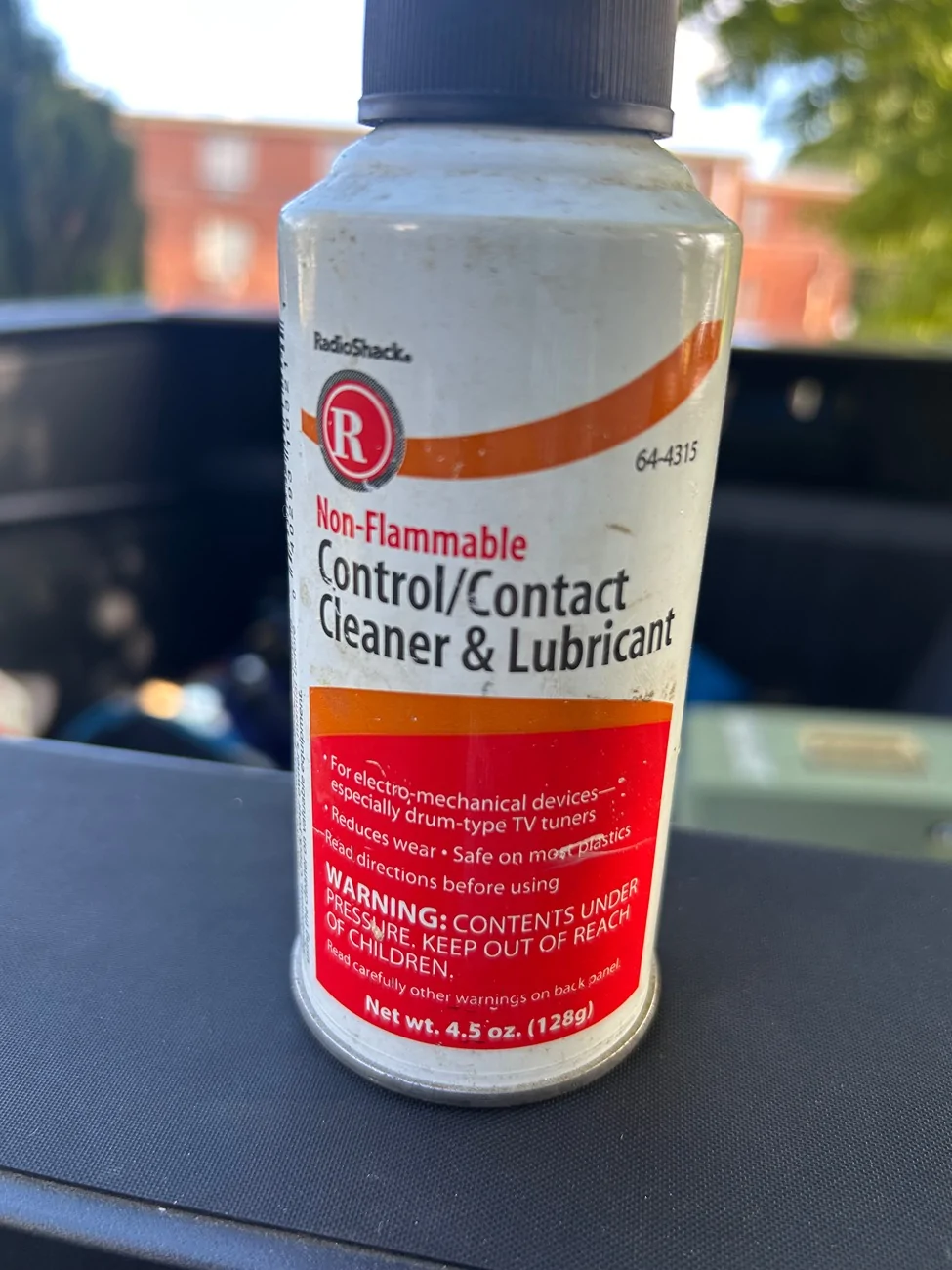

2. Intermittent fault notifications suspected a plug contact issue. Sooo, when I arrived home, I sanded the trailer plug contacts and sprayed contact lubricant.
YES !!! Problem solved. The Cybertruck was perfectly fine, the trailer plug contacts were corroded. Attached are pics of sanding and contact lubricant.
