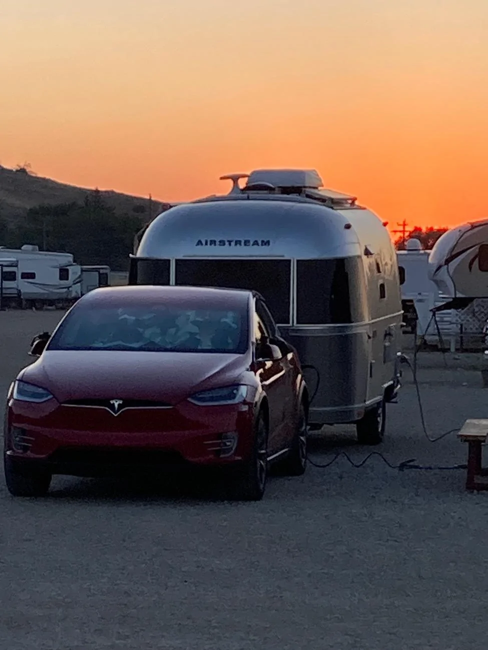

Alert-This is a well-meaning comment based on extensive towing with a 2018 Model X 100D (I have not yet ordered my reserved CT-waiting for the hoped-for price drop) to share some of my learnings to make towing easier. Our vehicle show 265mi of max displayed range after 157k miles (10% reduction).
I have pulled a 16’x9’7”x8’ Airstream Caravel 16RB trailer over 35k miles since 2021. I typically tow to MN to visit friends and family from CA, but have towed to FL and back to CA.
I plan each trip (usually 7-10 days one way) and break down all stops for each day (including distances to and elevations for each charging stop).
I use the App Windy to confirm wind direction and speed to inform planned driving speed (and departure times). At each stop I record efficiency (actual distance/displayed range used to travel each segment). While this approach may sound onerous, it reduces range anxiety and allows me to drive faster when favorable wind conditions are present. I also have a ready to go resource to adapt for each trip.
Now the (more) sobering part..
Since drag increases with the square of speed I typically start each segment at 55mph (max towing speed in CA) and increase some during each segment (or turn in the AC). To illustrate the approximate effect of speed in range - 65mph induces 40% more drag than 55mph and so on.
I have also monitored the benefit in time of traveling faster and have found the time saved is mostly lost from longer charging stop times due to lower efficiency (especially with 150kW chargers).
I hope this information is helpful. My motto is: it is not easy (towing), but it is gratifying! ???

With that setup, what is the wh/mile?
Varies significantly based on wind direction, speed, AC usage, elevation change. Anywhere from 500 to 800 wh/mile+/-. Efficiency of displayed range is generally around 45-55%, but can go down to 35% (e.g., if 260 miles of range displayed at start, actual range can be anywhere between 90 and 130 miles+/-).
