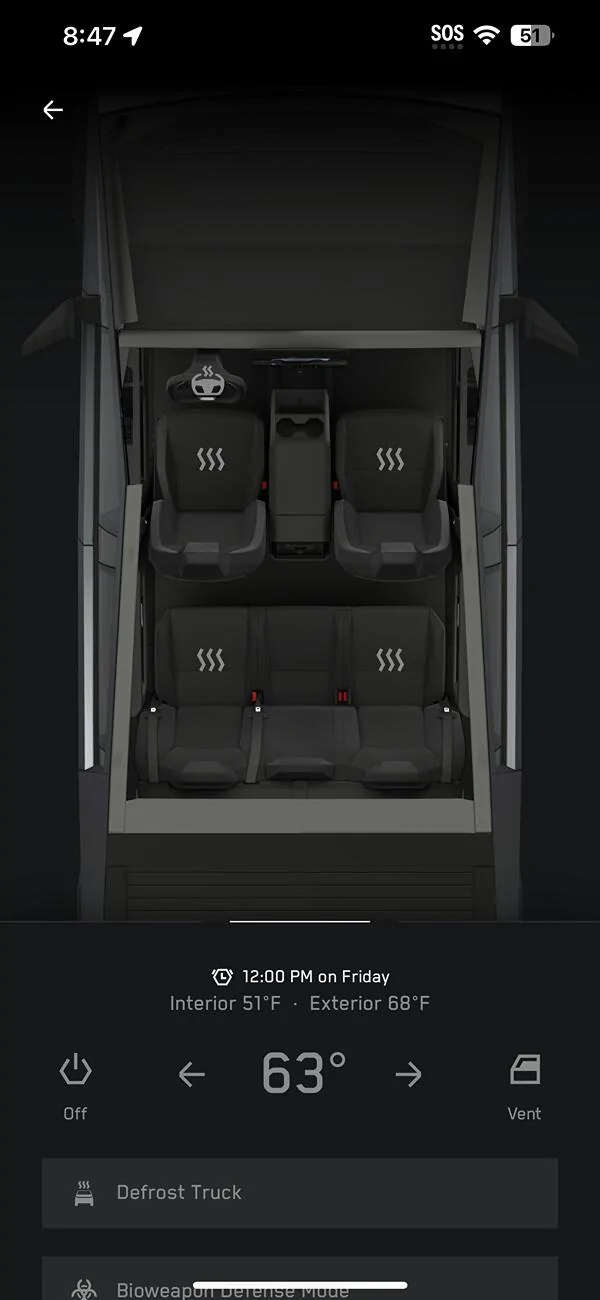

scheduled departure- I set my departure to every day (day tiles) when I’m home (location at top) to finish at a time before low electricity rate jumps in price.

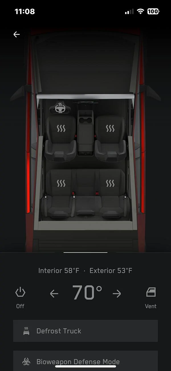

Select Climate and select Defrost Car- that will warm the pack with energy from your charger when plugged in or your pack when not.
even if none of those are done, driving will warm the pack. Honestly your range isn’t lost it’s just unavailable at the moment. Countless members have brought this element up. However range will be lost (compared to summer driving) warming the air in your cabin… seat heater use and setting cabin temp to a lower than normal temp will help mitigate this effect.
using the seat heaters and cabin 70 instead of setting the cabin to something hot like 78 was a technique that I used in the old resistive heater model 3 - that worked well to not bleed energy crazy style when on a cold weather drive

My preference is 71 in the truck. But I know some folks will use the heater like in ICE car heater - that will smoke your range big time but really just skyrocket your energy consumption.
How I do temp in the cold though depends on if I’m trying to stretch my range and get back on planned arrival SoC
