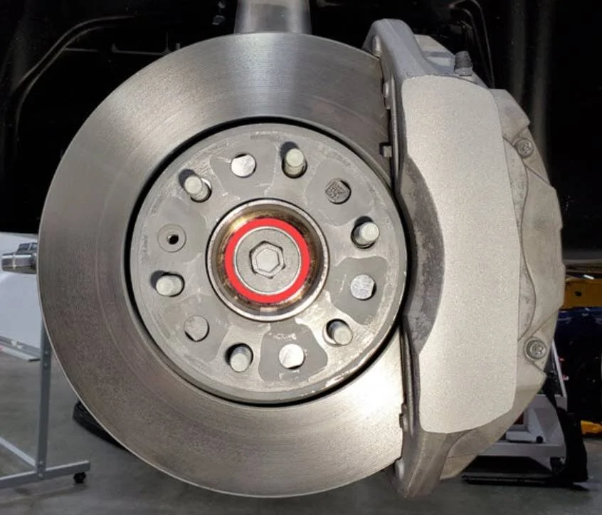

I think this icon is a carryover from the power display on some of the first models. For example our X the way it displays regen or power being delivered is with an energy graph that is round. When regen is limited it is represented with dashes in the bottom of the regen graph. It is a little difficult to see but the power meter on the Cybertruck (other models that have the meter as well) will also so dashed lines when regen is limited (would be at the red arrow in the below pic) I assume they added the green icon to make it more apparent so people are more careful. Once you get use to the distance needed to stop with only regen as soon as that is reduced it can surprise you that physical brakes are needed for the same stop you have made hundreds of times with only regen.
Model X energy graph:
Cybertruck power meter:
Interesting, I was thinking the dotted part was the dust shield, but that isn't visible from the outside of the assembly. So it could be showing a limited regen power graph with a disk brake shape. (Standard icons use drum brake looking things ?)
Yeah it totally could be! I don’t known for sure, just what I always thought it was. ??‍♂
I think it's both (and being a graph explains why it's green). Like this image, you can see either though it may depend on if Cybertruck is your first Tesla...
